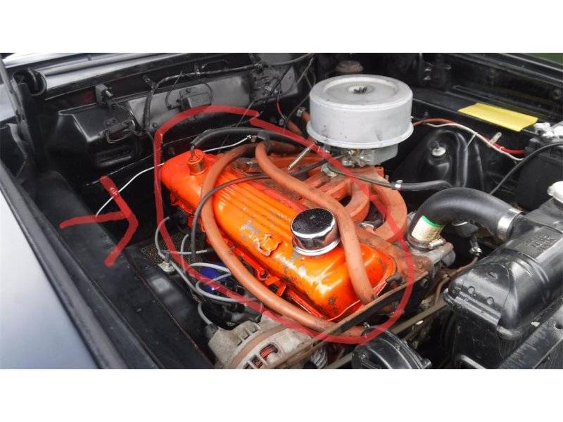

Sorry I meant the gasket for this. Bit of a noob.
