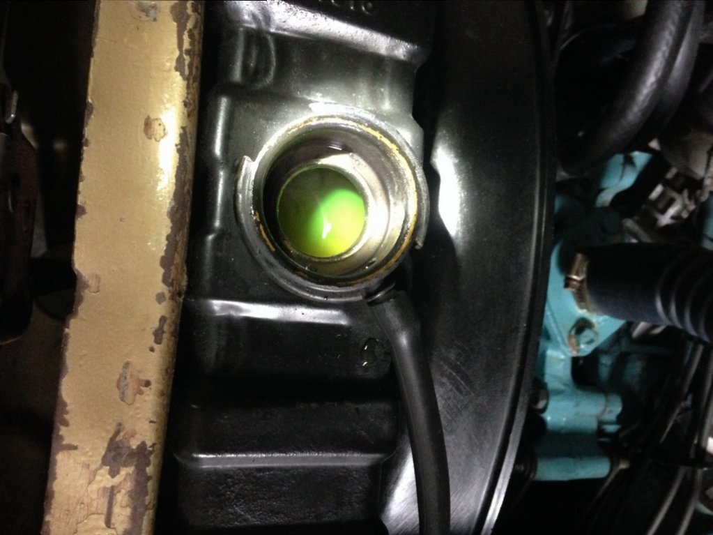

I checked the coolant this morning and it does not seem to be loosing any. I pulled the filler cap and there was a small amount of water droplets on the inside. It did not look gummy like some of the pics I have seen online, but there was a small film along with the water droplets.

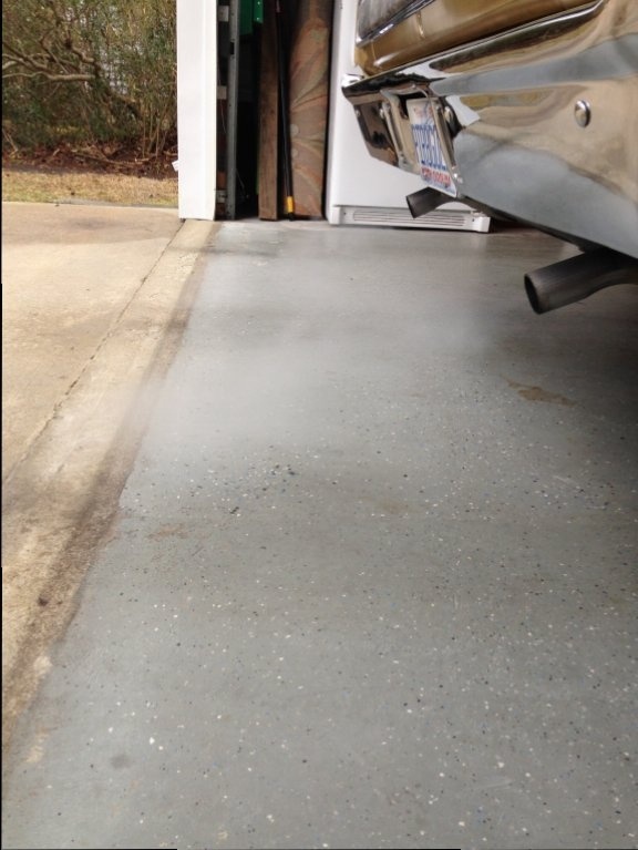

Pic of the smoke
Looks normal to me.You say the "smoking" is gone when it's at operating temp? It's fine!!

Looks fine to me, that actually just looks like steam. I wouldn't worry.

I think just from being cool . a little condensation builds up mine dose that to and that's what I think it is

Looks like condensation. It would be delayed until the exhaust system gets some temperature. Let it fully warm up, and drive it, if possible.
So if were something like a head gasket it would not go away once it was up to temperature and would still smoke once I got back from a drive, correct?
Def not from head gasket being blown, you can't mistake that cloud ! Looks like condensation, don't lose any sleep over it ....

Basicly, yes. Weather conditions could cause persistent vapor at the tail-pipes....but I'm not seeing anything horrific. By the way....nice sounding idle.
