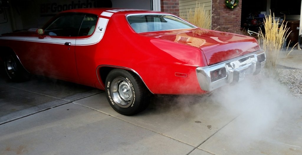

Here's a simple way to troubleshoot any emission from your tailpipe. Smoke is comprised of particles and gases. When it comes out it is hotter than the outside air and will rise and float away. Steam is comprised of water vapor, which immediately dissipates into the outside air as it matches its temperature and unless it's really cold and humid outside, this will happen within seconds. Steam is a natural byproduct of an internal combustion engine and is always present.
Looking at your video, the emission is disappointing almost immediately upon hitting the air. If that were smoke, it would have been filling the area around the back of the car until it drifted away, so that is definitely just steam from the engine heat burning away condensation that's collected in the exhaust.

Just thought I would share for reference a picture of what condensation really looks like when its cold outside.

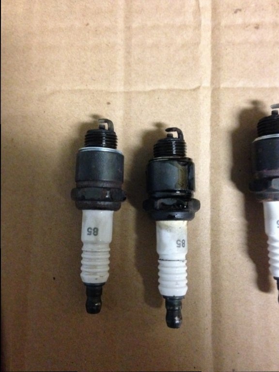

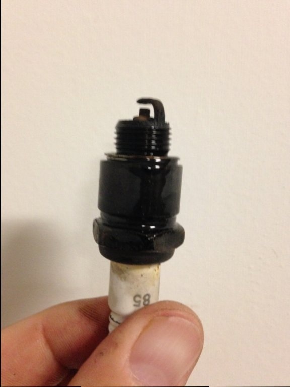

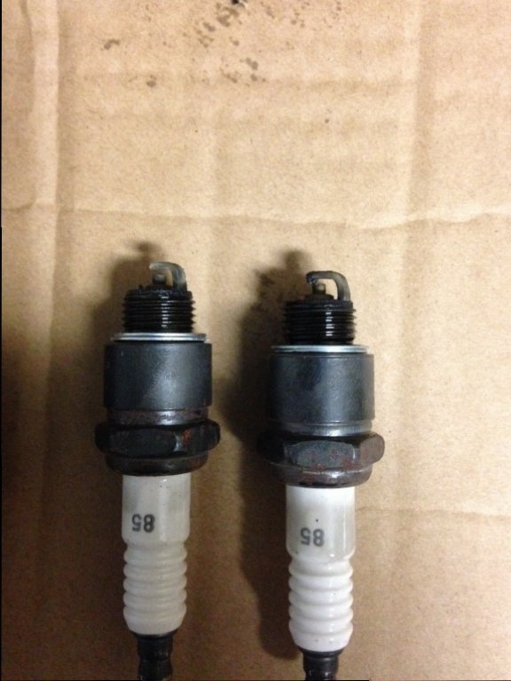

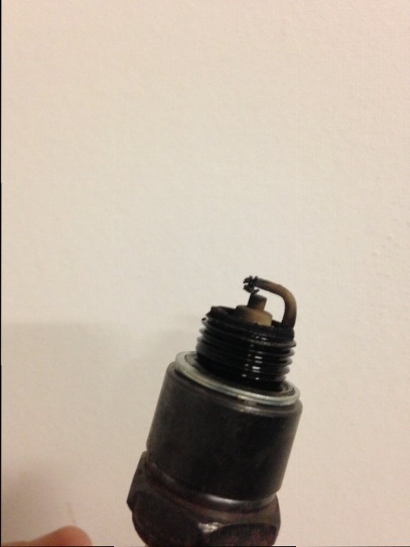

I uploaded with my phone. Back on the computer now so I can give more details. I took pics of the plugs in order from how I pulled them front of the car to the back. Cylinder 2 and 6 look good, but 4 is wet on the top of and down one side of the plug and 8 looks like it might be fusing together. Any input?

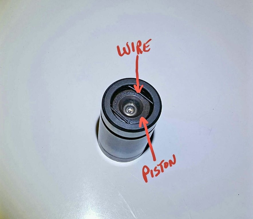

Here's a pic of a hydraulic lifter showing the wire clip that holds the piston or cup, from coming out of the lifter itself.
If the wire is touching the piston, like in the picture, and you have a lot of play in the rocker/pushrod, then either the pushrod is too short or the cam might be wiping. (wearing off prematurely) Rockers can wear also, at the valve stem and in the pushrod pocket. Also it could be a bent pushrod causing the excessive play.
If the piston in the lifter is below the wire, with excessive play in the rocker/pushrod, then the lifter has lost its prime. Either it has leaked down or has dirt in it, keeping it from "pumping up".
Hope that's not too confusing but check this and report back. Don't worry about side to side play, just the gap that would be from the top of the valve to the rocker.
