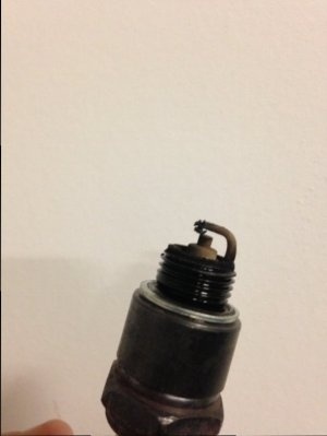

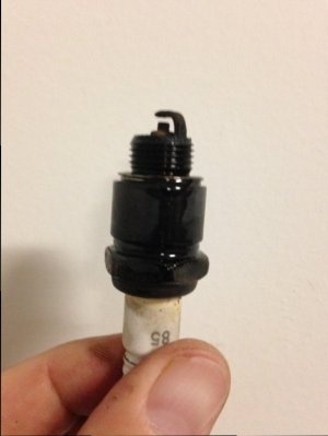

Bruzilla, thanks for the tip. I was reading about Marvel Mystery Oil online as well, and I am thinking that changing to the more viscous oil might have emphasized the ticking. I will pick some up and try that this weekend. I was thinking that with the wet on the one side of the spark plug it might be a valve issue. I also don’t know if #8 was firing because the plug was fusing together. I plan to pick up new plugs and swap them this weekend as well to see if that helps at all.
Looks like there is oil in the plug hole from a leaking valve cover gasket, unless oil ran in there removing the valve cover before you removed the plug.
This one looks like you picked up a chunk of dirt as you removed the plug.

Thanks for the input. The oil was there when I pulled the plug. I did check and it was only on one side of the plug. From what I read, if it is only on one side it's most likely due to a valve leaking? The valve seals are on top under the springs correct? I didn't think to look at them. Will I be able to see them without removing the springs?
Thanks for the tip on the other dirty one. That makes sense. I don't know if it was fused or is debris. I will pull it again and check it out. Can I just try to wipe it clean? What about the oiled plug, just wipe clean, or replace?

You can clean your plugs off with parts cleaner or carb cleaner. Never use anything abrasive on the porcelain. Scratching it will cause the plug to short out.

The oiled plug looks like it became wet from the outside, like a leaking valve cover gasket allowed oil to run into that plug area. If there was oil only on the electrode part of the plug and it has become wet, then the valve seal might be bad on one of the two valves for that cylinder.
If that's the case, valve seals can be replaced without taking off the heads, but it requires a good air compressor and a couple of specialty tools. I wouldn't worry about it right now.
If that's the case, valve seals can be replaced without taking off the heads, but it requires a good air compressor and a couple of specialty tools. I wouldn't worry about right it now.
