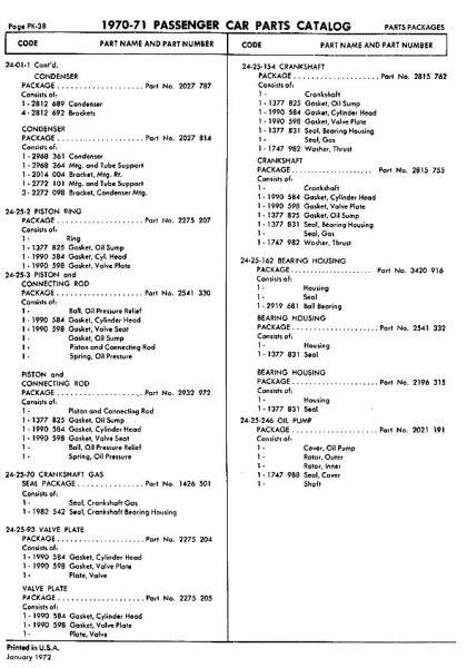

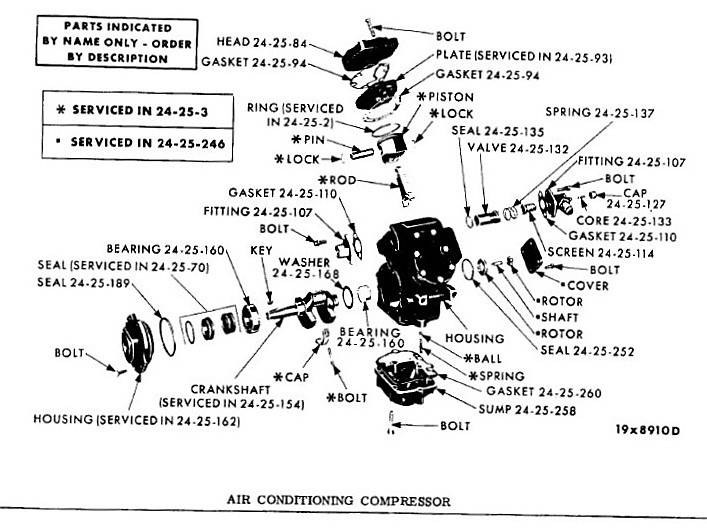

From the parts manual:
AC Part packages from section PK
Compressor exploded view from Section 24 "AC" - you'd have to look up each individual item-type's part number(s) in the sections parts listing. It's multiple pages, so I didn't extract.
After poking around on the web today for a rebuild gasket kit it looks like somewhat slim pickings. Classic Ind. used to have a gasket set and a shaft seal set but no longer available. Looking in the parts manual and what I've seen posted, this is what I see as rebuild parts. What would be the most common ones to obtain for a generic rebuild? Presuming the crank package would have most of the gaskets?
Piston Package 2541330, one piston, one sump Gasket, one head Gasket and one valve plate gasket
Crankshaft Package 2815755, crankshaft, two head gaskets, two valve plate gaskets, sump gasket and front seal.
Front Bearing 2019681
Rear Bearing 1984152
Oil Pump Package 2021191
2275205 and 2252204 Reed Valve Plate
