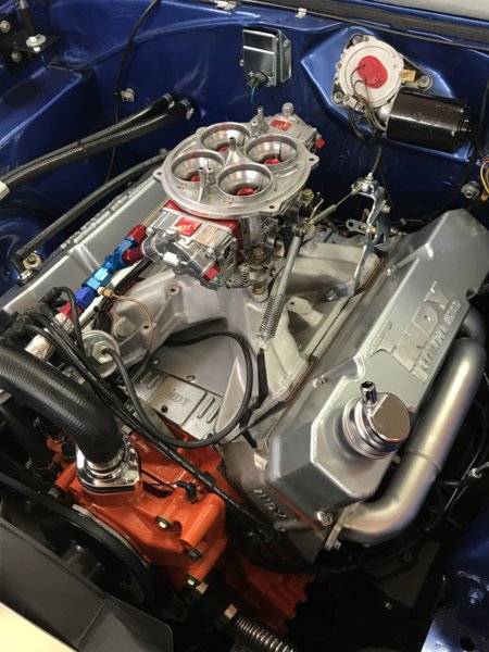

Tex...Nothing wrong with the 4500 to 4150 adapter. I used the TransDapt "open adapter" when I replaced my 850 Demon with my Holley Dominator (part # 80688, $799@ Summit) and picked up 3/10s of a second with NO other changes. I then replaced the open TransDapt 4150 to 4500 adapter with a "HVH" Super Sucker 4150 to 4500 tapered adapter and with that adapter I picked up another .021 in ET. (That .021 better ET ALL came between the 1000' foot mark and the 1320' foot finish line.)
I now do have an INDY Max Wedge Dominator Intake with my Dominator and it is (and has always been) OTB Jetting. I ran it like that until just this very last race (March Meet, last month). The OTB jetting was 84 primary with a 5.5 primary power valve and a 94 secondary (no power valve in secondary, of course). At this last race I merely removed the 5.5 power valve in the primary side and increased the primary jet from 84 to 92, no other changes. It made NO difference in ET, but I don't have to now worry about the power valve failing. I will probably increase the primary jet from 92 to a 94 to "square them up" as they say.
I do NOT have a AFR meter but the jetting must be close for me to run 10.158 @ 131+ with my 3800 pound sled.
Plugs look "normal" at the end of a run....no signs of detonation or anything melting down, lol.
Hope all this info helps.

One of these days I need to try a Dominator and a single plane intake. But I will say the 850 and dual plane Indy intake have very nice driveability driving on the street which is what I do the most. But the 850 keeps wanting a lot of jet. Do any of you guys that run Dominators drive them on the street much and if so how do you like it on the street ? Ron
Hey Ron , good to see you around . My car is my daily , only went dominator 3 weeks ago , still fine tuning . Should be happier when new Suoer Victor
goes on . Adapter and M1 single plane seem a bit mixed up
Tex

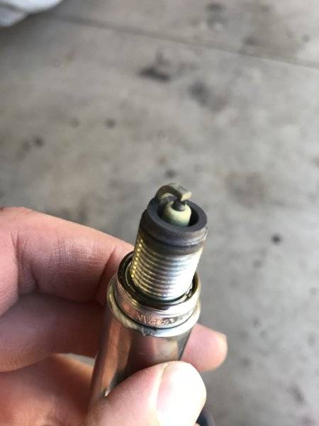

My dominator actually runs pretty sweet on the street. Not by accident though. I have the cruise leaned out and in the 14.s. Gonna be hard to take this one off.
I put about 50 miles on my dominator yesterday Plugs look just as good as the 4150. These plugs do have about a years worth of run time on them.
Ron, Put on a Dominator and a Single Plane. It will be fine on the street. Leave the power valve in the primary for street use.
I agree Mike as I run a primary Power/Valve in my 850 as I like to run one in my street car. If it was a race only car I would block it off. One day I hope to try a single plane and a Dominator. Ron
