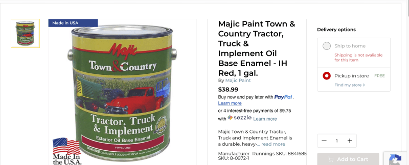

Paint your Z with this implement paint. It's made by Sherwin Williams. I painted this car with it and 30 years later, it still buffs out. It needs buffing every year, but I put it on thick so I haven't burned through yet. I used automotive reducer, but no catalyst, though they sell both with the paint.
With red, yellow, blue, black, and white, any color and shade can be made. Ih Red, Ford Dark Blue, and JD Yellow are great base colors to make pretty much any color. I would like to see the label of a Sublime Green paint can label to see if I might make it with tractor paint.
