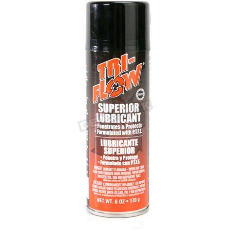

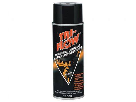

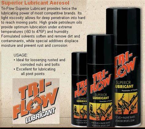

No offense but I wouldn’t use white lithium grease unless you want them permanently cemented shut in a few years. That stuff sits up like day-old oatmeal in a cooking pan after a year or so. I’ve banished that crap from my garage forever - spent far too many hours scraping and wire brushing that crap off of window tracks, regulators, door latches, etc. I just used Tri-Flow lubricant and Lucas red grease sparingly on the slides and rollers on mine and the are working much better.
66 and 67 non chargers have completely different mechanisms on the quarter windows. 66 is complicated, 67 is more simple.
Leave it in the car, clean it with brake clean. Make sure all the rollers are moving and not frozen. Use a good spray lubricant, I like Tri-flow. 56 years of old grease and dirt doesn’t help the operation.
White lithium grease in a spray can is terrible, it sets up hard. Try to remove it, lots of luck.
White lithium in a tube doesn’t seem to do that.
