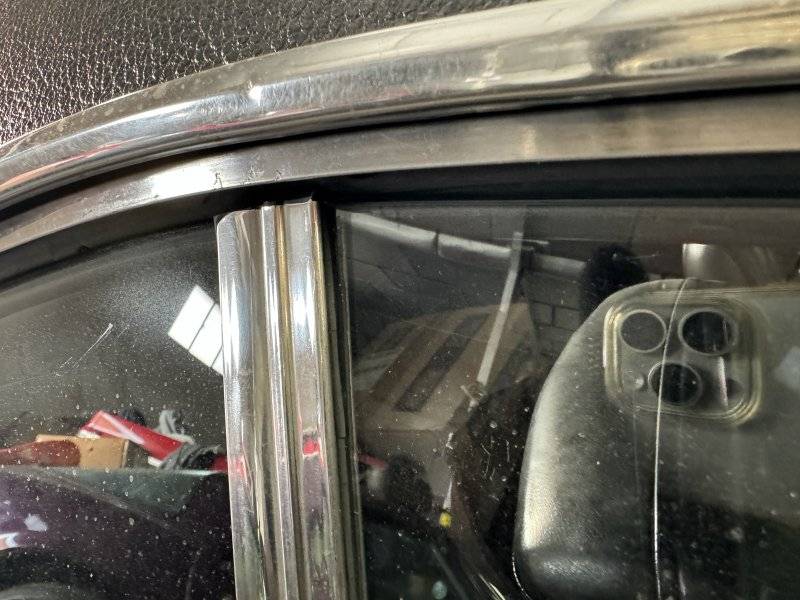

The drivers window dont adjust well and the water come inside

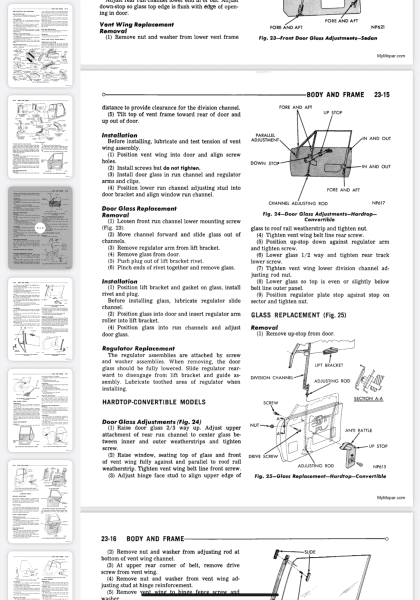

I think that have screws behind the door panel right ??

Its the marked with “in and out” right??
Its needs adjustment in the top of the window, because its turned to outside…
You need to loosen the bottom A frame nut and the two bolts on the back end of the door AND the two small nuts on the front end of the door. This will allow you to tip the window in.
