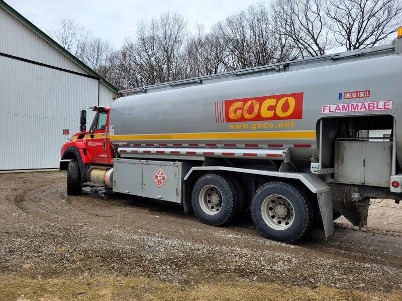

Access to 100LL, let me know where it's cheaper than that Premium ! Lake Simcoe Regional is currently selling theirs at $2.80/l. I had my 2200 liter tank filled just over a week ago and it cost me almost double what it did a year ago. All in was $2.50/l, just over 5 grand to fill my tank. It went up another 12 cents in the past week.
