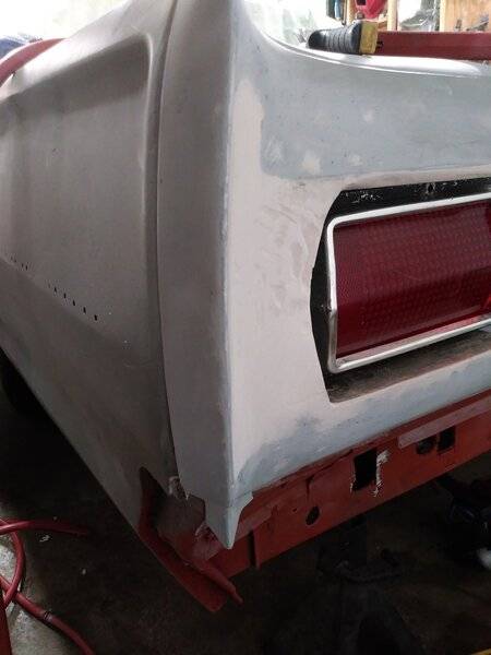

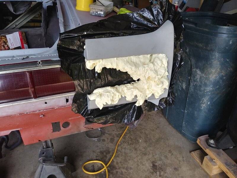

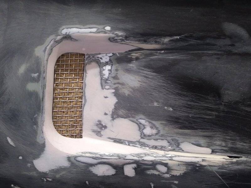

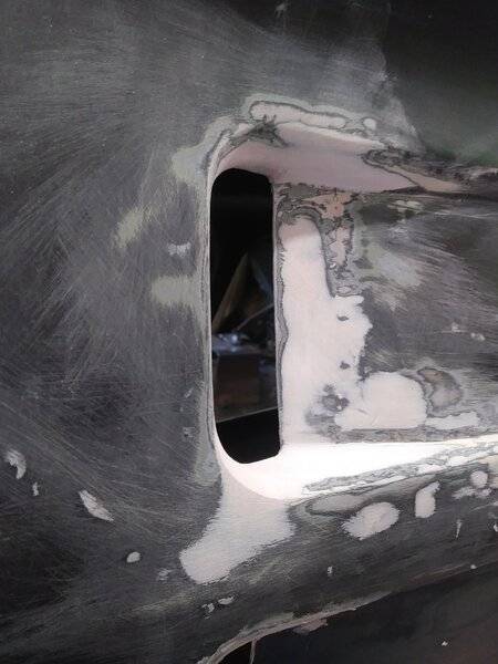

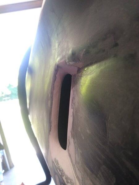

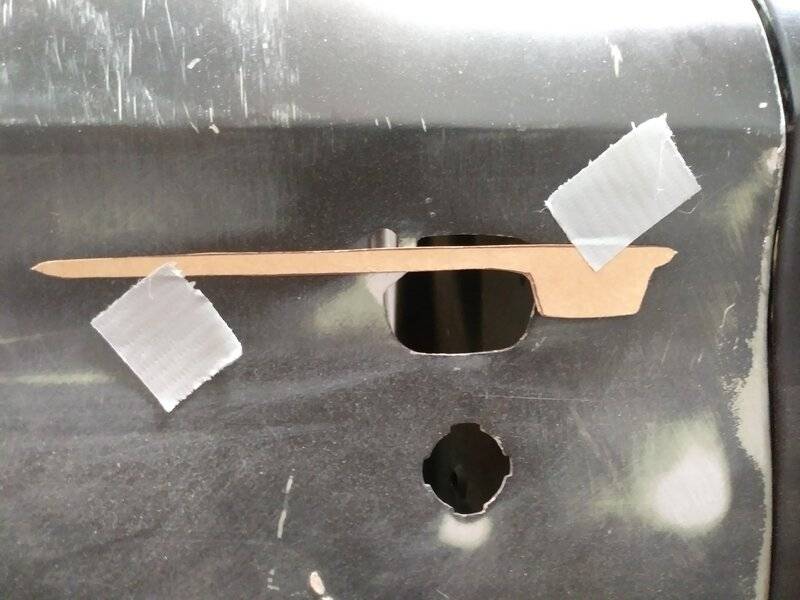

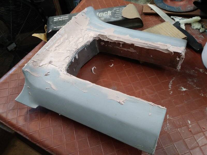

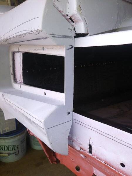

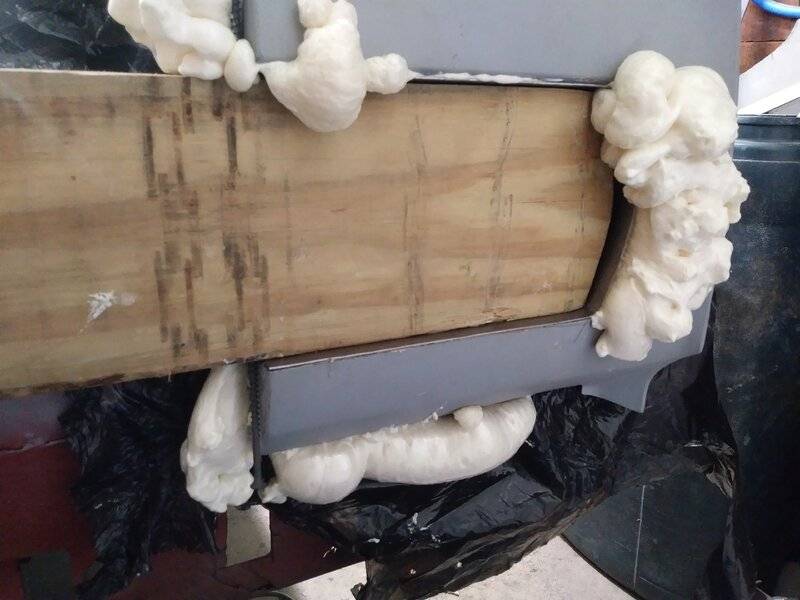

Moved on to the side scoops today because I had an idea of how to accomplish getting the filler to go where I wanted/ needed it to. I placed a rectangle of hard plastic inside the quarter against the back of the opening and wedged it in place by putting a big sponge against it and the inner panel. Then I went to the outside and put the filler on. Let it dry to about 80% and the plastic peels right off the back leaving a flat surface to apply the Stainless Steel mesh to. Then carved and sanded the opening to my satisfaction. It's ready for final sanding and touch up but I got the outline and edge contours where I wanted them. So, that worked and now I can do the rest of them the same way. I have been contemplating this for months. off and on. Finally figured out how. lol.
