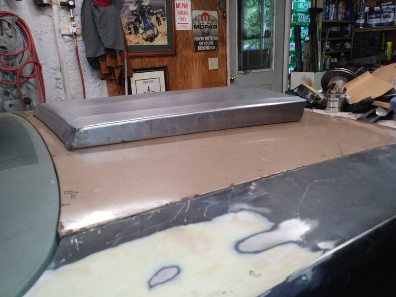

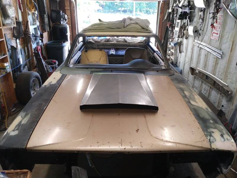

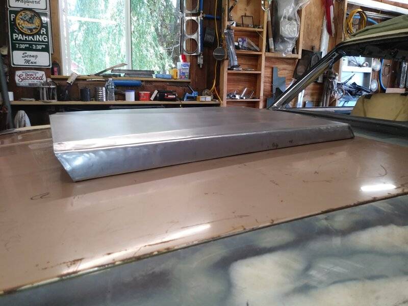

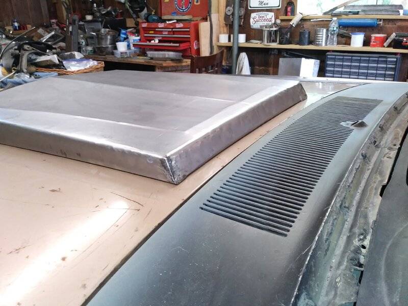

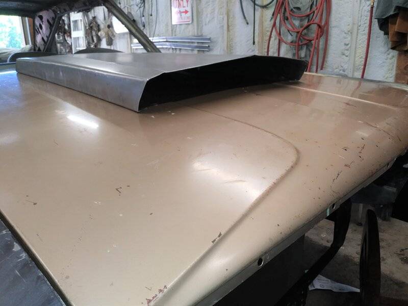

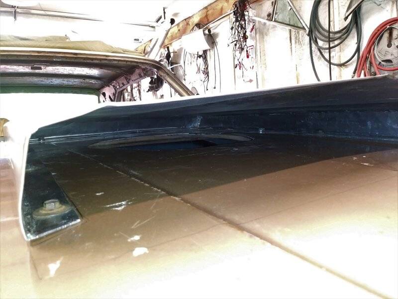

it IS bolted on now. Thanks!It looks great!! Will it bolt on or plug weld it with hole in the hood and welded to the flange on the scoop
Thanks. I wish I had thought of that when I was bending it up. It would look 'righter' if they were, I agree...lol.Looks great wish I could make one similar. I do a small radius on corners and sides at slight angle, but that's me. You've got some serious talent.
If I had the proper tools and equipment it would be a snap..Thanks. I wish I had thought of that when I was bending it up. It would look 'righter' if they were, I agree...lol.

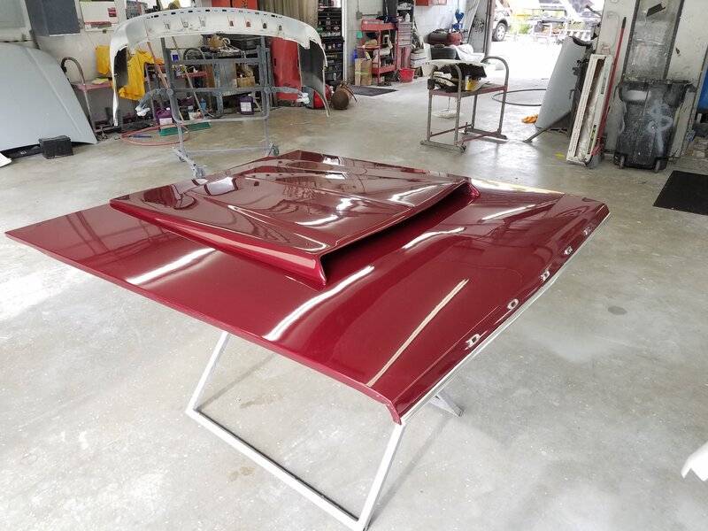

I think it would bring you problems later on with paint chipping off the filler or caulk. Paint both hood,scoop and the bottom of the scoop, then mount the scoop back down. Trim the hole in the hood after painting with this.Is there a "caulk/filler/ paste" type stuff to put in-between the hood skin and the outside bottom edge of the scoop? That can get painted over?
You read my mind! i was just now thinking about this very thing.I think it would bring you problems later on with paint chipping off the filler or caulk. Paint both hood,scoop and the bottom of the scoop, then mount the scoop back down. Trim the hole in the hood after painting with this.

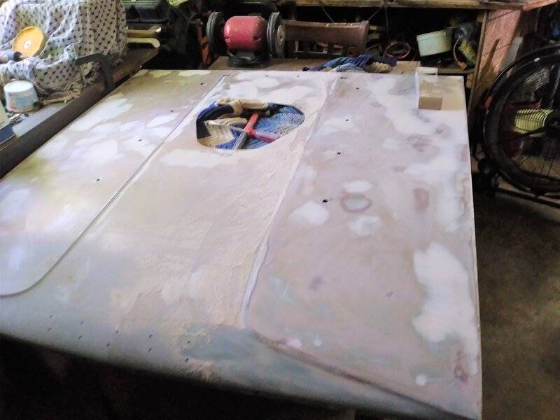

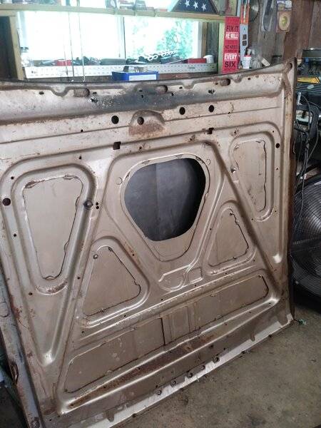

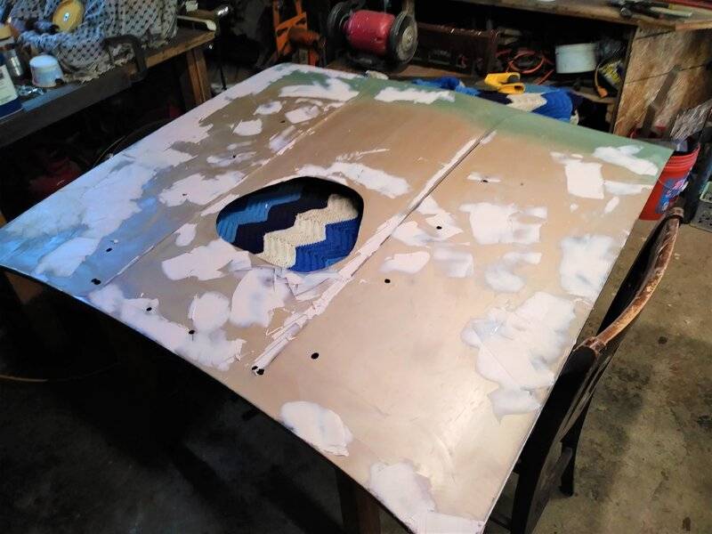

Looks great, well done!! It's fun to watch you and I can't wait to see this machine storming down the road, you are the storm!!!Sanded down the rough spots and gouges/ scrapes dents and applied filler. Underside is finished with metal work/ filler and ready to take 1st coat of epoxy primer.
View attachment 986913 View attachment 986914 View attachment 986915 View attachment 986916 View attachment 986917
You and me both pal....you and me both.Looks great, well done!! It's fun to watch you and I can't wait to see this machine storming down the road, you are the storm!!!

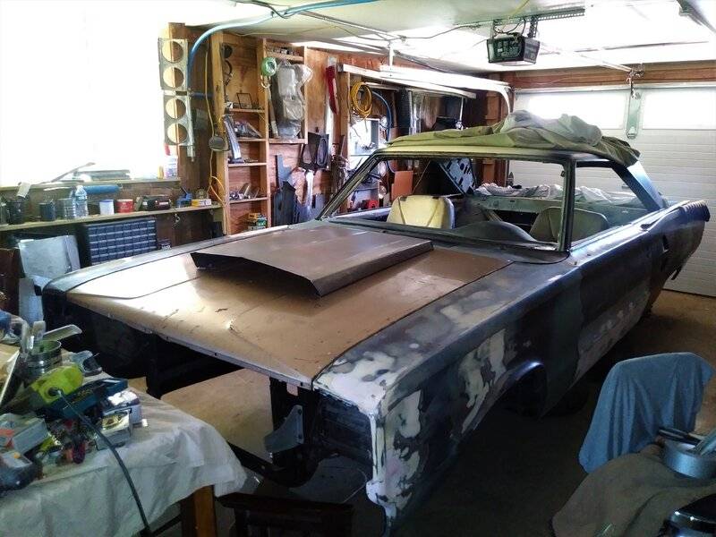

Looks really good Ghost! Love the paint pallet too!I'm going to leave it set there in place for awhile and see if it grows on me.![]()
