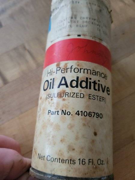

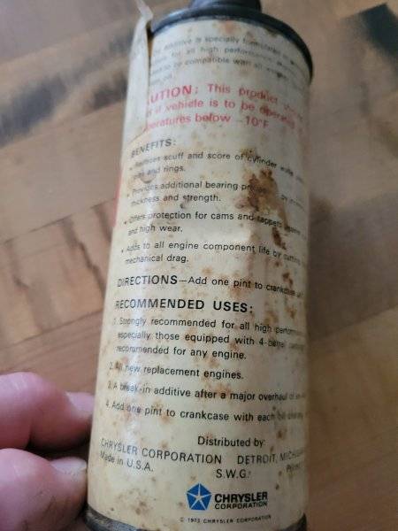

No-The stuff I am talking about, came in a quart can. I'll try to find the can I have and post a picture of it.
Here is what they sold in 1980. Stuff was black and stunk just like that smell when you crack the main bolts on an untouched hi-po mopar engine.

Yes, I would imagine that's the same stuff. Although the earlier stuff came in quart cans that you opened with a push in oil spout or a can opener. And I'm sure the part number was an earlier number.
