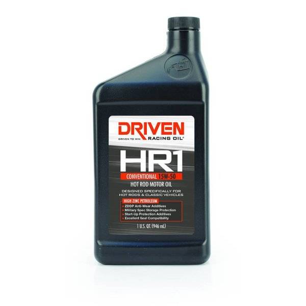

Dwayne Porter suggested that I use DRIVEN in a 20w50 weight.
Specifically engineered for the protection of flat-tappet cams. Tons of phosphorus.
The ZDDP count is well over 1200ppm in the stuff. I swear by it.
I'll also use VR1 for the same reasons in a pinch.
Surprised he suggested a 20w50 weight oil
What weight oil where you using earlier with the Valvoline VR1 ?
I have used 10w30 and 10w40. He thought that with as hot as it gets here, the thicker oil might help.
The stuff I indicated above comes in 15W-50, amongst other weights. No mention of 20W-50 for it on their website?
