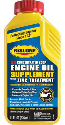

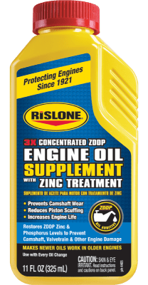

Here's another good additive that I use. It's not as thick as STP but has a lot of Zinc.
Risloni with a splash of zambuca!
