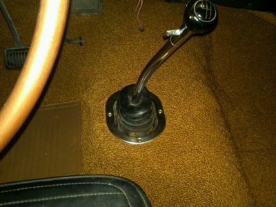

Put the carpet in today. The car still has the Inland shifter. The pile of parts is getting smaller and smaller! Down to just a few baggies of small stuff.

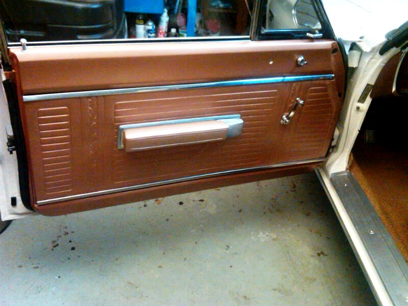

Little more progress. Ordered the P6K Copper interior paint from Herbs Parts and it was PERFECT! Got the drivers door almost completed.

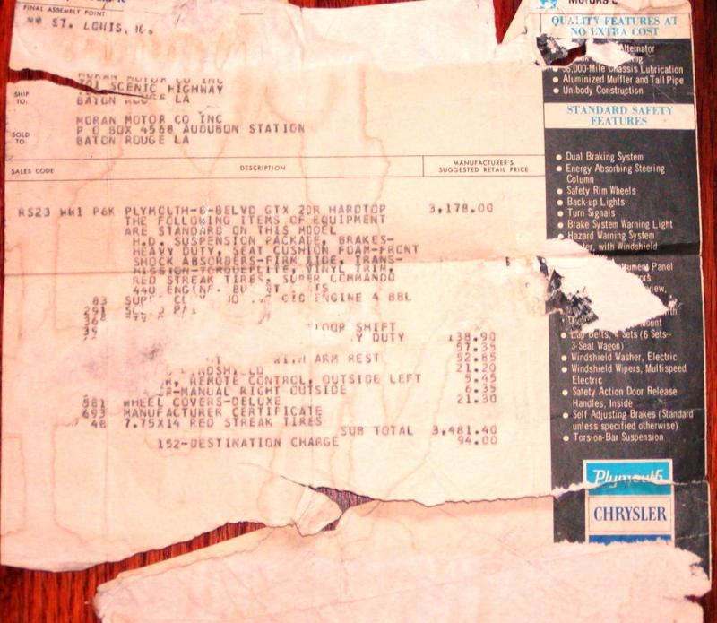

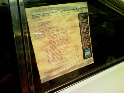

Thanks RR man. Just for fun I glued on my "aged" window sticker that I re-created. I have the original but it was damaged when I took it off the car.
was that paint you ordered from herb's in a spray can?if so i was kinda wondering how good it did.
It was a spray can and it worked great. It is a matt finish and it said that it can be used on vinyl, plastics or fiberglass. I used it on the upper and lower inside of the doors and also on the door panels and arm rests. It really went a long way, one can did all that you see in the pictures.

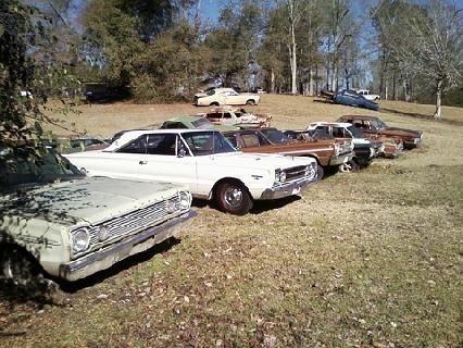

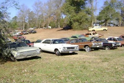

Lots of B body's at this place.

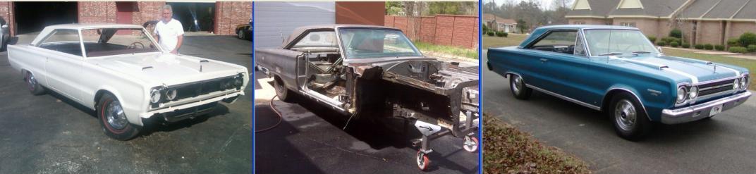

those look like three different cars.what a transformation.hell of a job!!
Thanks. I had lots of help with the body, paint and drive train. This where the work was done in Ridgeland MS. The owner of the shop has two Superbirds both of them restored at the shop. The guy in the middle, Justin, is the metal and body expert. They do fantastic work! This is from the 2011 Spies Hecker automotive finishes calendar.

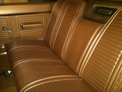

The seat skins came in from Legendary Interiors yesterday and are being installed. The instrument cluster and glove box door are at Auto Instruments in VA. I expect to have them back any time now. I will post some before, during and after pictures on the seats.

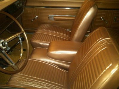

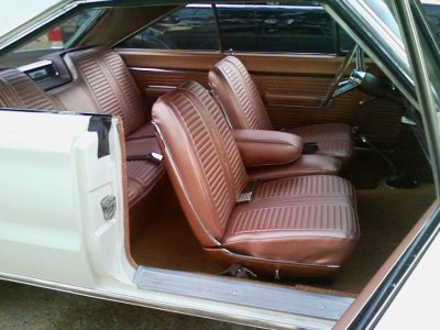

Just put the seats in and still have to paint and install the seat backs.
Outstanding thread! Great to see you taking the time to do up your brothers car like it should be done! Keep up the good work.
