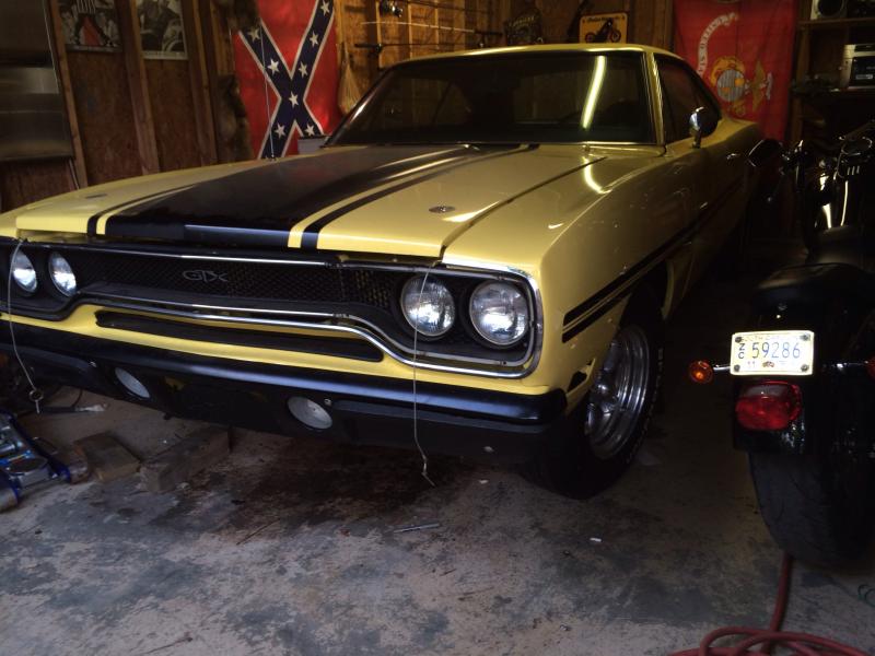

Good to hear. Running to full warm-up is best. How about a picture of your ride?
Her she is

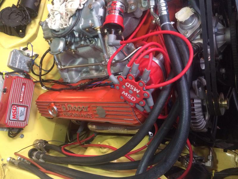

Under hood don't have my brakes and booster yet
