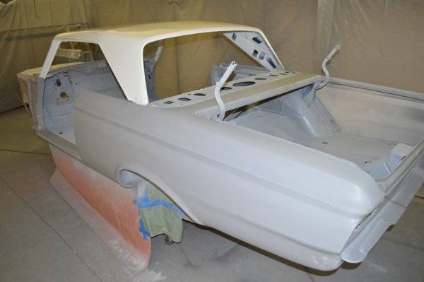

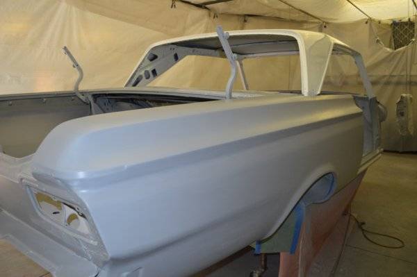

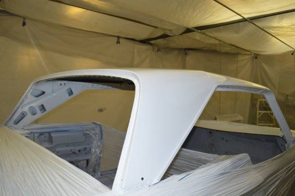

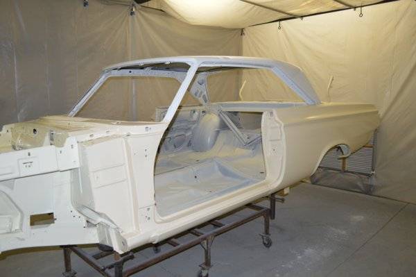

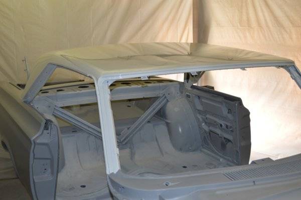

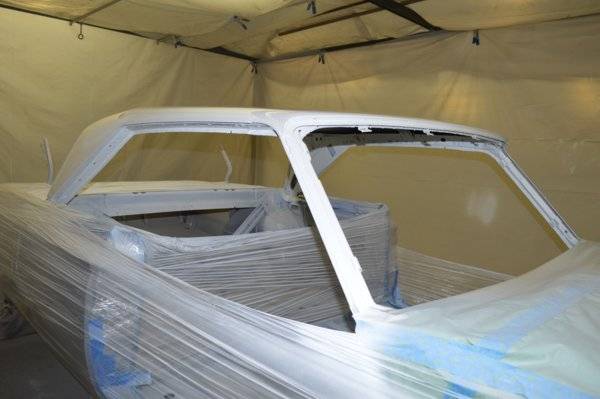

I have managed to get the lower section of the body masked off and white paint sprayed on the roof.
I did succeed in getting some paint runs......crying....lol. So a razor blade was used to cut the runs down and the run areas wet sanded, starting with 400 and ending with 2000 grit. The top will now get completely wet sanded with 2000 grit sand paper and buffed out.

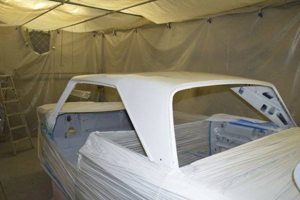

The white top has been 2000 grit wet sanded, compounded and polished. So far it has came out looking pretty good...lol...but that is in filtered light. That might change when it is out in the sun.. I have removed the masking on the lower body section. This gives a better color contrast for viewing the white top.
The runs that I had, where scraped with a razor and are now hard to detect, but, a body guy will be able to spot them in the right light.

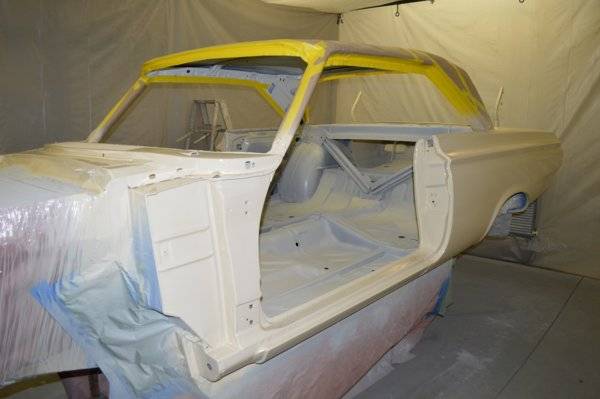

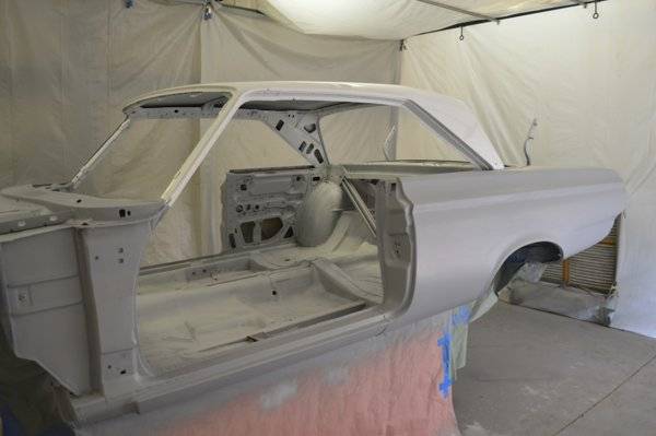

I have begun the process of masking off the top to lay some color on the body....
It's looking great and the bottom is going turn out nice too. Not far away now from a whole new stage Crumley!

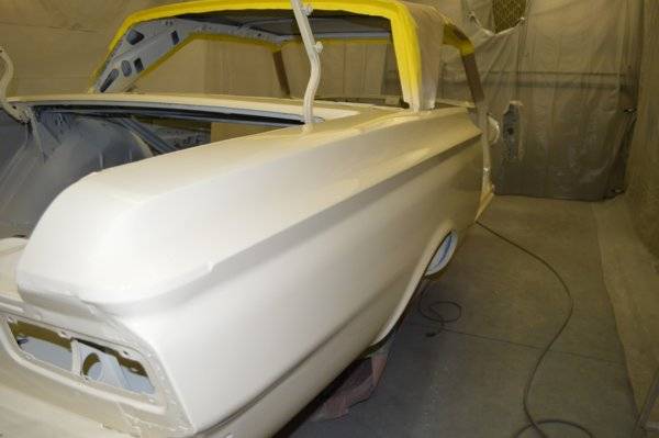

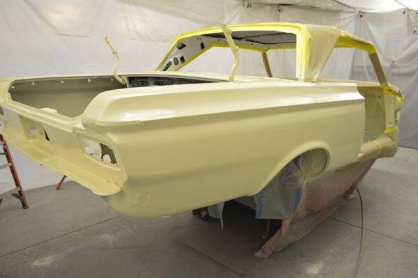

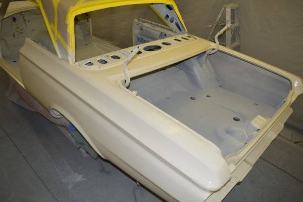

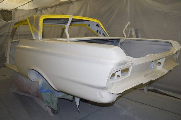

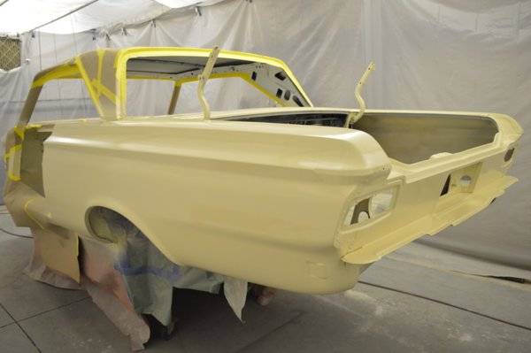

I did manage get into the shop and shoot some paint....as usual, with me that is, there is paint runs to deal with...lol. I guess I didn't let the paint flash long enough before applying the next coat....the trial and tribulations of a novice. Pictures:
Due to the lighting, it is hard tell the color, but it is Capri Cream. I had the Sherwin Williams Automotive Paint store mix it.

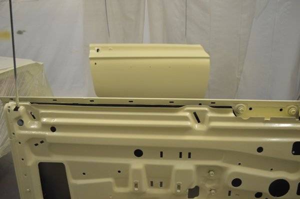

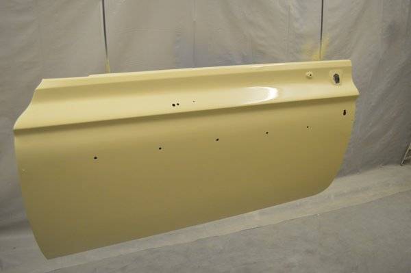

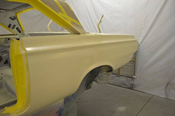

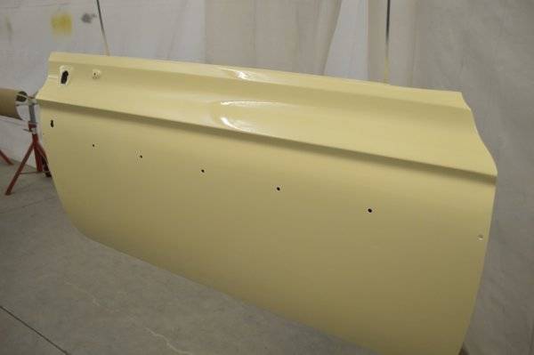

Gents, thank you for all of the encouraging support. I did manage to get into the shop. After a lot of cutting/ scrapping with a razor blade. Using a cut down paint stick. I started sanding with 320 grit and wet sanding with 400 thru 2000 grit sand paper. I did manage to get the runs flat.....but, the paint was almost translucent. It was thin enough you could just barely see the primer thru the paint. So I wet sanded the entire 1/4 panel with 2000 grit and re shot it with paint. Man did it come out looking great. While I was suited up, I went ahead and painted the doors. For the picture hounds out there:
I turned the flash off on the camera while taking these pictures.....the car looks almost yellow...hummmm, well see when it is finally rolled into the sun. Unfortunately it may be awhile before it sees the sun...lol. Below are pictures of the doors:

Looking fantastic Crumley! You know what they say, the paint job always looks better the second time! And your booth is working well too!

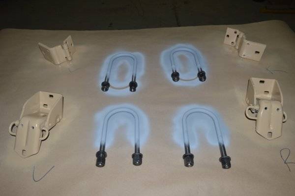

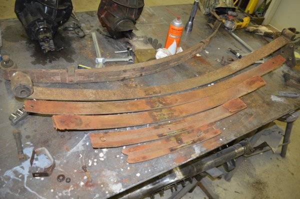

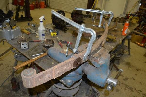

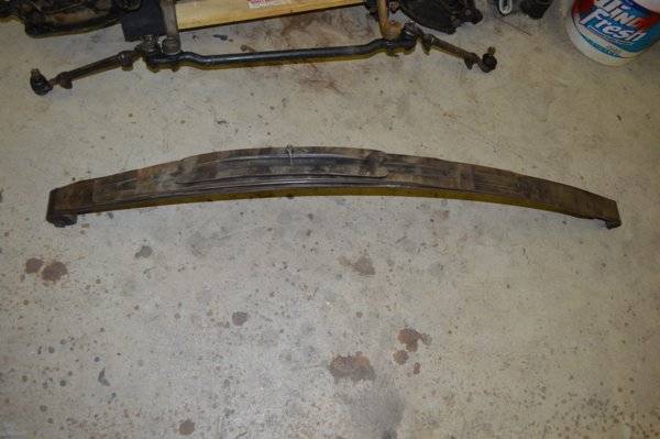

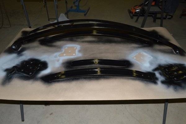

When I have time....lol. I am still working on the build. I did manage to get the rear spring pack apart and cleaned for painting. Pictures:
Is there anyone who makes a kit that contains the rubber grommets and pieces of material that go between the leaves? I will also need to get new shackles, the ones that came off the car are badly pitted and won't get reused.

I went to the local spring shop and they got me plastic sliders for next to nothing as well as some rubber bushings which the pressed in for me.
Glenwood, thank you for the heads up on where to get the plastic sliders. I found a drive shaft shop that also does springs and they had what was needed. While I was at the drive shaft shop I had them make me some grade 8, 9/16 diameter u bolts to fit over an 3 1/4" axle tube.

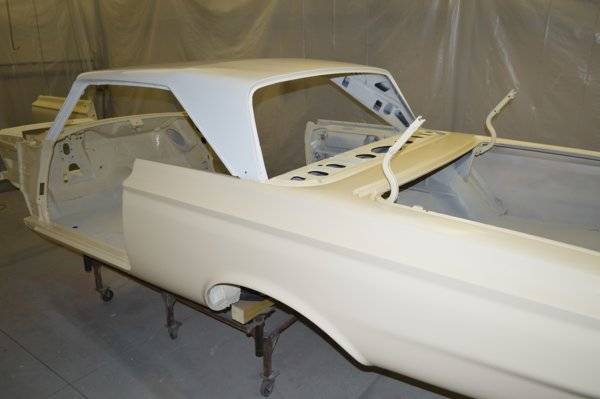

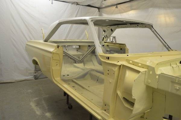

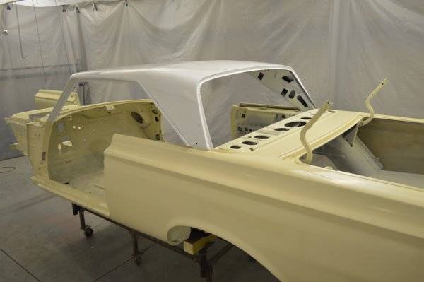

I just remembered I was supposed to update, this past Monday, the paint pictures with both colors....well, I guess late is better then not at all. Pictures:
The above 2 pictures are with the flash on.
These 2 pictures are with the flash off. So I guess the actual color is somewhere in between.

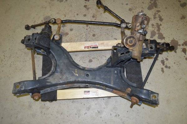

An update from today. I keep pecking away at this stone, currently I am now taking the smaller items apart, cleaning, wire brushing, repairing, priming and painting. Nothing like waiting on paint to dry....lol. Pictures:

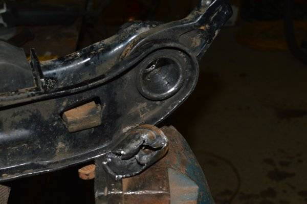

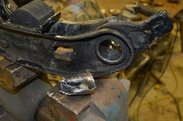

The right side, lower torque arm bushing sleeve was a complete pain to remove. I ended up having to pound it out with a pneumatic chisel. Is there an easier way to remove this metal sleeve without destroying the inner steel surface? If so, please let me know. I still have the left side to do. Pictures:

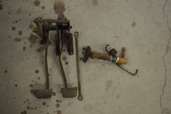

Oh, look what showed up at my door....lol. Picture:
A complete clutch pedal assembly. Looking like the old Belvedere will be getting a 4-speed. Nothing more fun then rowing a big block thru the gears.....lol.
Easiest way to remove the metal sleeve is to weld a washer to it and press it out from the back side.
