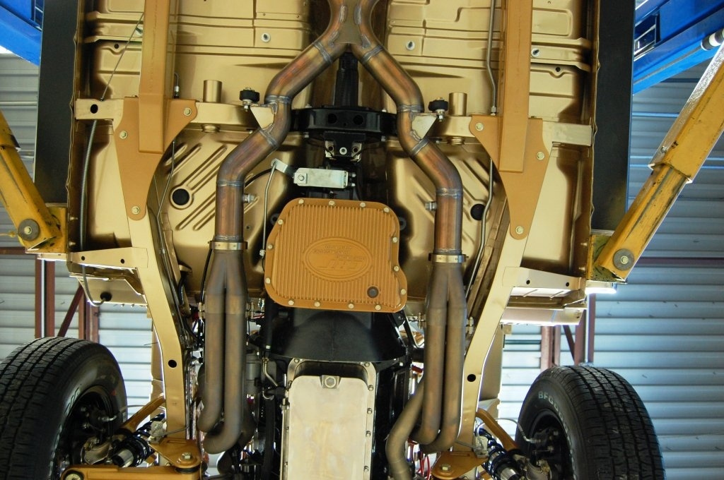

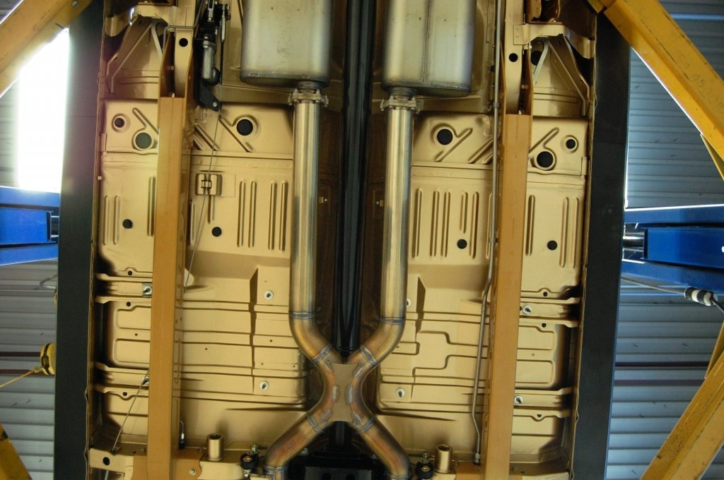

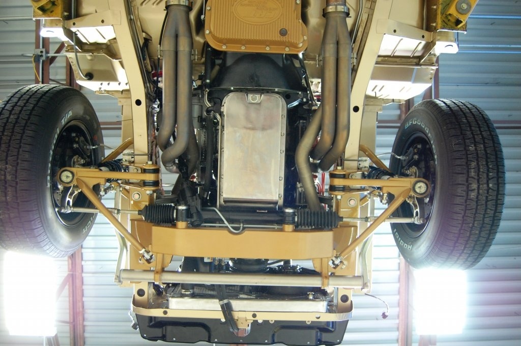

A friend stopped by and shot some photos of the bottom of the car from a different perspective. I know you guys' like pics so I thought I'd post them.

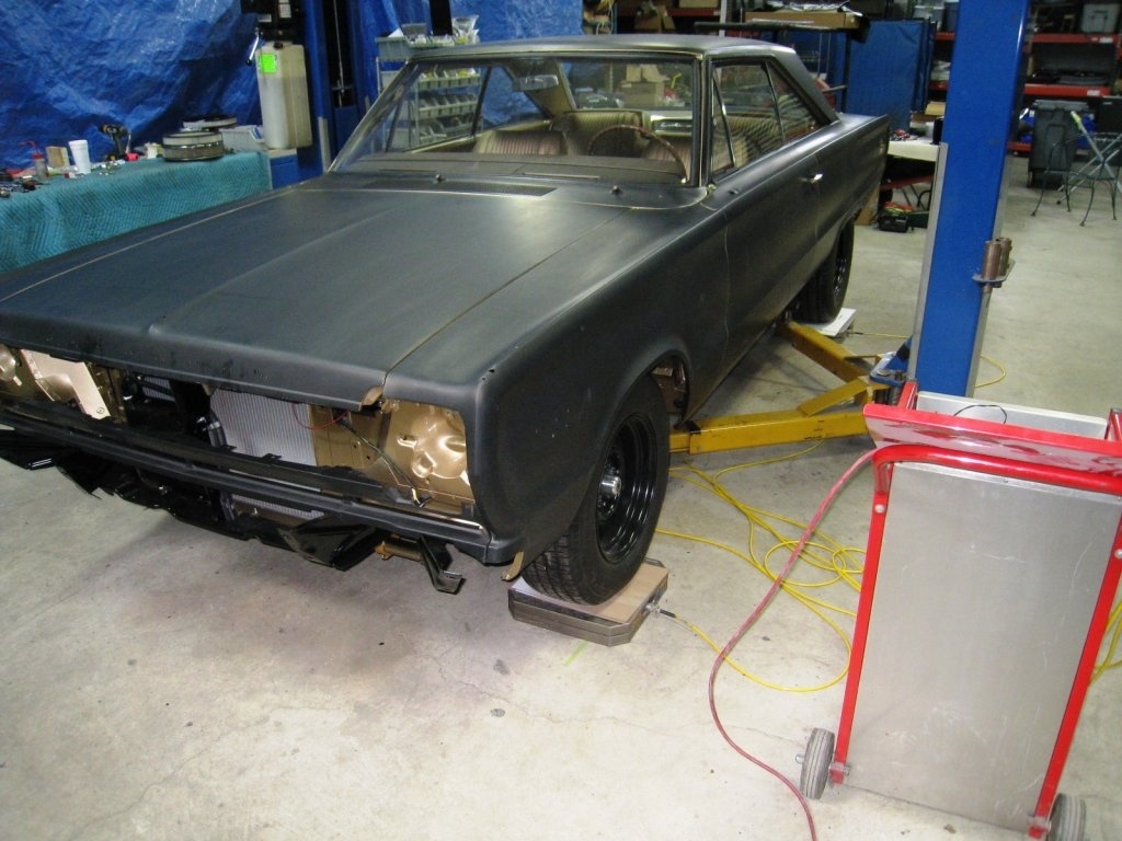

Hello All, I thought I would post a progress report. Unfortunately I haven't made as much progress as I would have liked. The car is on the ground and we've been doing basic chassis set-up. As I'm sure I wrote previously, this car was intended to be a throw-back to the car I wanted to build when I was a young guy. The vehicles that we had "back in the day" always had plenty of rake, steel wheels and dog dish hub caps. I wanted to evoke that same feel for this car. In the photos it's a little lower in the front than I intend to run. Do you guys' think that I have excessive rake in it?
With the rake that we had in our cars at the time, the small amount of caster and excessive bump steer that was in the original front suspensions of the era, most of them handled like shopping carts. This was especially true when you got on the brakes, dropping the nose and de-castering even farther. Initially looking at the front suspension you would think that based on the upper control arm angle that there was enough anti-dive in the system, that is until you realize that the lower arm pivot is on an approximate 3 degree angle sloping upward in the front. I believe that this was done to package the torsion bars under the floor pan, good for packaging, not so good for anti-dive.
In the new front suspension I elected to keep the UCA in the stock position and remove the lower arm angle to give vehicle additional anti-dive. The new design also has significantly more caster. With the ride height set with rake shown in the photos it has 5 degrees. This is more in line with typical modern geometry.
Sorry, I'm getting long winded...........we squared the chassis set caster, camber and toe. I'm hoping to get the chassis nut and bolted in the next couple of days.
We put it on the scales and put a little cross weight on the right rear. The fenders and hood are on now so I hope to take it on it's initial voyage soon!

Hi guys' In my last post I forgot to up-load the photo of the weights, so I figured I'd do that pic first maybe that way I won't forget it! The left front is 1003 LBS.

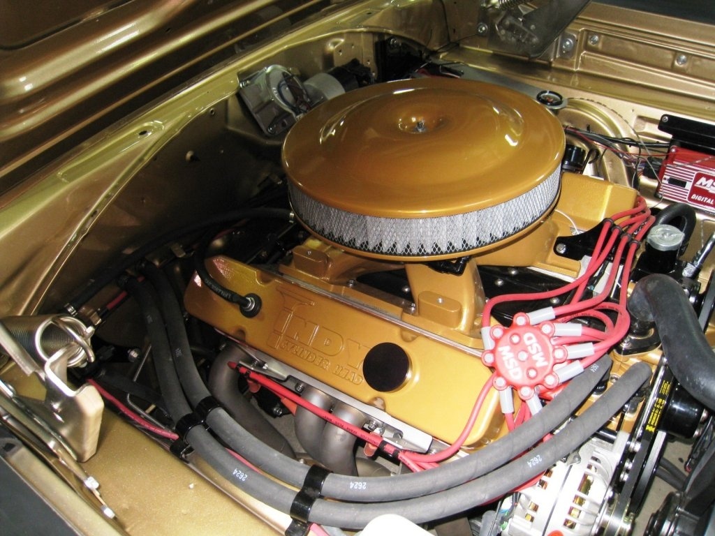

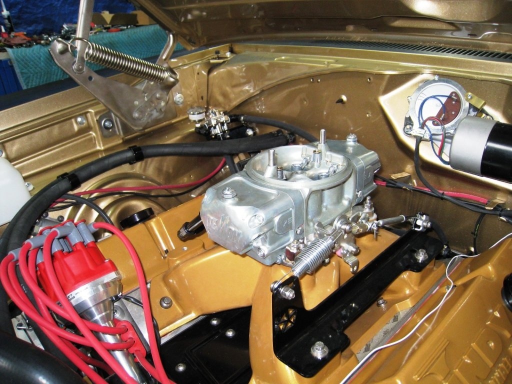

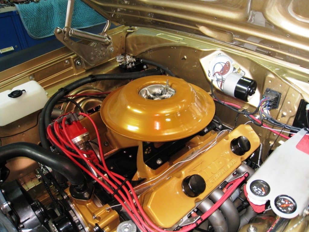

When we started assembling this car it appeared that carb to hood clearance might be an issue. The Indy single plane manifold is relatively tall even without the 1" carb spacer that I'm told it would like. Directly above the carb flange, between the hood under-bracing there was a little more than 2.5" of clearance. Unfortunately the under-bracing requires a relatively large drop at the outer edge of the air cleaner lid for clearance. I located a 16" air cleaner with a 2" drop base that I thought could be modified to fit in the allowed space. A small modification to the base was required to clear the float level screws, you can see the bumps in the base in the photo. We also had to shorten the bowl vent tubes about 1/4" to get the required 1/2" clearance to the lid. If fuel spills out of the vents when driving we'll have to install an internal bowl baffles. As a note the larger diameter air cleaner allows excellent clearance for carb linkage, return springs and fuel supply lines even with the deep offset. Thanks for looking and as always If you see an issue please don't hesitate to comment. Thanks again Brian.
Looks great! Is that a 14" air cleaner?
Hi Gpuller, it's a 16" air cleaner. The circle track guys' use them on late models, I purchased it from Circle Track Supply in N.C.
The filter is a Wix racing part and is 16" X 3", they list in their catalog a 3", 3.25", 3.5", 3.75" and a 4" version. With the 3" element I have 3/8" clearance to the hood in the tightest location. Thanks Brian.
Thanks! Good to know, a 14" drop base runs into problems with throttle linkage.

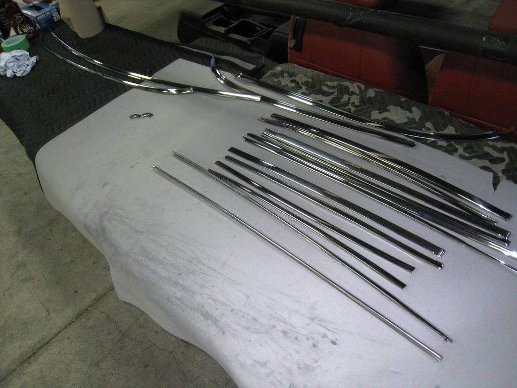

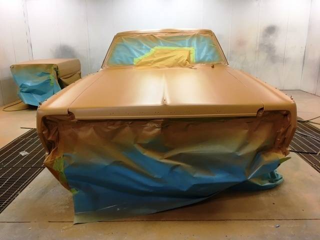

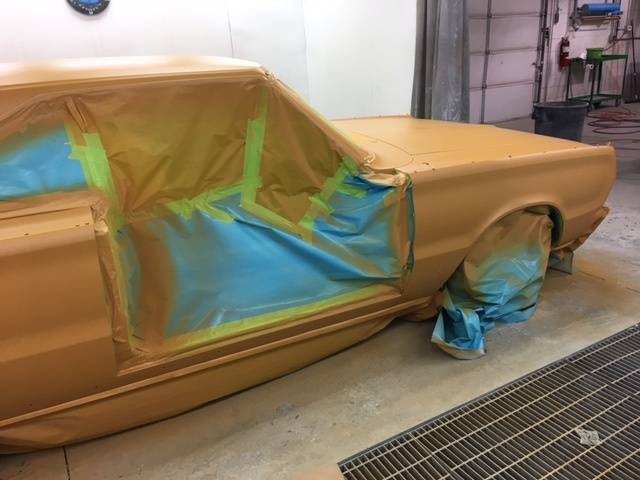

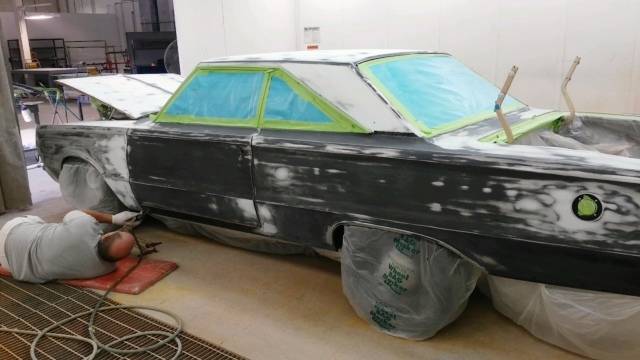

Hi Guys', not a bunch to report the car is in the paint shop being surfaced and readied for color. I elected not to gap the panels for fit, just smooth them out and make them straight. I'm hoping that was a good decision, I guess we'll see when it's done. While the car is in the paint shop I've been de-denting, wet sanding and polishing the bright work. Most of the trim on this car was in very nice condition and it was all there. I'm glad I didn't have to replace any of the moldings, all of the pieces I have seen for sale would require heavy re-work. I sent the belt line moldings, the headlight grills and the trunk panel out to de-anodized, polished and re-anodized. There was some minor dents in the belt moldings and it looked as though some one tried to pop the trunk lock and damaged the trunk panel.
I've also been acquiring the necessary molding clips, fasteners and mastic washers to put all of the trim back on the car, the credit card has been getting a work out!
The pic's of the car are in the dirty booth it will get moved to "clean booth" for color. I will post photos of the bright work when it's all polished. Thanks for looking, Brian.
