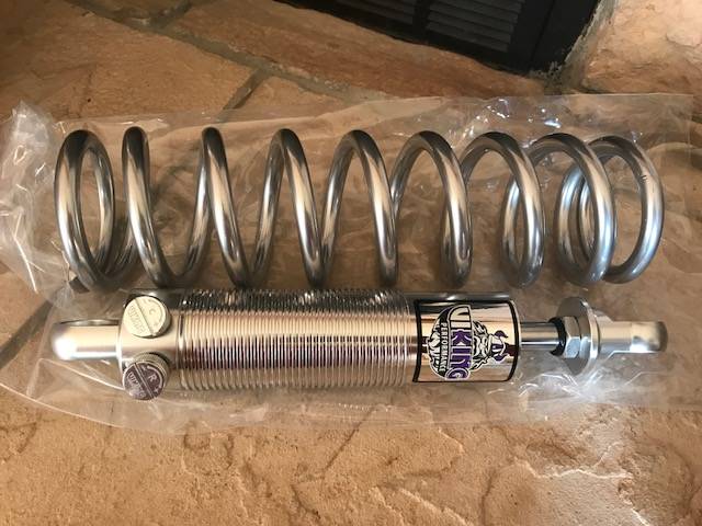

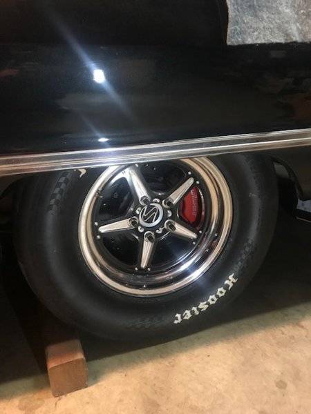

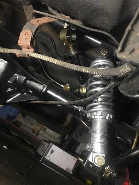

Earlier I posted about having an issue with the shocks and ride height in the rear with the newly installed street lynx. We came to the conclusion that I had mismatch shock/spring in the rear. A 14” shock with a spring made for a 16.5” shock, this was causing the shock to be fully extended at all times. Unfortunately Bill either thinks I’m trying to get free parts out of him or something, he asked for picture and measurements which I provided promptly, then he insisted I had 16.5” shocks even though I sent him a picture of the shock eye to eye and offered to send the shock back before making a decision. It’s a minor set back since funds are hard to come by but I’ll find the right shock and get it squared away eventually. Should have time to get out to the shop Friday night, no wife, no kids for the night grabbing a 12 pack and going to work.

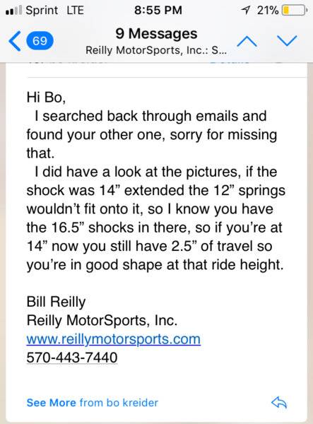

Here’s the pics I sent bill, and a screen grab of our email. I’ve had great support from him in the past but this is enough to make me stop doing business with him.

To the lowest setting? No I have it all the way up, my issue is the car is too low, as it sits now the shocks are fully extended, I need at least another 2” of travel
Try this, lower the block 1 hole and see what ya got.
I originally started on the lowest setting per the instructions and had an issue with height, so I raised 1 by 1 and it didn’t change other than the mounting hole distance, that’s what led me to the shock and springs. Bill actually told me himself the springs i have, Viking 12dp200 are for a 16.5” shock, the shocks I have are 14” eye to eye. The correct spring For my shock would be the Viking 9dp200. I basically have to bite the bullet and buy new shocks or springs.

You know I received exceptional support from him in the past but when this issue arose and we narrowed it down to the shock/spring combo he wanted nothing to do with the fault. I would have no problem covering shipping and maybe a restock fee but to be out a few hundred over a mistake not made by me really upsets me. Anyway I’ll keep you updated thanks

will do, they have great reviews so I’m expecting great things. Unfortunately a picture showing the shock measured eye to eye at exactly 14” didn’t help. He insisted I had 16.5” shocks. Now that I know there’s an issue and I look at the shock spring next to each other it’s obvious there’s an issue. I had To fight them in the spring compressor to get them on.
