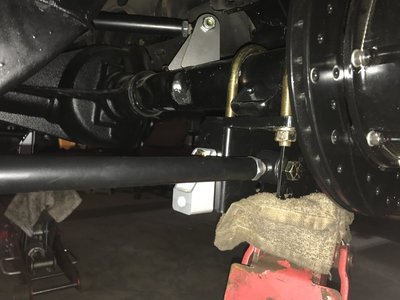

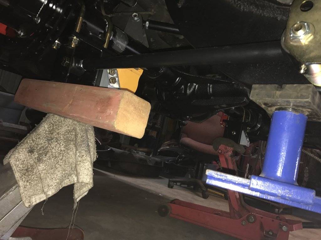

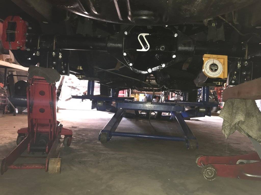

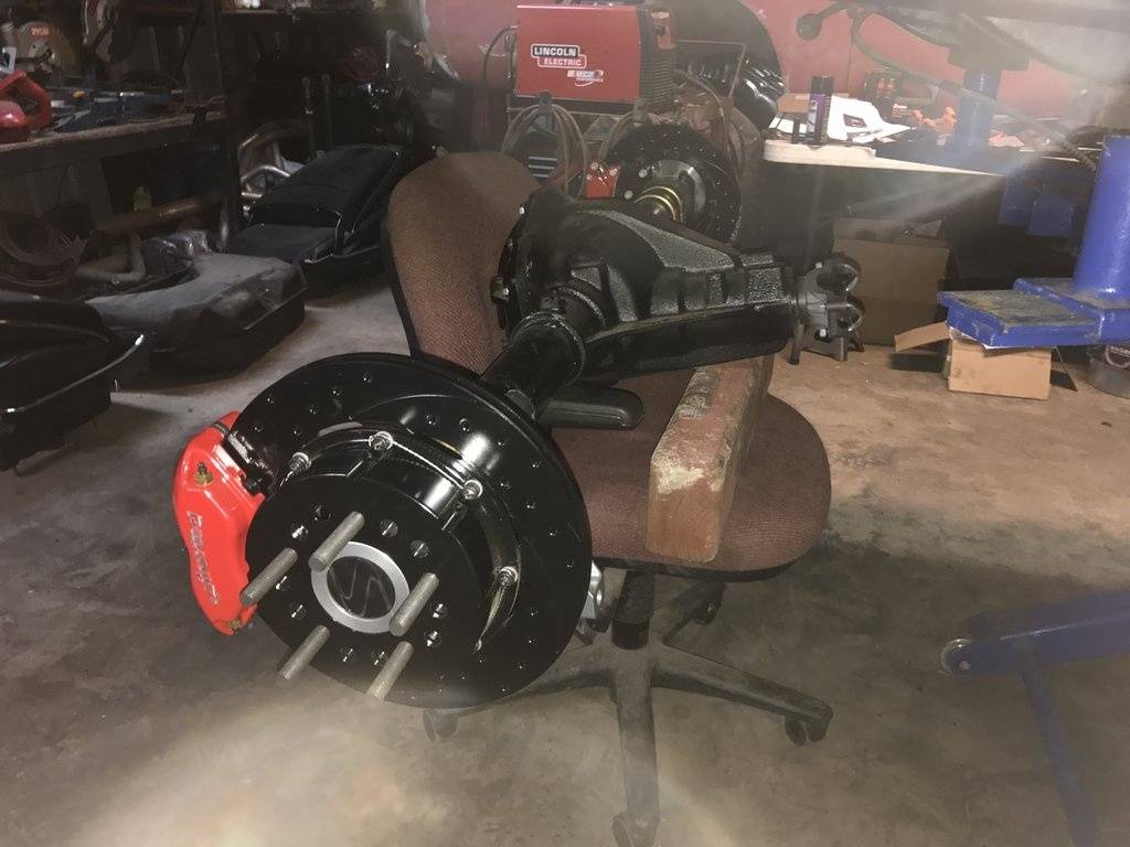

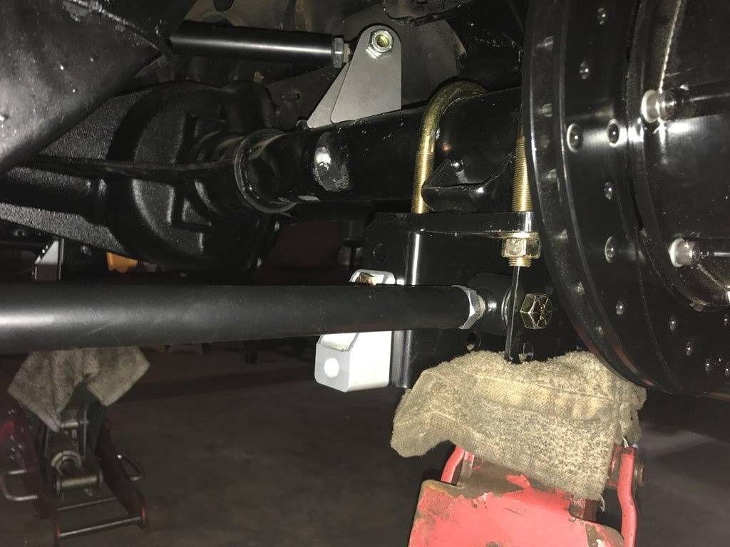

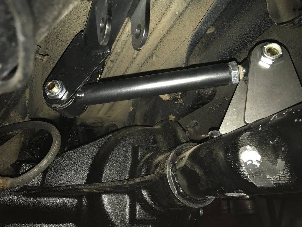

Finally got to get in and work in the car last night, got the s60 installed and 4 link suspension, just have to weld 2 tabs to the housing for the upper links (ran out of gas for the welder) happy we made some good progress on the car yesterday. We took the car off jack stands and wheeled the lift under her to do the install, just so happens and old office chair works as a perfect cradle for the rearend while positioning it :lol:
View attachment 433299 View attachment 433300
I hope thats the biggest "rear end" that sat in that chair, lol!

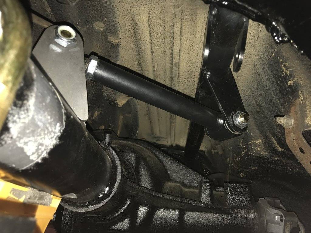

A couple more pics of the install, basically all finished just have to weld the tabs on the axle tube for the upper links, damn welder ran outta gas at 2am lol, and install the viking double adjustable coilover shocks.

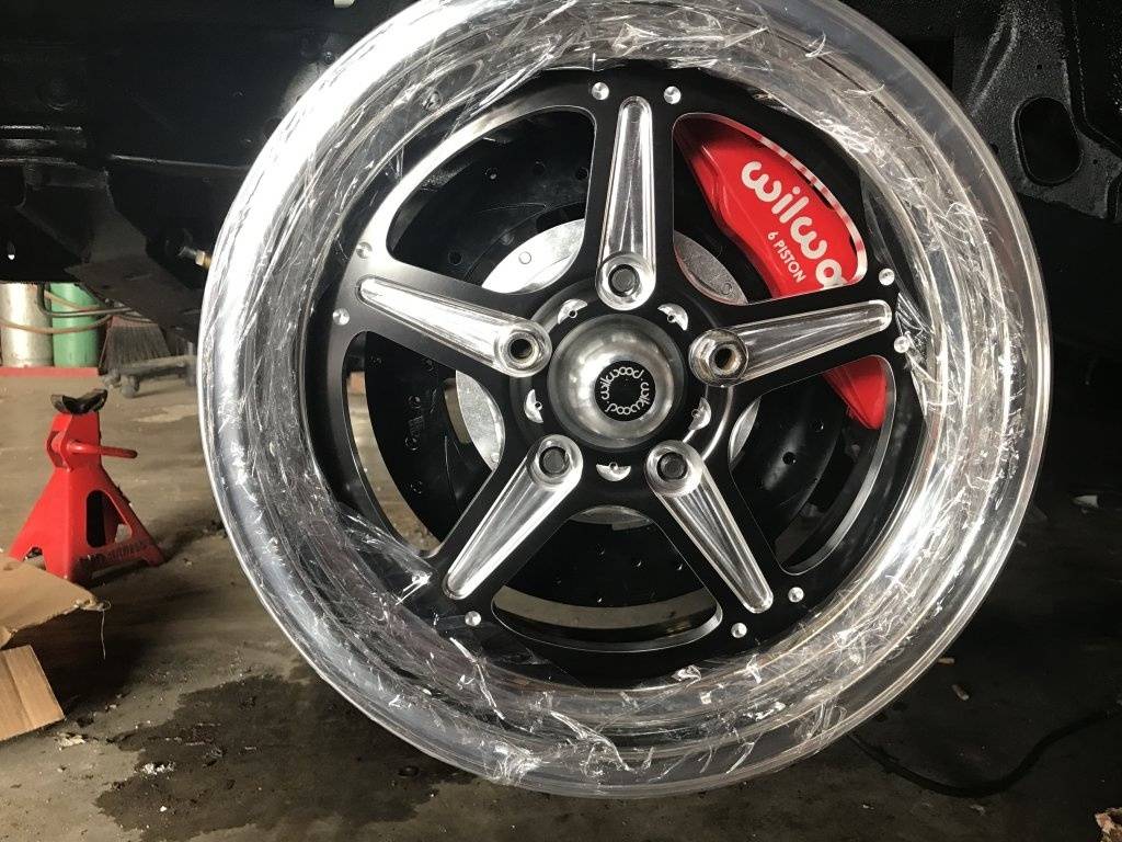

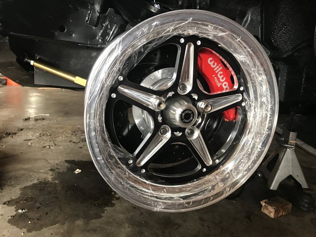

Thanks, Incase anyone is interested in wheels or ANYTHING from billet specialties let me know exactly what your looking for and I can get it cheaper and faster than ordering online. Placed order for my wheels Friday afternoon hand delivered to my work Monday morning. Price on my wheels on the web was 699 without shipping I had them delivered for 550.

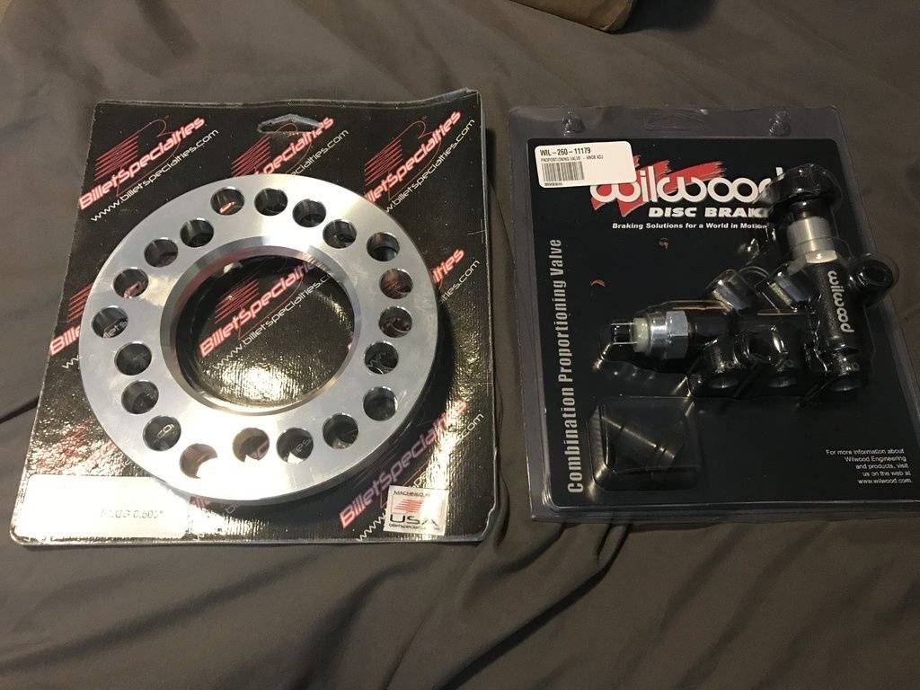

Got my wheel spacers today but and my proportioning valve. Thinking I could've gone with a thinner spacer so I might actually send these back and get .25"

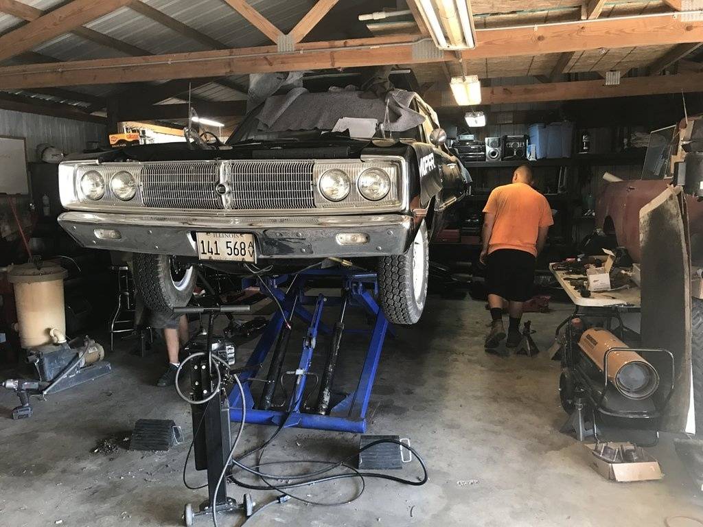

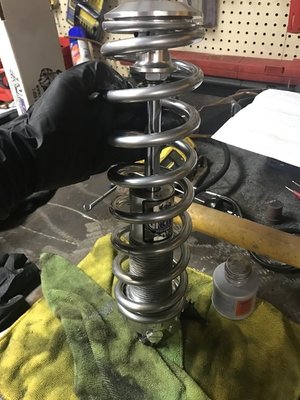

Stopped by the shop to help my brother in law out with a job, assembled the Viking double adjustable rear coilovers while I was there, will install this weekend.

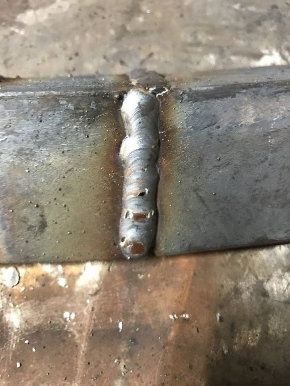

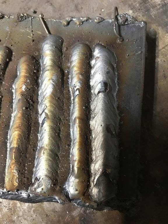

Got a new welder made a few passes getting it dialed in, boy what a difference a good machine makes, went from a little tabletop Lincoln welder to a miller magic 210 and now I can lay a decent bead. Also picked up a miller bobcat with an 11000w generator, man that's a nice piece.
