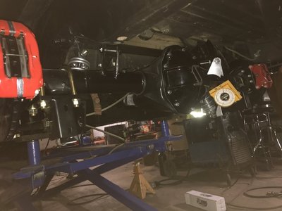

Finally wrapped up the 4 link install. Gonna throw the wheels on tomorrow and adjust the coilovers, pinion angle set up +1.0 per RMS instructions.

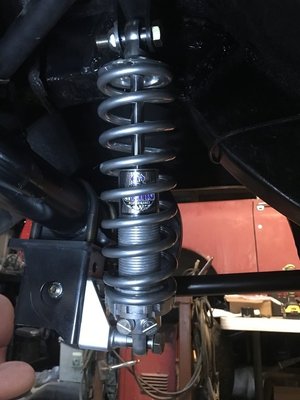

May have to move the lower shock mounts up to the next set of holes, as of now there's only a few inches of clearance between the top of the s60 and the factory upper shock mount, shocks are extended all the way out

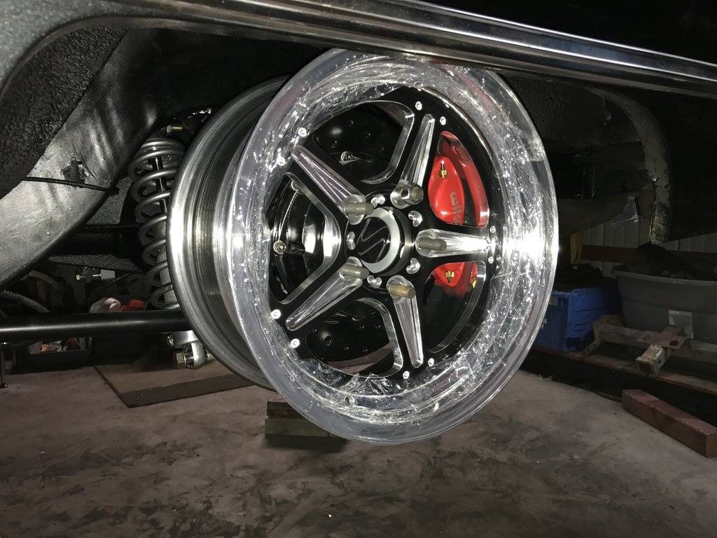

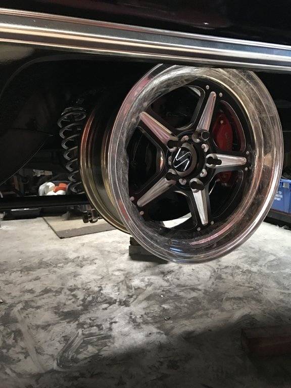

Just test fitting the wheels, I might leave the center caps off I like the strange engineering logo on the axle showing, I think it looks cool.

Thanks Justin, I've decided to leave the center caps off the rear wheels. I Appreciate you checking out my little project here.

Rim selection has to be the hardest choice on an older classic to accomplish....It is a mesh that either works or it does not....Yours clearly works!

Yes it is a very hard decision to make, luckily I have a friend that deals with billet specialties regularly and was able to get me a pair to test fit on the car. Loved the look and placed my order the same day.

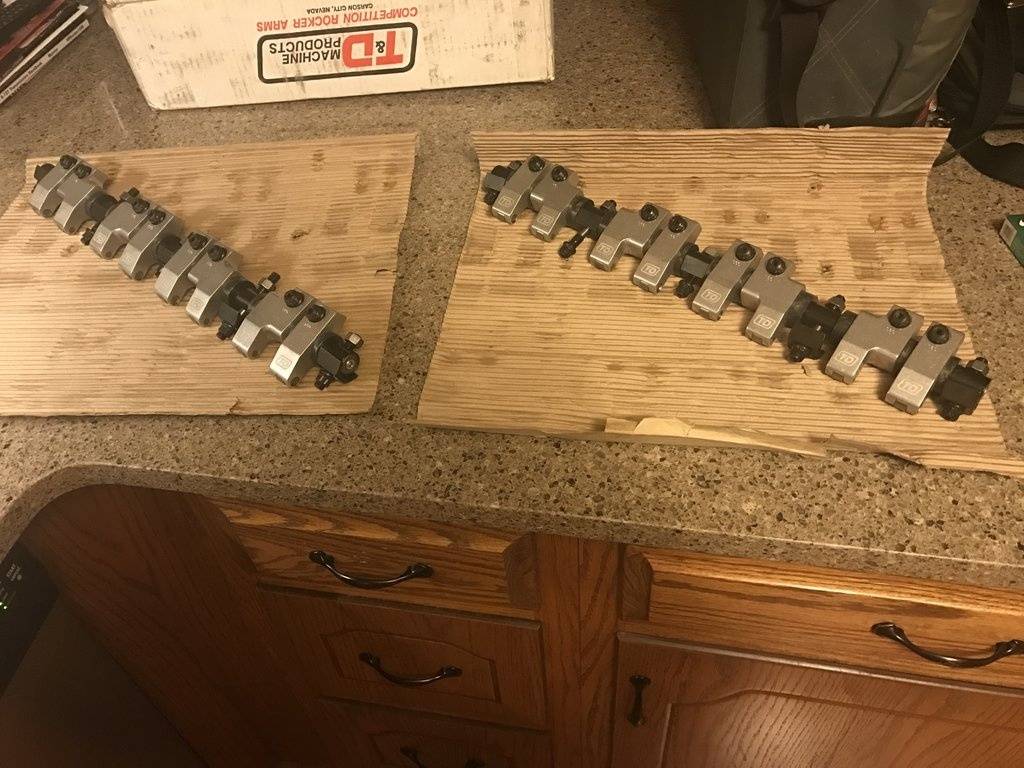

Now if I can just get T&D to send my rockers out I can get my motor back in and get this baby back on the road!

Yes it did! Heading out in a few minutes to meet a forum member that has the t&d rockers I need. Today was a good day
Got an update on the motor yesterday he said ready for pick up in 2 weeks, CANT WAIT. Got another delivery today, competition engineering anti roll bar,moroso line lock and solid motor mounts.
