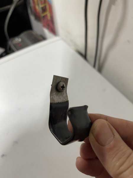

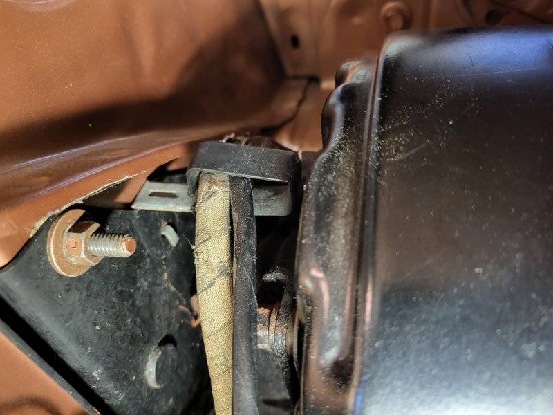

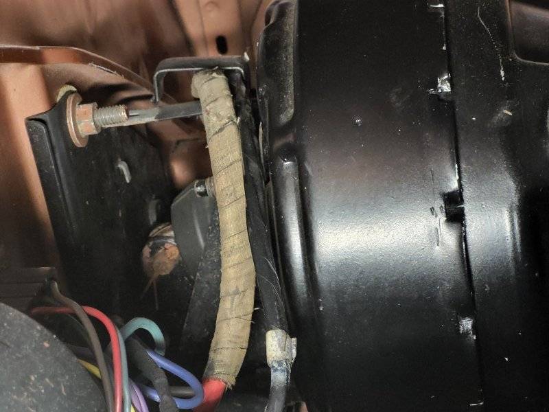

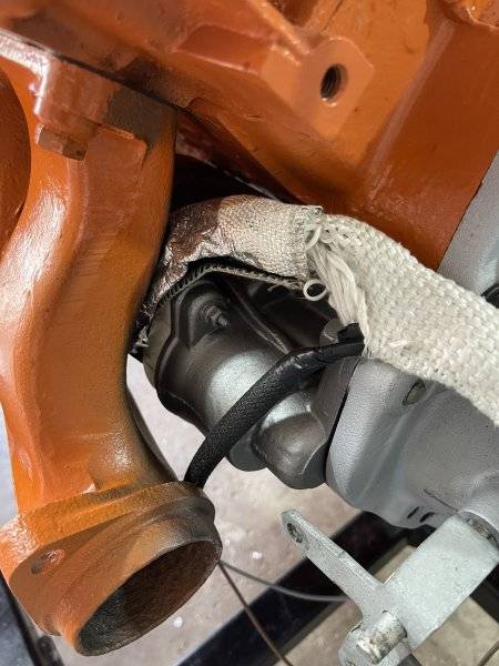

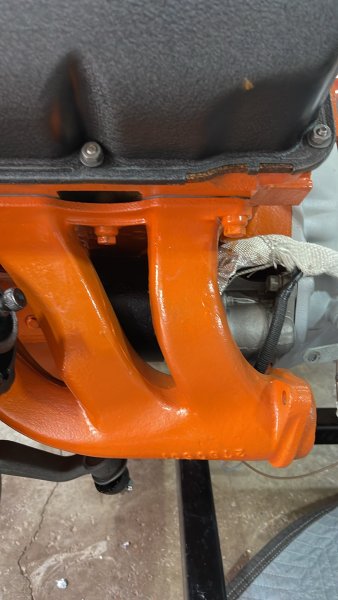

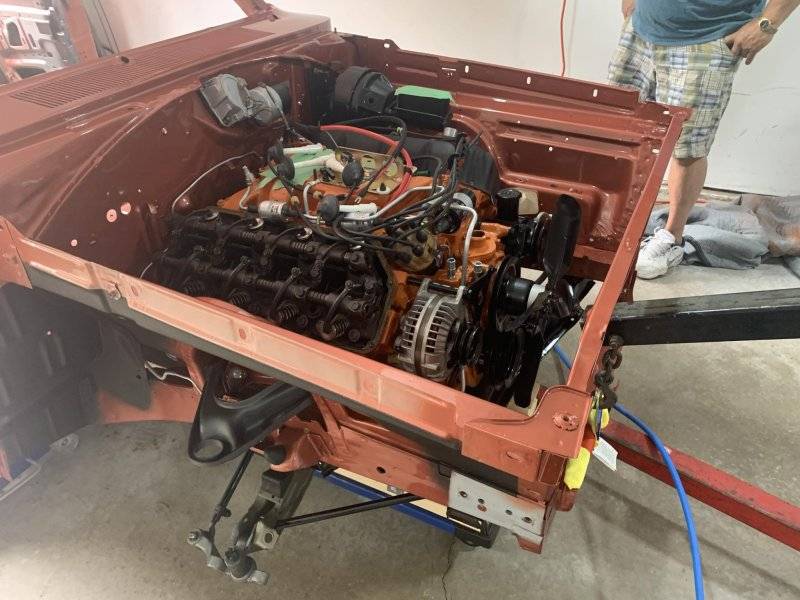

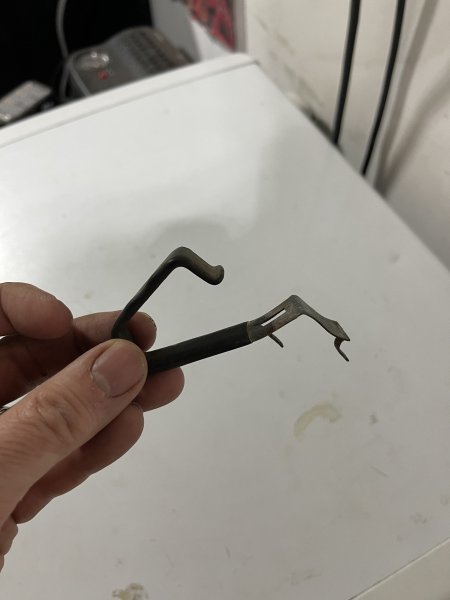

I haven’t had the heart to pay the big bucks for the starter shield . I got the new repo positive wiring harness (and that was expensive enough) so I added some covering from a friends race car wire protector .

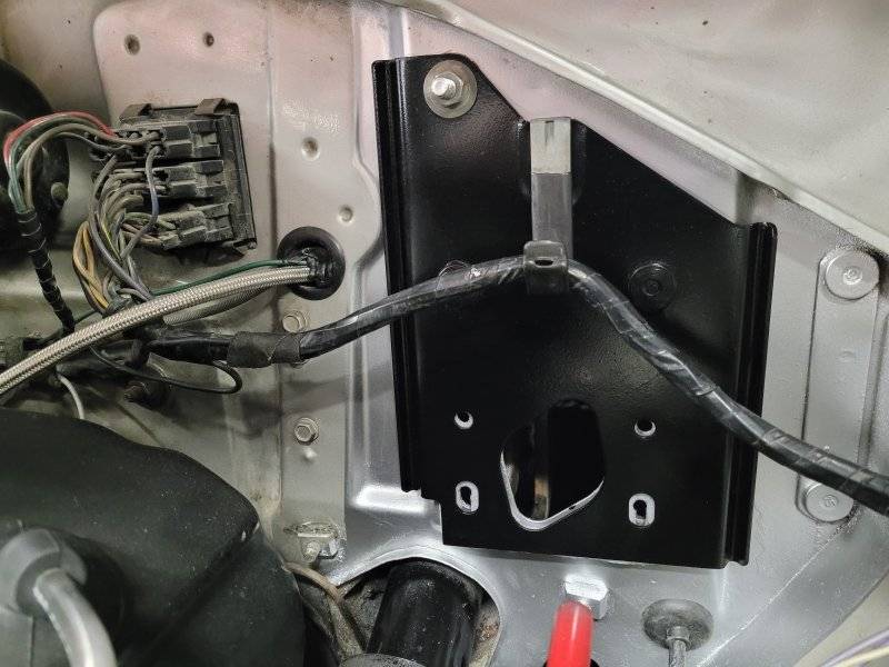

The cable harness has a bit of protection but not enough
Actually a long one won’t fit above the offset Hemi bracket.
I think it needs a really short one

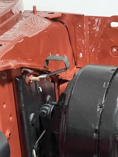

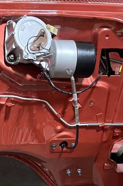

It looks like your is mounted vertically. My 67 has it mounted horizontally. I'd have to dig through photos of the disassembly to see if it was like that originally. However, it appears to be installed correctly with the bracket tang engaged in the firewall plate. Also looks like it would interfere with the pedal linkage if it hung down, but maybe not.

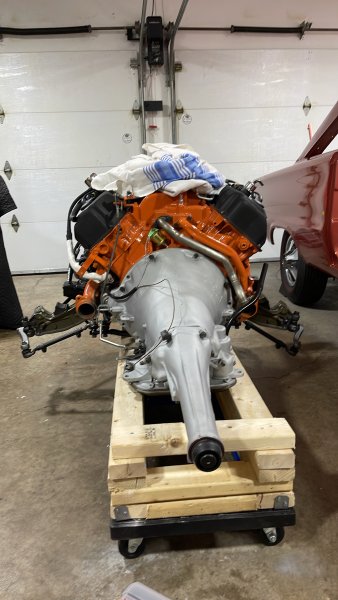

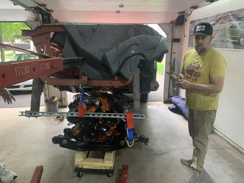

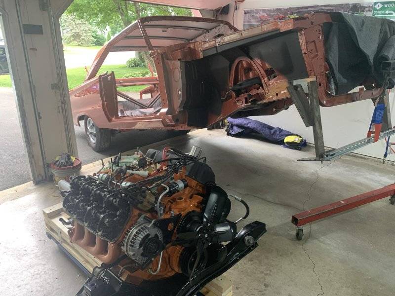

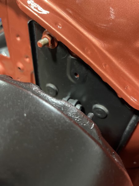

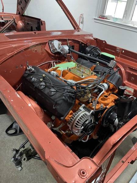

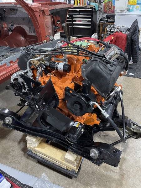

I can’t tell from your pictures if the battery tray is installed. If it is I suggest removing it before trying to drop the body over the engine.
