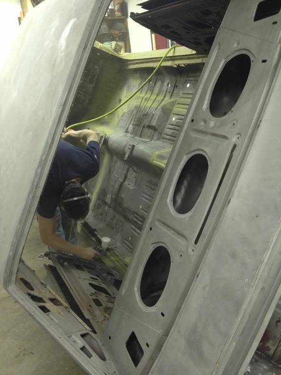

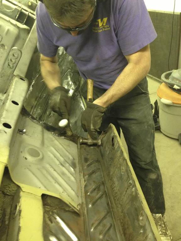

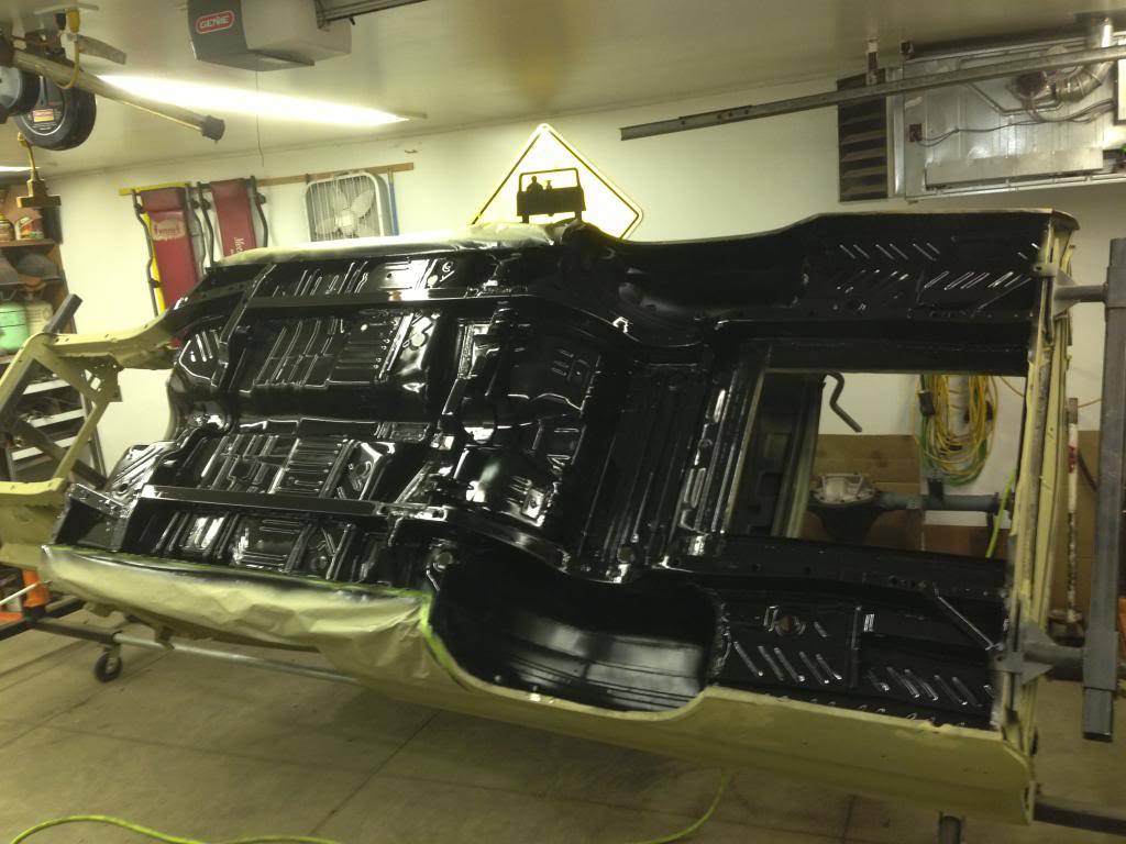

With all the mock-up, fabrication, welding and grinding done we turned our efforts towards prepping for the upcoming body and paint work. We got down into all the cracks, seams, corners and hidden areas that the media blaster just couldn't get to. We used small screwdrivers, scrapers and cleaners to clean out the remaining undercoating. We then turned to body hammers and dollies to straighten and repair the seams and weep holes. Then came primer and caulking in every seam before covering the underside in primer. Finally, the underneath is complete and painted.

You've been busy! Sure shows with your work, That looks great underneath!

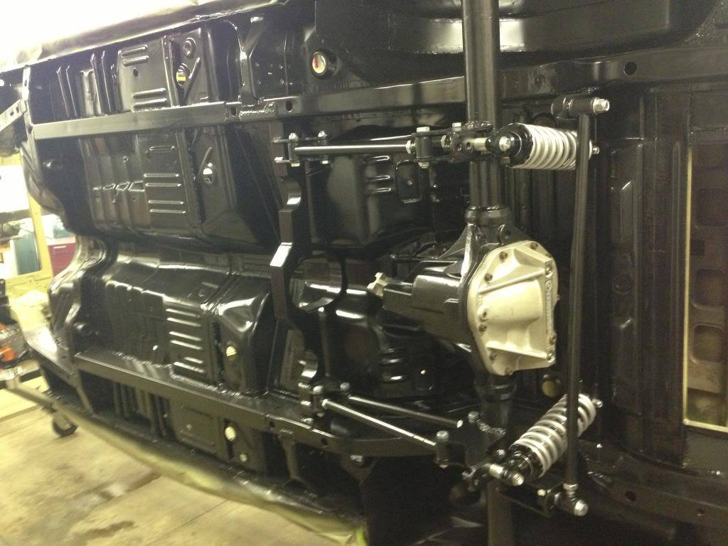

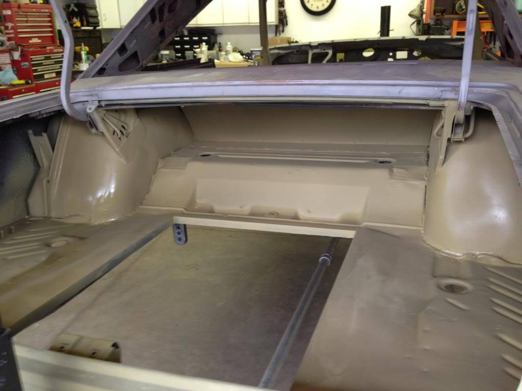

Not a lot to report. We spent some time test fitting the suspension and played with a new toy - a plasma arc welder. Plans are to make our own tank out of stainless and this welder seems to be the way to go. Of course I'll update the thread with progress on the tank when we tackle that project. (Scroll back for photos of the trunk we prepped for our custom tank) For now we're going to finish up some odds and ends while we wait for our turn at the paint and body shop.
Upside down:
Right side up:

That suspension looks good. Aughtta make that car ride like a dream.
Makes you kind of drool some! I have to agree, the suspension is great! I love the looks of that rear end sitting in that, looks like it can take some punishment and not be fazed any!

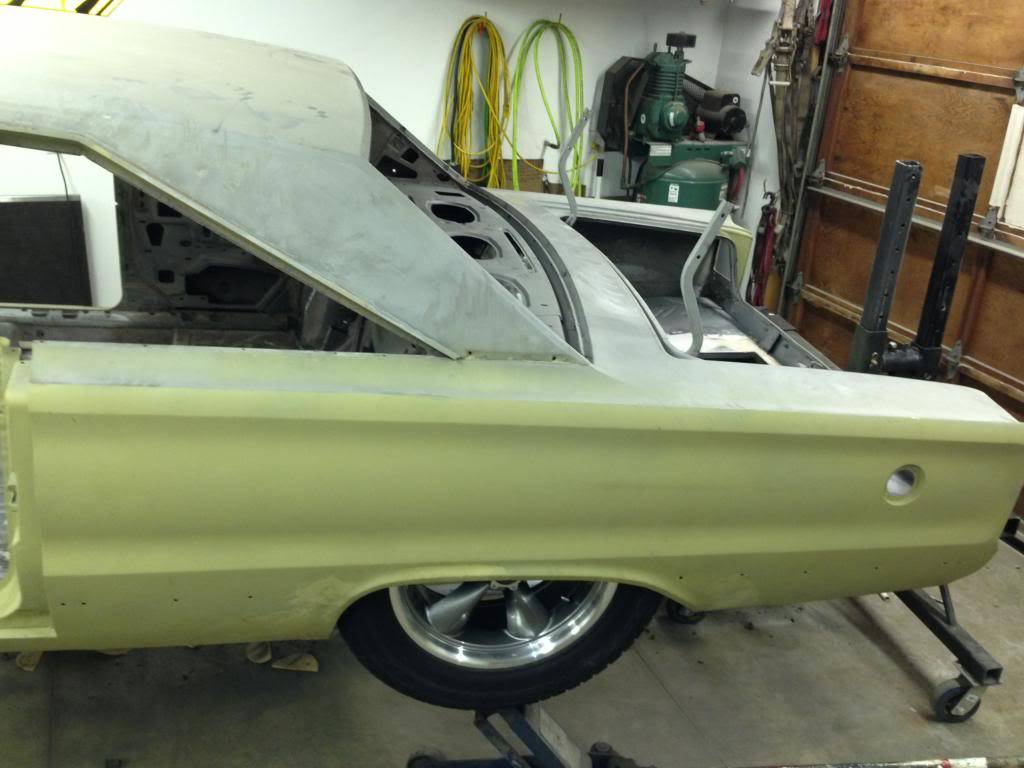

Not much going on. We've gone as far as we can go and we're patiently waiting (not really) for our turn in the body shop. He's running behind on another car. The most recent photos I have show a little progress from the last update. The car is now 100% covered in DuPont 615s self-etching primer and the bottom and interior are covered in Chassis Black.

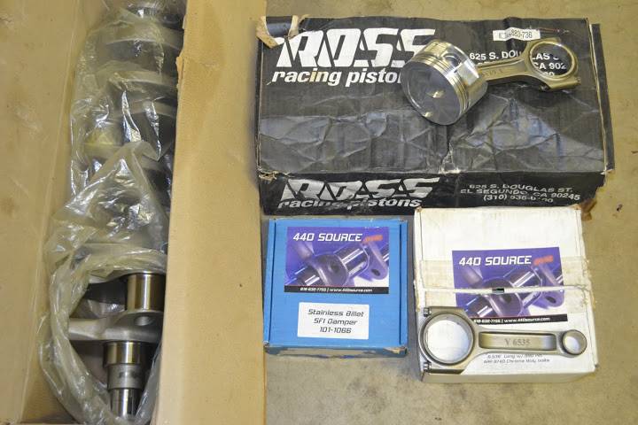

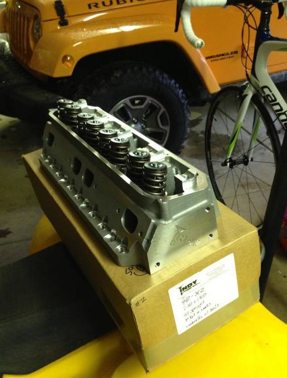

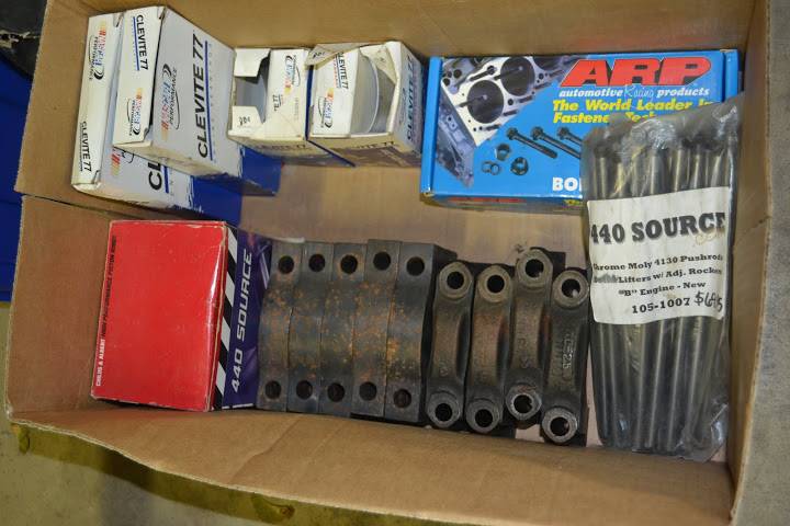

Currently I'm doing an inventory and getting the engine ready to go to the builder maybe this week.
383 block
Stroker Kit: 383 to 496
Thanks for looking.
