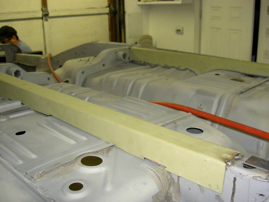

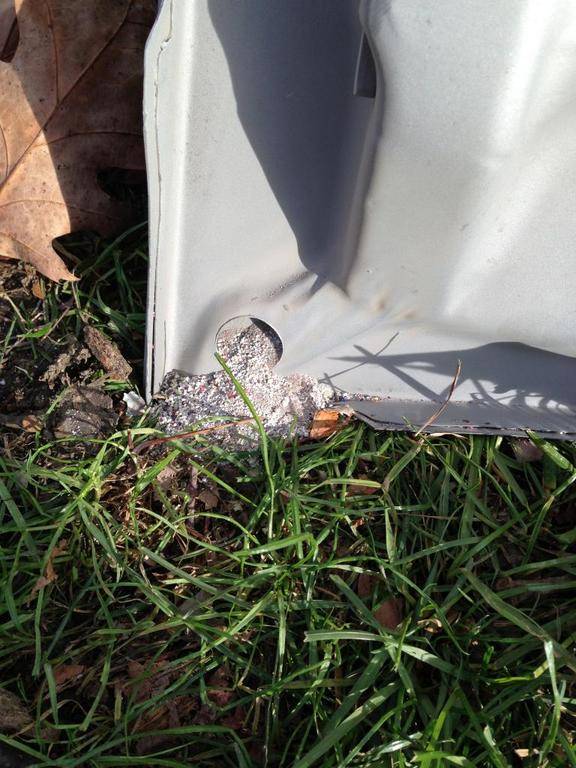

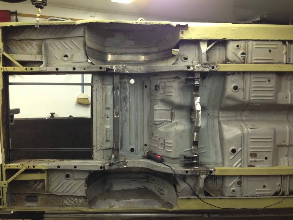

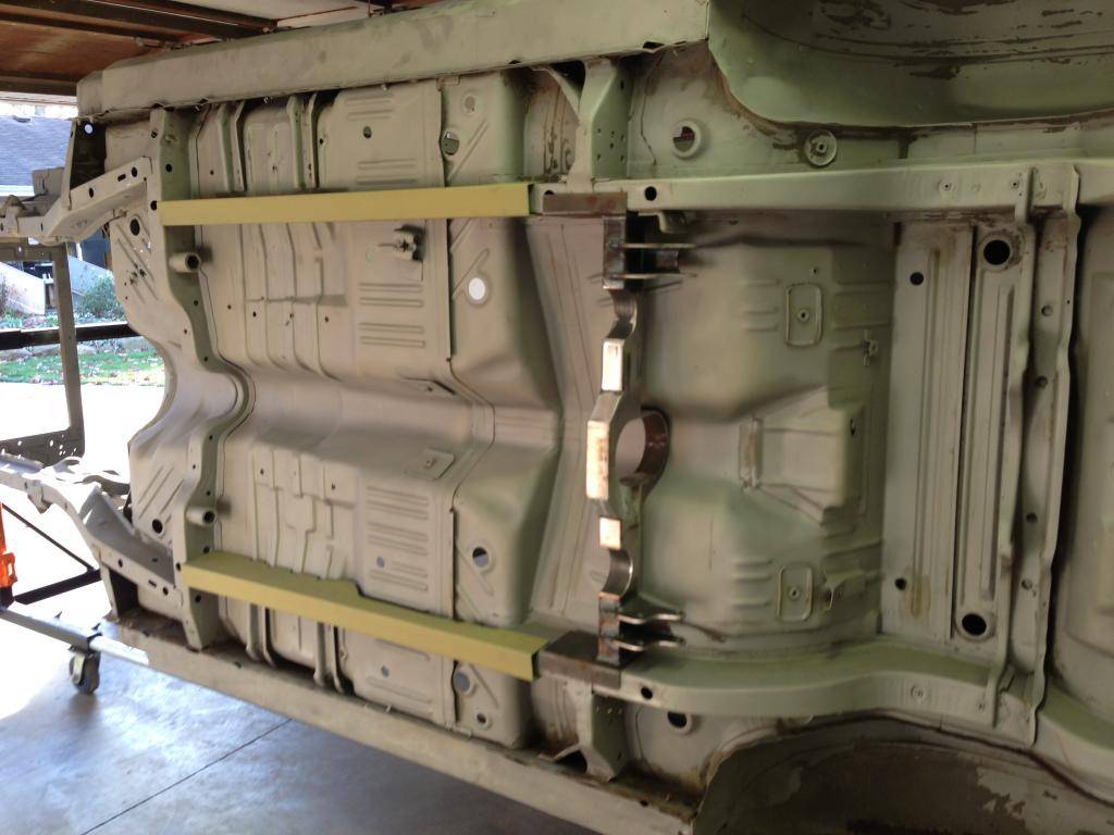

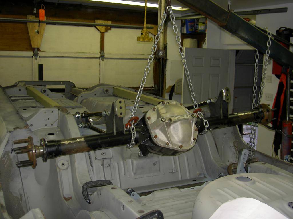

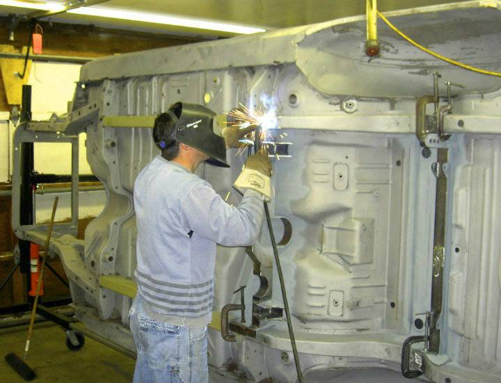

Update time. We got the car back from media blast - no real surprises. We spent the better part of the day removing buckets of blasting material. The car had a bit of filler around the rear quarters and some pinholes in the driver's floor but we're WAY ahead of the game. We spent some time mocking up the Dana with the rear 4-link and fitting the XV subframe connectors. Here are a few photos with more to follow later this week.

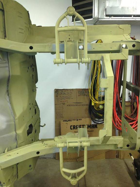

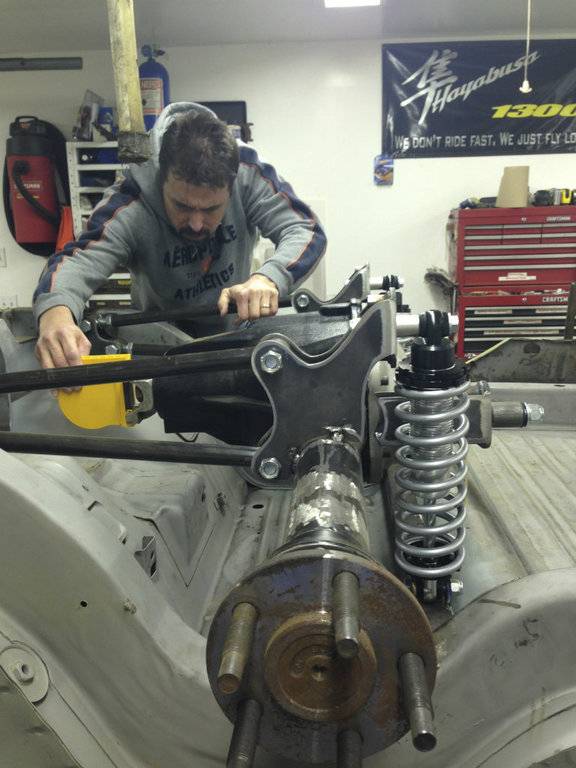

Short update: Spent a little time in the past week setting up the rear 4-link and AlterKtion front. Had to remove some brackets and grind some edges. We then started on splitting the tubs to maximize available space out back.

I like the 4-link set up you have too. I was thinking about Caltrac split mono leafs and Caltrac bars. But now I'm not too sure.Did you narrow the rear end any?... Nice work!
Thanks for confirming - I heard that too and I've ordered one for a 68 - I'll post up how well it fits and what we have to do to get it to work. The rear is close to stock length - although I can't remember the exact measurements right now.

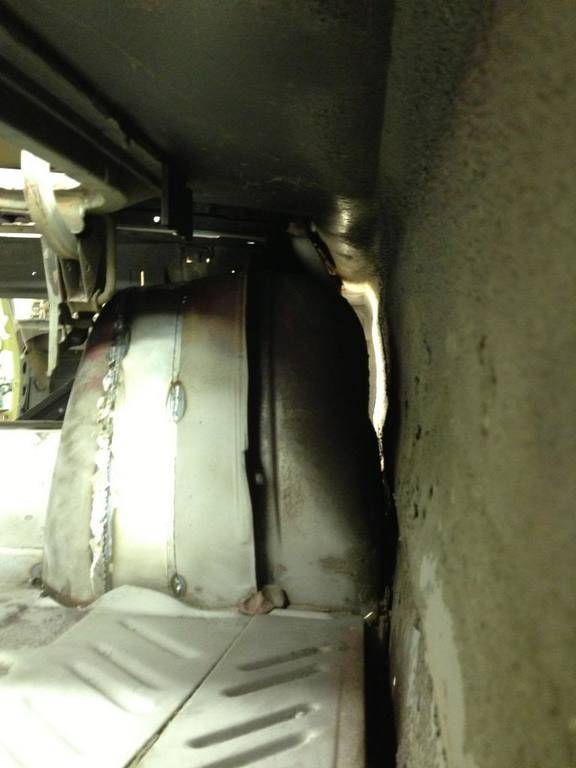

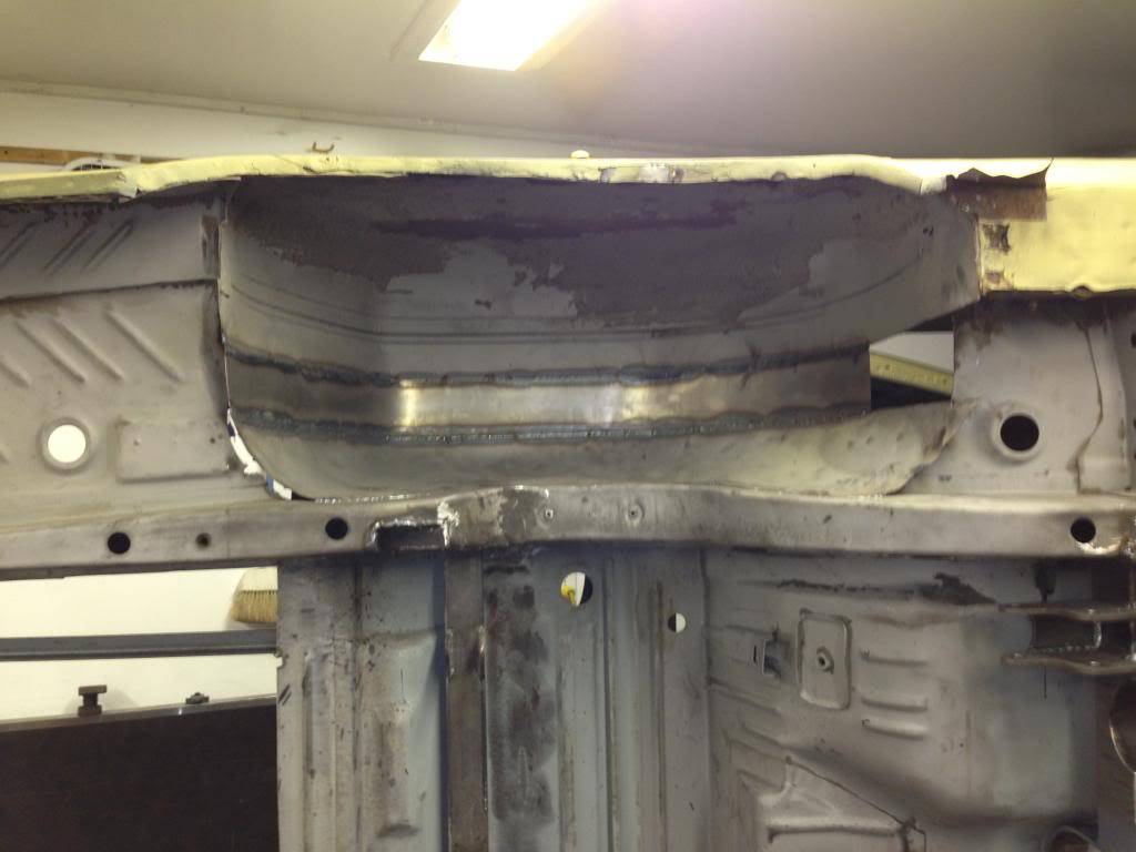

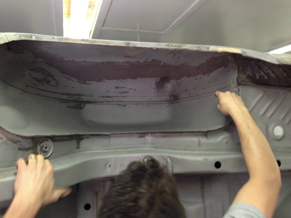

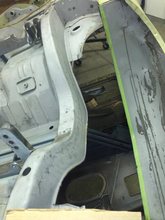

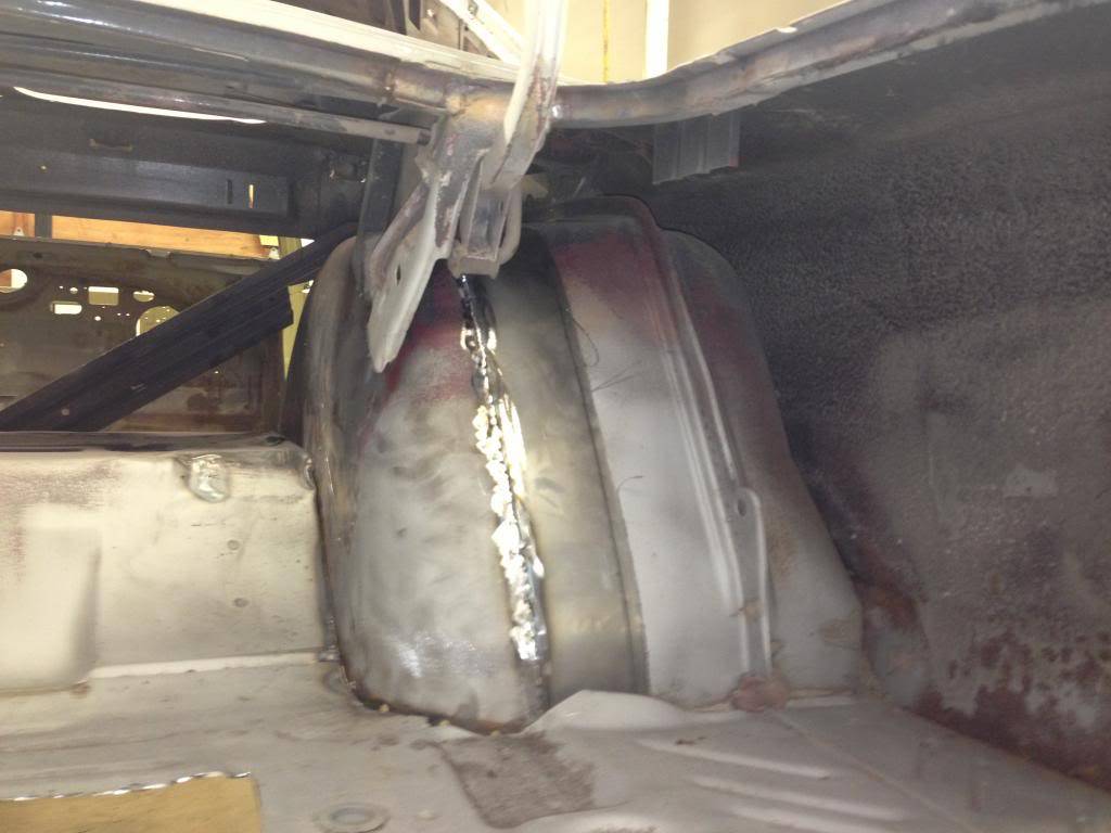

Just adding a few photos as we sort out the rear tub issues and continue mocking up everything before paint and body. The last update had a photo of the tubs split. We moved the inner tight against the frame and welded in a strip a metal. Here are a some photos of the prep and how it's starting to look. Also including a view of the space between the outer wheelhouse and the quarter panel - a view that I had been wanting to see for a while. It shows a good perspective of the "bump" that the 66-67 guys have been talking about that restricts tire size. We'll be working that out as well.
Smoothing it out on the bench:
Wasted space... for now:

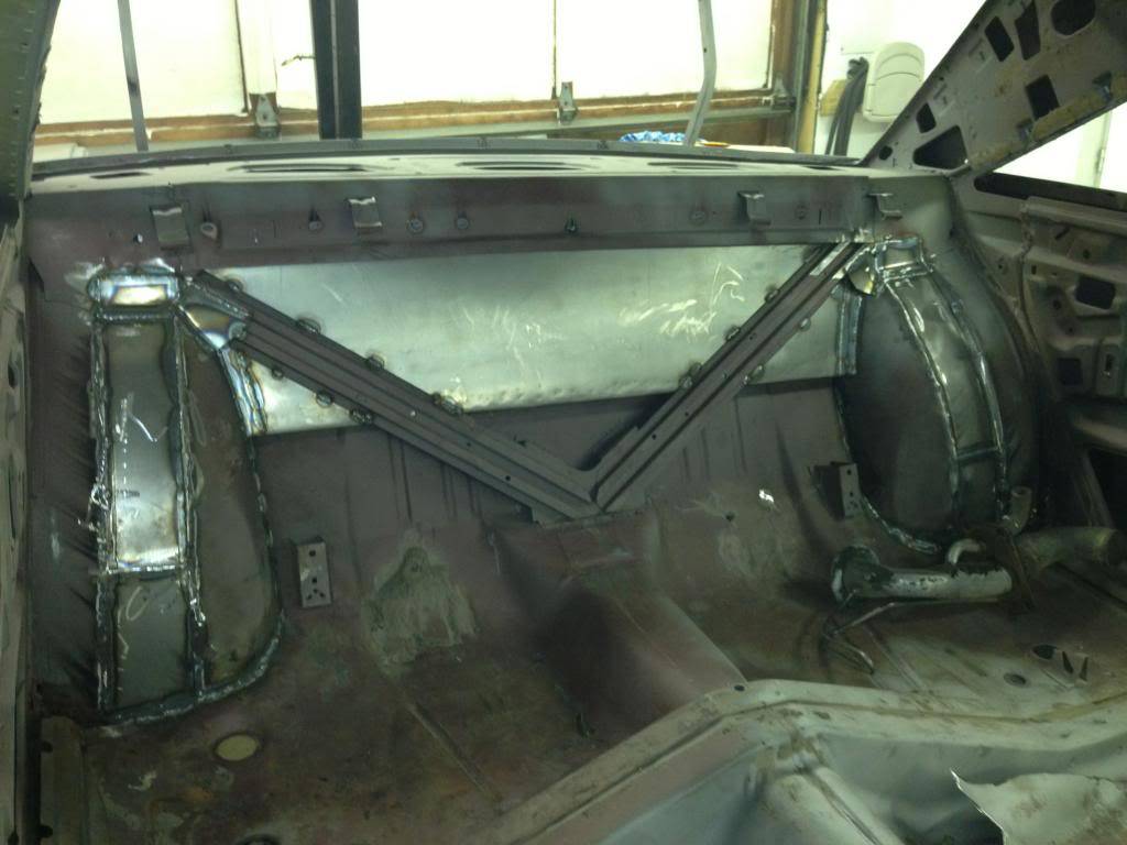

Finished off the tubs and closed off the trunk:

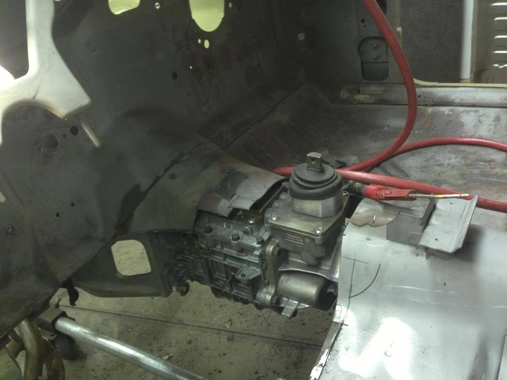

Lowered in the block and the transmission to check for clearances and any additional fabrication needed for the headers and the trans tunnel auto to manual modifications:

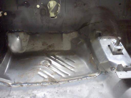

Lastly tonight - replaced the footwell panel that had some rust and pinholes:
