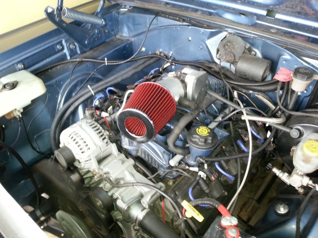

All good to know info. My 6.1 had the dipstick on the right side and entered the pan. There is a provision in the left side of the block for a dipstick. Did the truck use that provision? PM me when you plan a trip to the area.

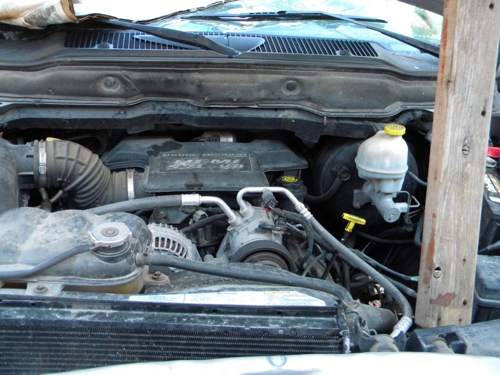

This is the only image I have on hand. But I think it runs down the right hand side of the block. I didn't have any trouble with any interference or anything. It still shows an appropriate fill level.

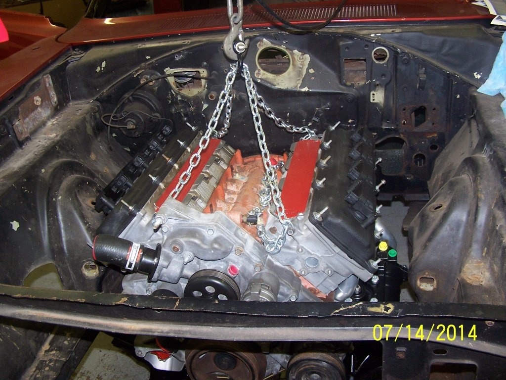

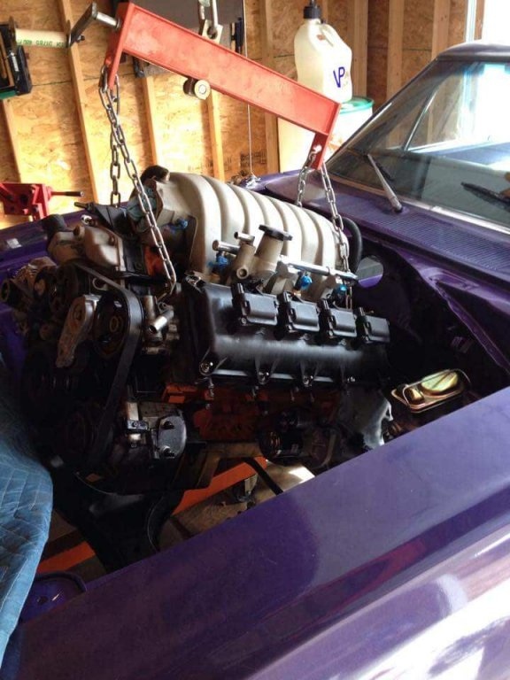

That sits in there sweet. What k frame do you have. Very nice!
I had a stock v8 k frame but I cut off the mounts and made my own. if you want to look in the restorations my thread is called 1967 Coronet Deluxe. A quick search should bring it up. They are on something like page 6.

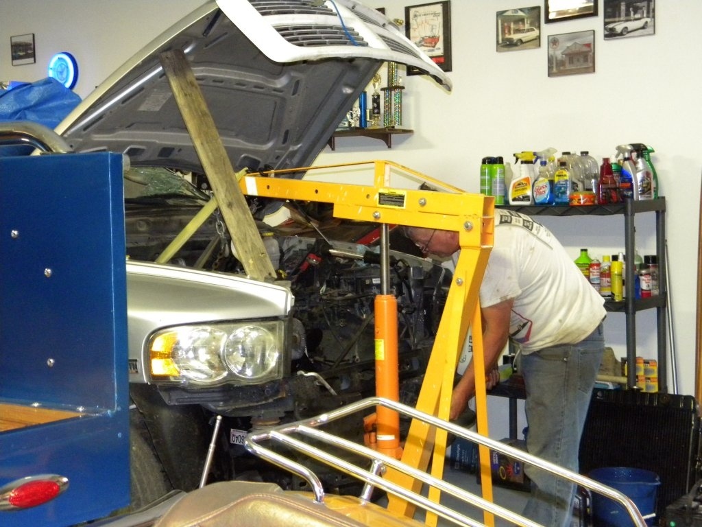

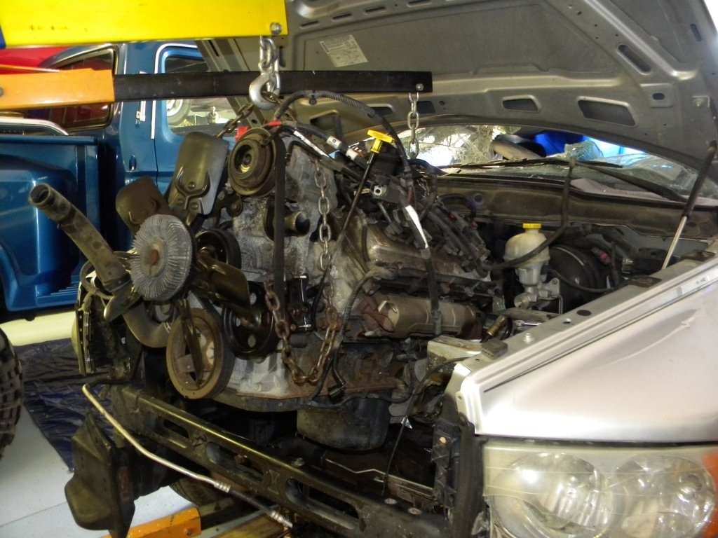

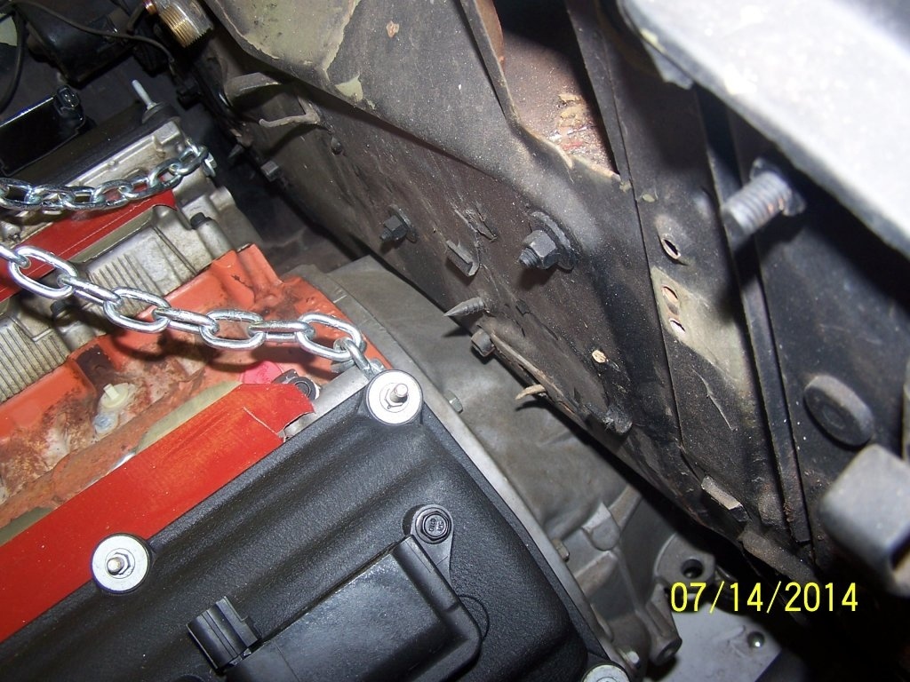

What are you guys using to pull the hemi engines out. I have several units for pulling different engines. But I cant see any place on this engine that looks like a good place to hook on. Not to mention that the engine sits back under the cowl and don't look like it could be picked up very far. I wanted to pull the engine and transmission in one unit but don't see that happening.

I'm not sure about the 5.7 but on the 6.1, you need to pull the intake. Mopar has a tool that mounts on two holes provided in the top of the block. I don't have that tool so I used some holes on each end of the heads.
Here are some pics. The green arrow show the mounting holes for the factory tool.
Kind of something I did not want to do but yeah sounds like I will have to do the same thing. At least the whole front end came off the truck so it is a straight shot out. Thanks for the help.

Maybe you can rig something up on the exhaust manifolds to pull the engine.
I made some plates that bolted where the intake was...used all 10 bolts and lifted from the center of the valley.

I didn't remove my intake on my 6.1. put a bolt on passenger side head and a bolt on driver side head (front and back). Lifted it several times test fitting.

My only issue seems to be how far back the engine sits under the cowl as far as getting it out of the truck.
Pull the radiator and fan, you'll have enough room at that point. The reason the V8's sit back is because of the Cummins diesel is longer than the V8's.
Must be different between the 6.1 and 5.7 mine has no holes in the heads. And it is so far back under the cowl I don't think that would work. I tried all day to figure out something. I cant even get my hand in to feel the top bell housing bolts. There up against the fire wall. So not even sure I can separate the transmission and engine. And I don't think there is any point on this engine strong enough to pick the engine and transmission together. Kind of stumped at this point.
Use a couple of straps to cradle the motor and you'll be fine.

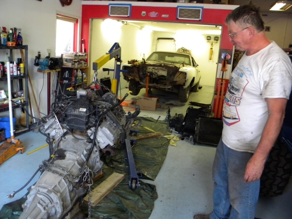

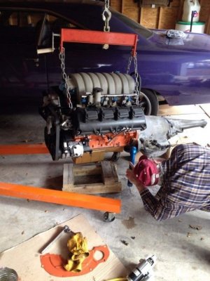

Well the deed is done. I got the engine out in one piece with transmission. But I have to say I have pulled countless engines in my 60 years. I have NEVER worked so hard to get one out. Now the fun can begin. Fitting and modifying to get it in the charger. I was told the 5.7 weighs less than the 440. But that massive transmission more than makes up the difference lol.
That extra weight of the trans will be low and in the center of the car, great for handling. The 5.7 does weigh less than a 440, almost as much as an all iron small block.
