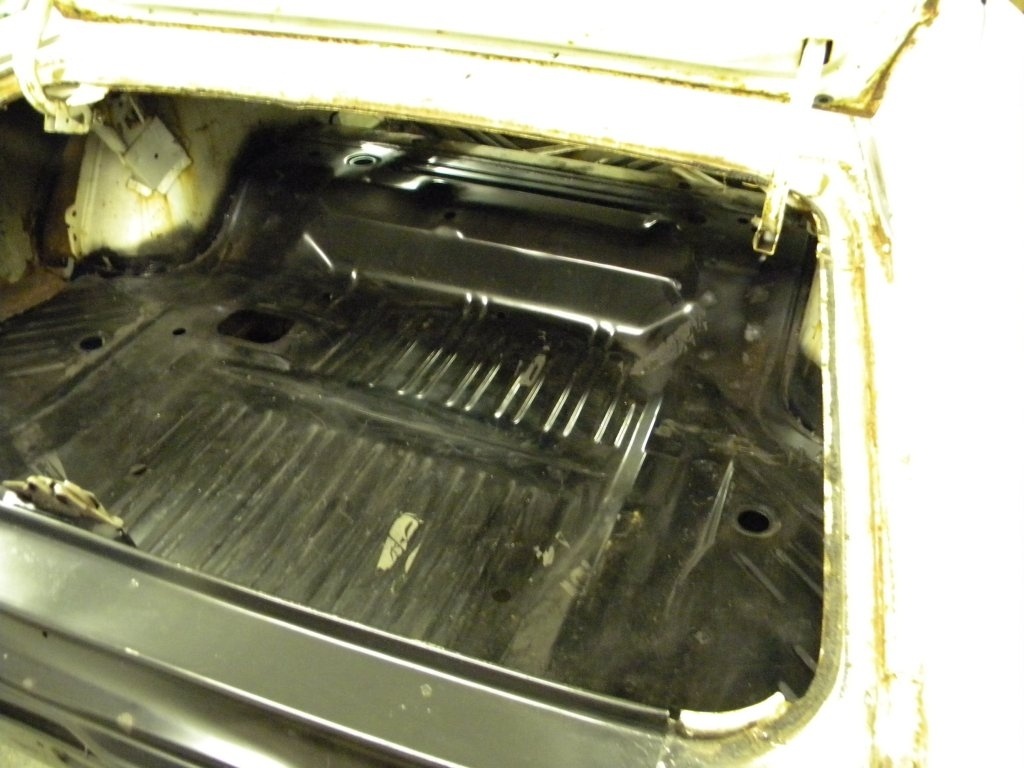

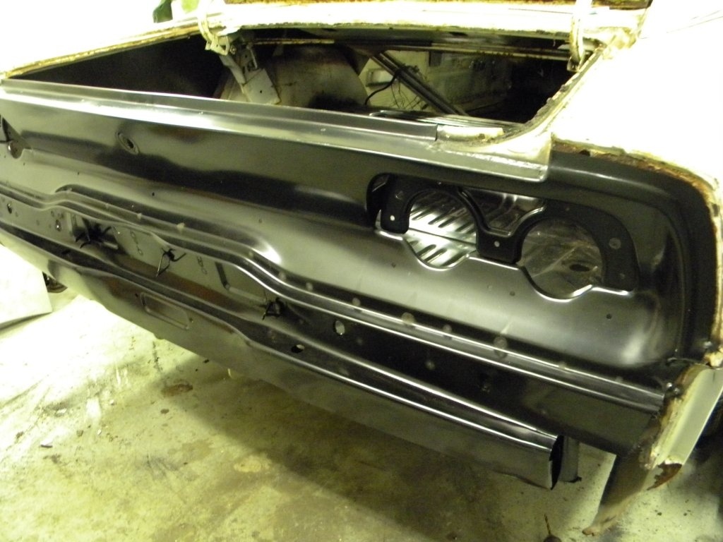

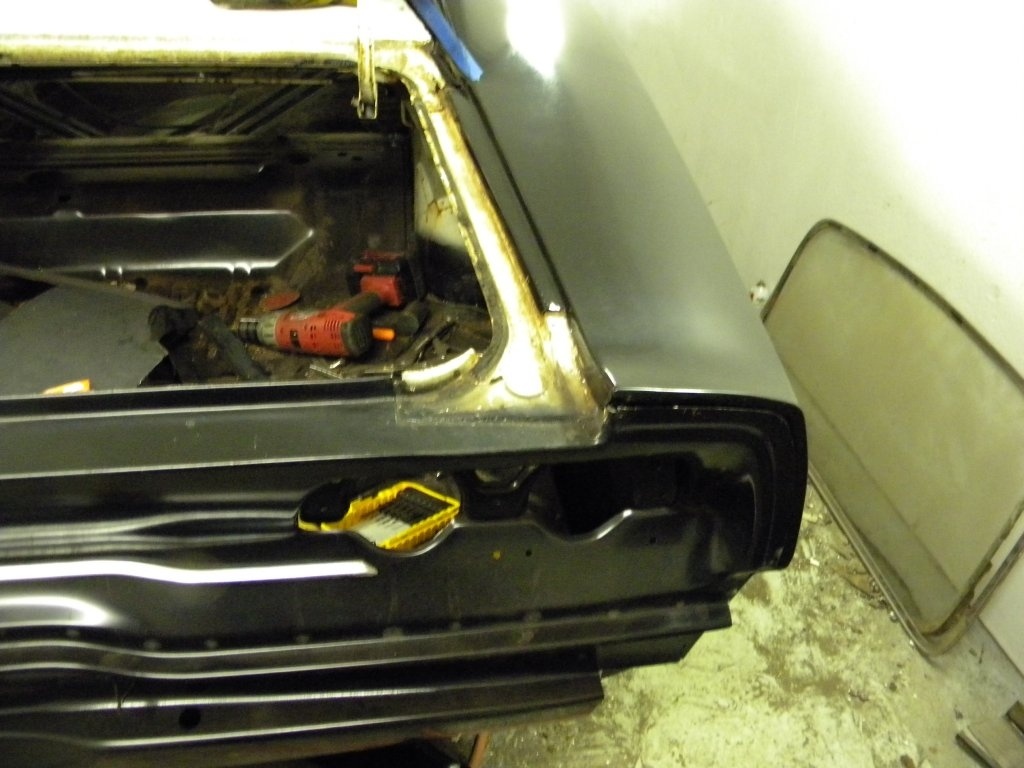

Another update on my build. I got the one piece trunk pan installed. Then the tail light panel using the original quarters to get everything lined up. Then installed the rear valance. Everything went well to this point. I have pre fit the right quarter with a lot of issues in fitment (as posted in the body work thread ) Just not sure how I am going to weld it to the Dutchman panel.

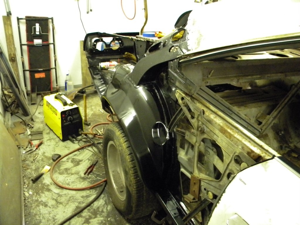

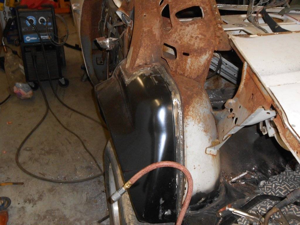

Well repaired the outer wheel house. I couldn't see how it could be done the way it is weaved in and out of other panels. So I bought one and cut it out as close to the top as I could and grafted the new one in to the old one.

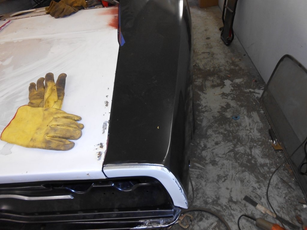

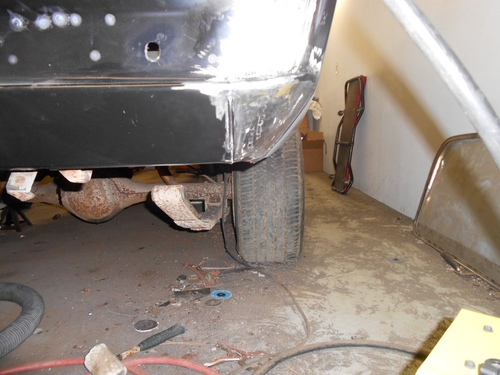

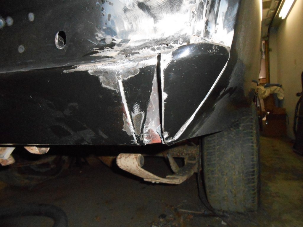

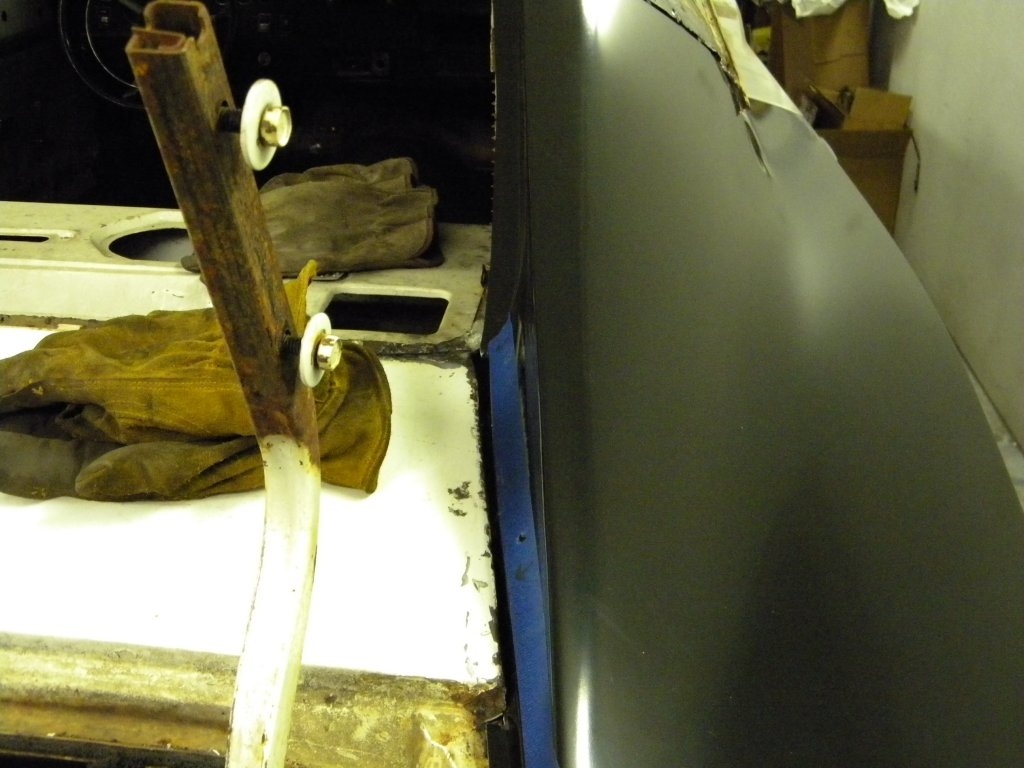

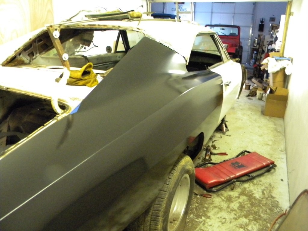

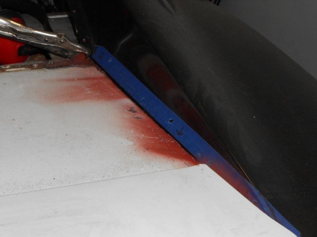

Worked today on fitting things before welding the quarter in solid. I got the Dutchman panel to fit much better. I got the trunk to line up very nice. The quarter extension gave me fits (I herd that it would with these AMD quarters) But I got it. And the valance end caps. WOW what a joke! I thought man I messed up some where bad. But after looking on the net I discovered what every one else has said. There JUNK! I had to cut it in half weld it to both sides and fill in the middle. But as long as the other side fits this lousy it will come out lol.
After a brief interlude I am back on the charger. Yesterday I cut off the drivers side quarter and replaced the outer wheel house on this side as well. Today GOD willing I will seal everything up and start fitting the quarter.
