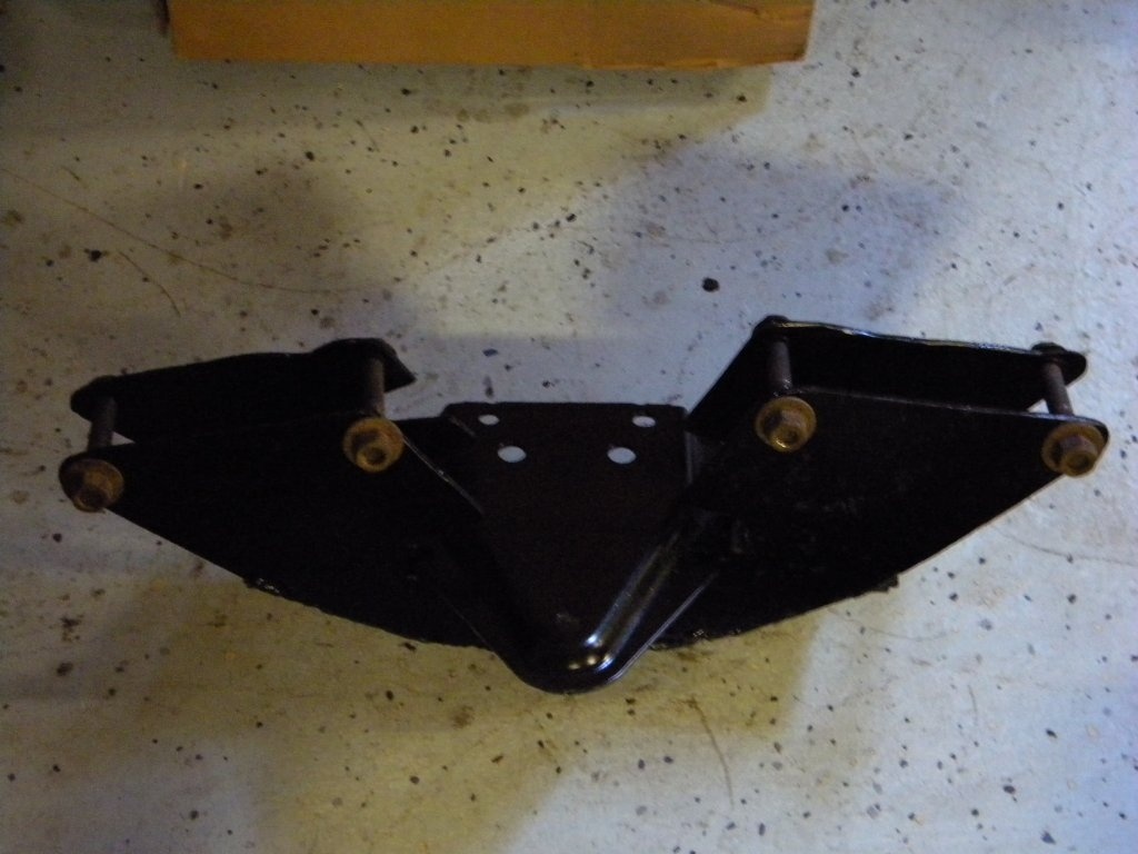

Well it has been a while but after moving my mother-in-law from eastern NE.to our house after her stroke (for good may the Lord help me) and removing everything from her apt. and a week of company I finally got back on my build again. I built my transmission mount using a combination of the truck mount and the original mount for the charger. So now I will unbolt everything and drop it out so I can start body work. Of which I have a lot of. I will post up pictures soon incase any one is interested in what I have done. But I have managed to install my 5.7 and 545 with the only cut being a small place for the one sensor on the drivers side of the transmission. My exhaust manifolds will work with out modification. I was able to use my original drive shaft with just changing the yoke for the transmission output shaft. My heat shield on the exhaust manifold just clears the steering sector. Still a long way to go but liking the fit so far.

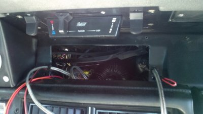

If you want AC and are not worried about original look under the dash check out Classic Auto Airs AC system. My Coronet was originally an AC car and their kit came with all the block off plates to install their system. CAAs kit comes with about a 10+inch smaller heater box which should give you plenty of room under the dash. The only thing I did not like about their kit was the routing of the AC lines on the drivers side. They come through a space in the core support and around the battery and across the engine to the passenger side. The original lines went up and over on the passenger side of the support. CAA has kits for B body Mopars with or without AC. Their kit also replaces your factory def/heater controller. It is a stand alone system and all it needs is a 12V source from the electrical system.

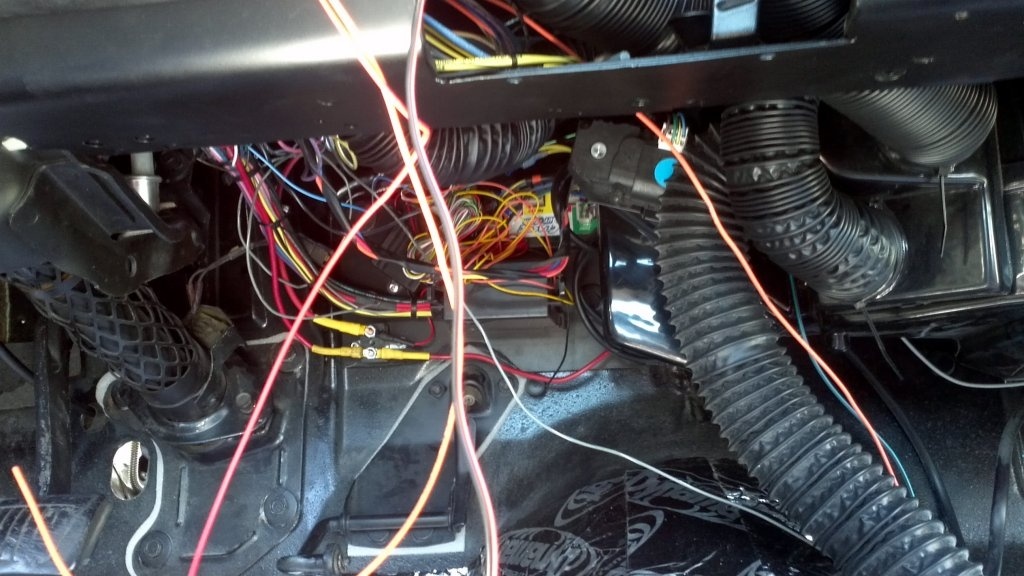

Don't mind the wiring mess. You can see how much shorter the heater box is. With the extra space I made a plate to mount the painless wiring fuse block, door popper control and circuit breakers for the door power, along with the AC controller (green and yellow thing). The kit also comes with all the ducting and the attachments to the vents.

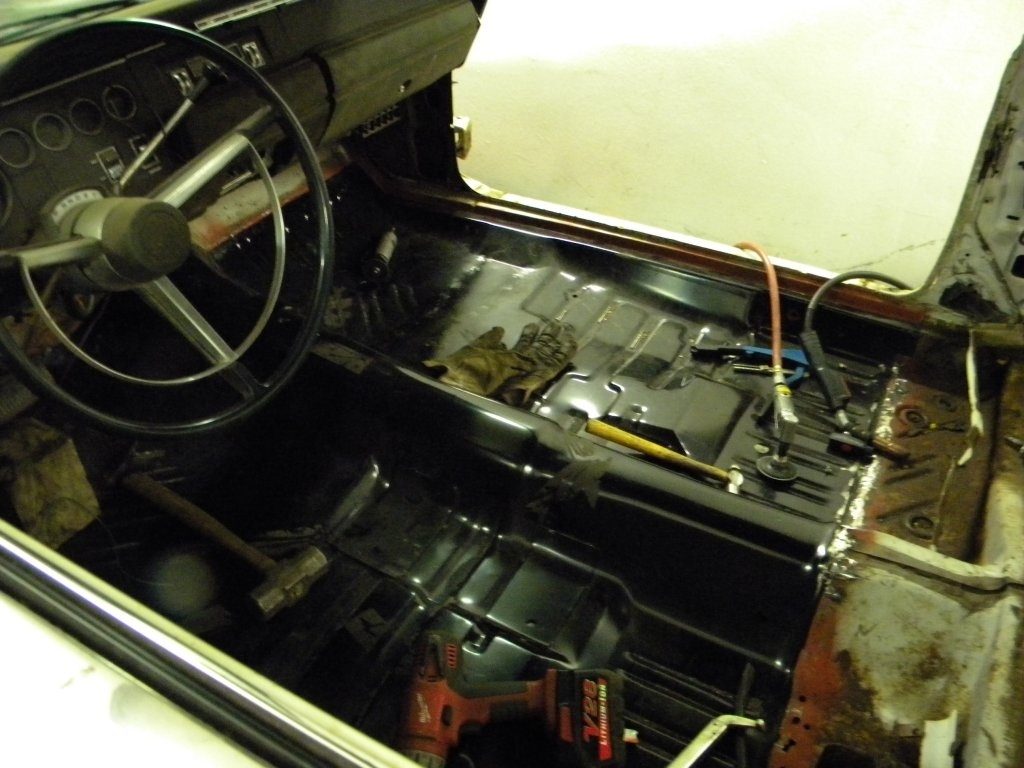

Well a bit of an update on my build. I finished up my transmission mount for the 545. It sits about 1 inch lower than the 747 did but it will work very well. My drive line is a little straighter than I like but will work. Also cut out the floor and installed a new TB cross member and now finishing up a new one piece floor. Will post pictures of motor mounts I made after I get the finishing touches on them.

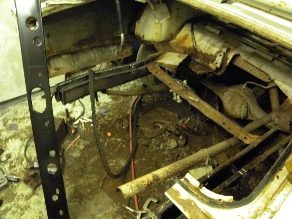

Well OK haven't posted up anything on my build in a while. And the reason is it has been slow going. I knew I had rust in the trunk pan. And like the floor pan I wanted a one piece instead of patches. I started by removing the rear valance because I suspected a little rust. Well turns out someone was one heck of a sculpture. This thing was all bondo over screen. After that I noticed a couple pin holes in my tail light panel. And I started cutting out rusted metal and well....this is where I am at now. But the good news is I am seeing real steel now. So I think I am about ready to start installing new parts. Of coarse when I finish this I still have to replace both rear
quarters. I just have to finish cutting out the rest of the trunk pan clean up the frame rust protect and start putting it back together. Did I mention how bad I hate welding lol. Also both rear spring hangers were all but non existent.
