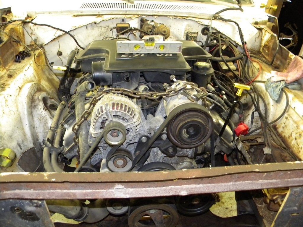

Well over the past couple of days I got my engine towers made to use stock 440 mounts. I have the engine bolted in and it looks like it will work out fine. I brought the engine about 3 inches forward and the stock exhaust manifolds will work with plenty of room. It clears the power steering sector by a small margin and my stock drive line will fit (using the 545 front yoke) I wont have to cut the TB cross member but will have to trim it where the fins are touching it and a small piece of the floor on the drivers side for a sensor that hits the tunnel. I still have a ways to go before I am satisfied but over all things are looking good. I haven't made my transmission mount as of yet but it looks like I can use the stock mount with a few modifications. I will post pictures later today.

I guess there are many ways to skin a particular cat huh? I am guessing the 3" forward may cause some issues with the radiator and fan but I'm sure you will get it handled. Good luck
I am going to get rid of the truck fan and there is plenty of room for the radiator and dual electric fans. I have about 5 inches in front of the pulleys to work with.

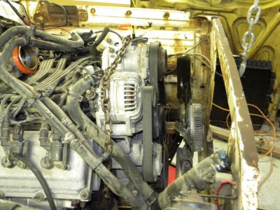

The engine is in and now I need to work on the transmission mount. Truck fan wont work but was going with e
Everything is bolted in place now. Still doing some finial fitting on the transmission mount. Drive shaft fit perfect. Will soon be taking it all back out for power coating and cleaning. Engine will get cleaned painted and some new gaskets. Then on to body work for the car.
