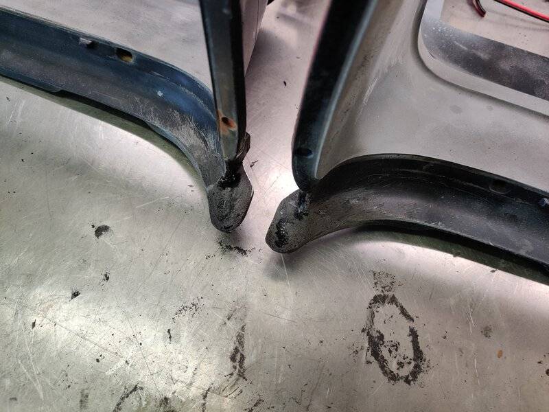

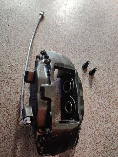

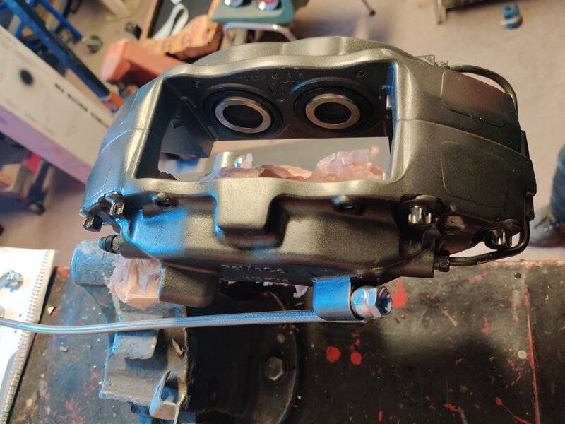

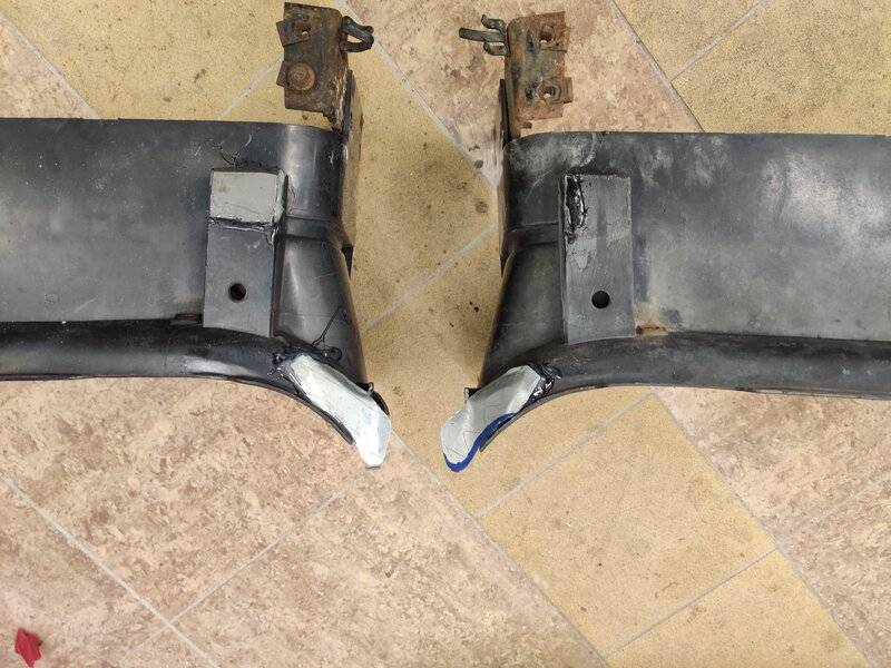

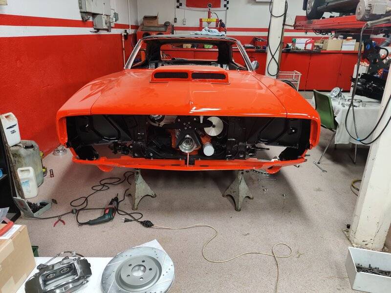

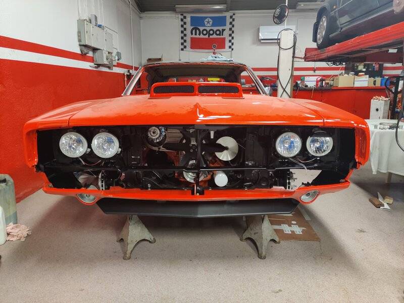

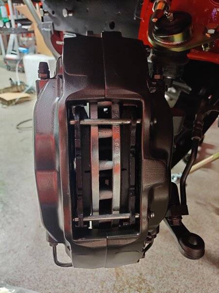

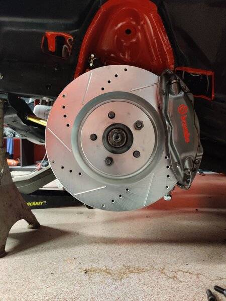

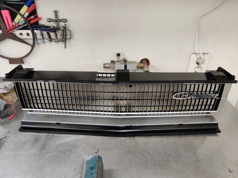

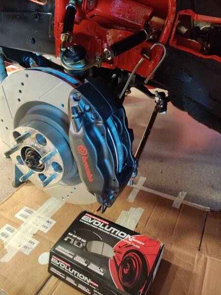

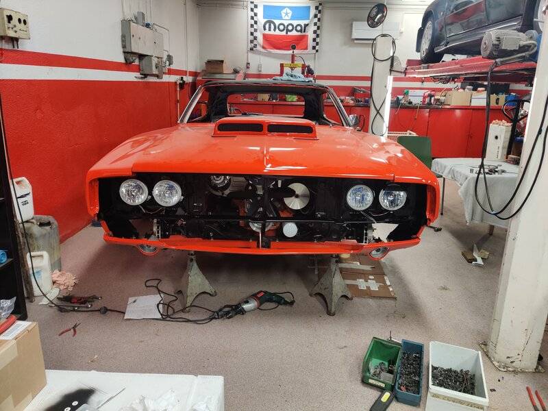

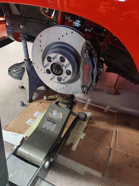

Messy day today at the workshop but something got done atleast. Fitted and adjust the front valance. Had to drill up the bolt holes to 16mm on the Mustang rotors since the wheel studs splines sticks out some of the hubs.

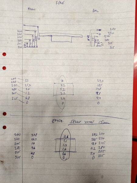

Checked the offset and it's spot on. Don't need any shimming.

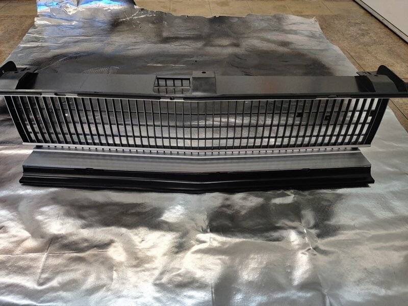

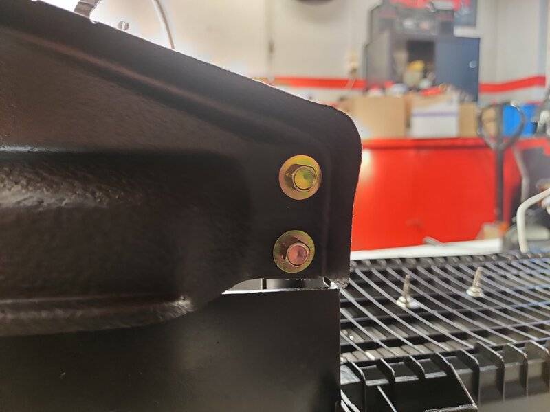

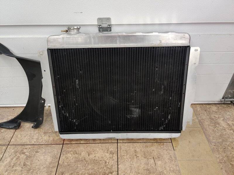

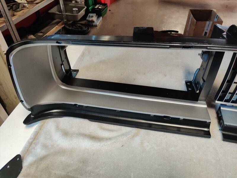

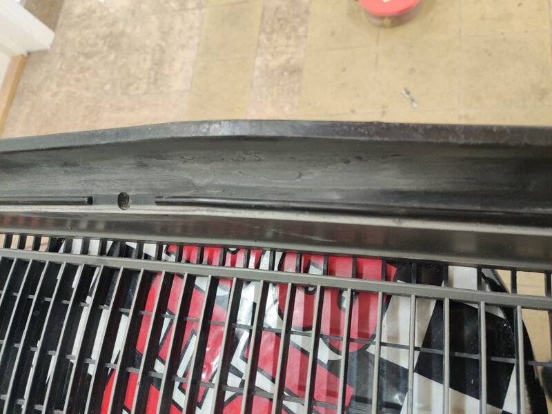

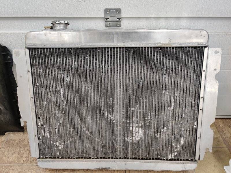

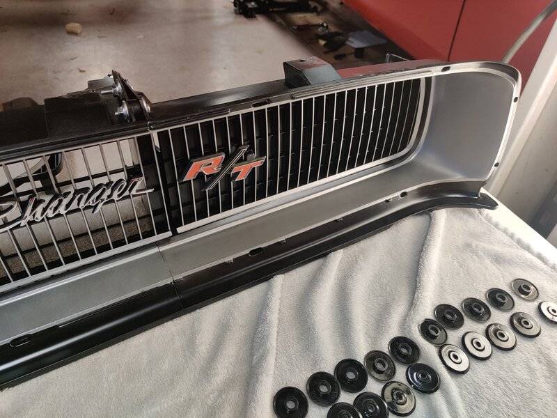

Blacked out the radiator when I got home. Don't like to see the bright alu through the grille.
