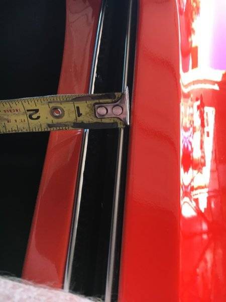

Hey Jim,
Your Coronet looks fantastic. I also have a '68 Coronet I am working on. I am many man hours behind you, but I have a big favor/question to ask. Here goes:

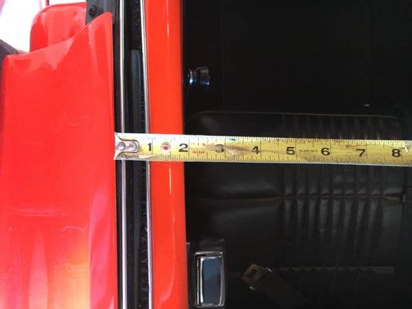

Before removing the quarters on my '68 B body, I measured a key gap on both sides of the car. The gap to which I refer is the "slot" that the quarter window slides through - between the top edge of the quarter panel and the inner panel that the window regulator bolts to. I had already removed all of the fuzzies, seals, and the quarter window mechanism because the car is stripped down to a shell.
Here's my issue - I measured a gap of 1 5/8" on one side and 2" on the other. Now there was some rust where the quarter met the door lock pillar, so this area is on shifting sand so to speak. When I install the new quarters I want to get these gaps right, so at this point I don't know what to shoot for.
Can you take a measurement of this gap? I just need the horizontal gap between the surfaces where the inner and outer fuzzies/seals are mounted.
Thanks a lot!

I can give you a photo of what it is with the fuzzies and inner panel on. Will that help? You could buy the fuzzies and line it up with the inter panel and fuzzies on the car to match mine. That is what you really are shooting for anyway.

Jim,

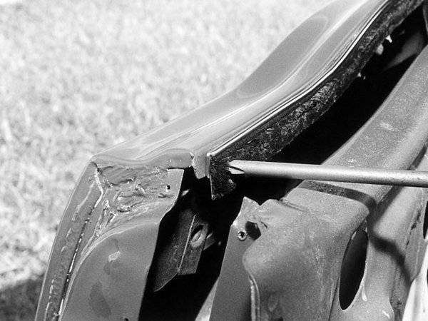

No need to even bother with a photo - all I really need is a measurement. Just the gap, steel to steel, that the quarter glass rides in. See photo below (not a mopar):
Anything you can provide would help. Thanks again.

Jim it always warms my heart to see a well-used tape measure( must be US made as it's not broken!)

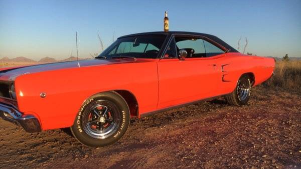

I am beat. Went to my auto paint store in Sierra Vista and bought all the goodies to polish stainless and chrome. It is a 3 stage process. Can’t hold my arms up any more after running the polishing wheels three times in all the trim. Also put the rocker trim on the correct sides. Duh.
Took it for a Rum Run. I needed it but boy is it shiny!
