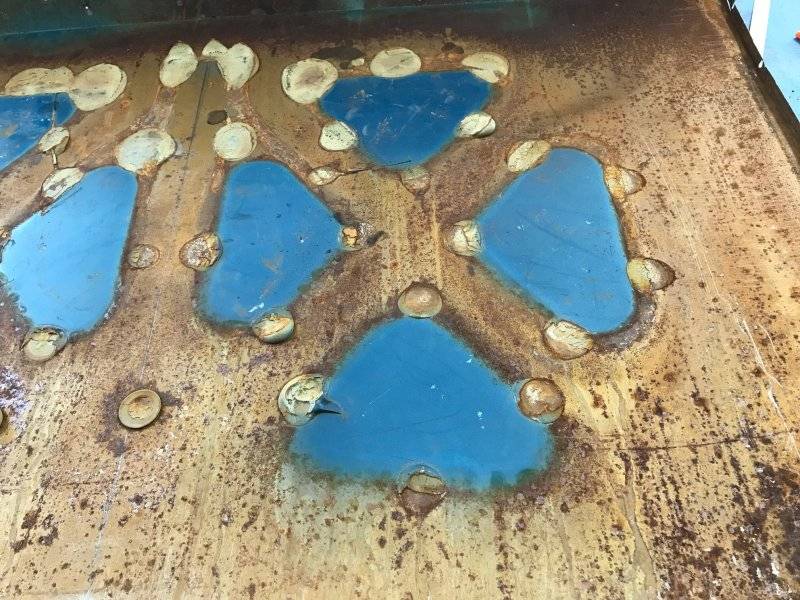

Took a picture of the adhesive locations for reference. Also drew a pencil line down the center and took measurements for the globs that weren't close to the open areas.
I used a propane torch with Mapp Gas and a chisel to remove the gobs of adhesive. Just warmed enough to soften, only a couple of seconds, and then scraped it off.
Then I used a hammer and dolly to straighten the edges and remove the dents.
Next I did a test fit to make sure it would go back together properly.

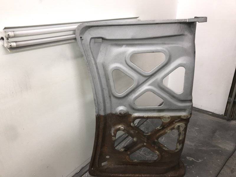

Back apart now for media blasting and then two coats of epoxy primer.

Started media blasting the frame today. The colder temperatures kept causing condensation on the inside of the plastic view port. It was very slow going, having to stop and dry the thing off every couple of minutes.
Rain in the forecast for tomorrow, so I may need to wait a while longer before getting back at it.

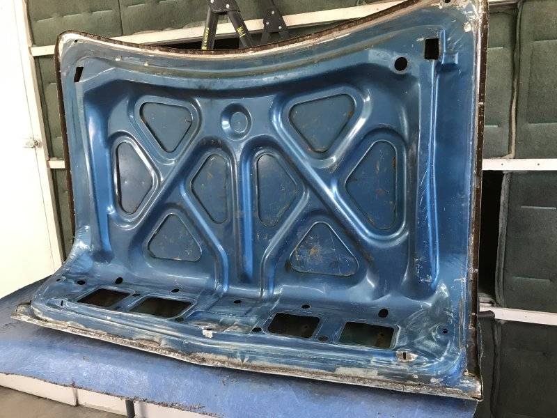

Got it reassembled today and letting it sit 24 hours for the NVH-60 to cure.
Gonna be a high electric bill since I have to keep the booth above 60 degrees for the next 24 hours. Tonight's low is 13 degrees and tomorrow's high only 46 degrees. My little space heater will be working overtime.

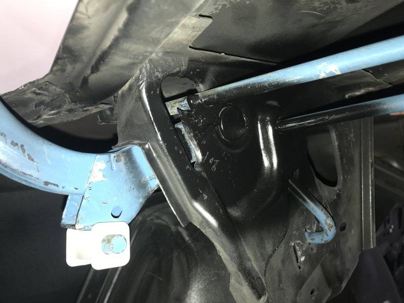

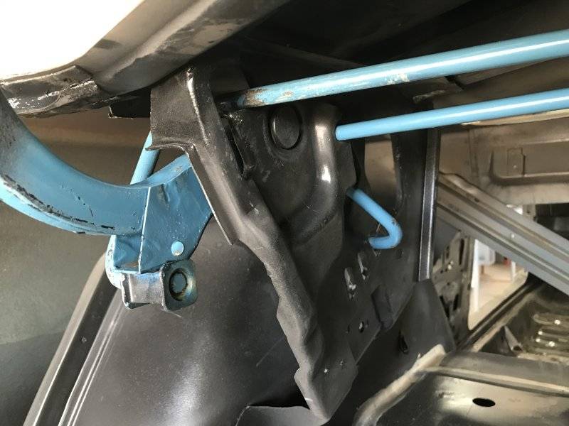

Needing some help with the deck lid torsion bars.
Decided to install the deck lid to check the fit. Problem I am having is the when I close the trunk lid, these bars make a very loud "pop" sound. I even put a dab of grease between the plastic bushing and cam surface.
If I raise the lid to full open, these will actually come loose and fall out of their slots.
Is this because I don't have enough tension on them??
I have a very short video recording of the hinge during the popping sound but don't know how to upload it.
Okay, I finally got this problem solved.
Basically, the issue is the top portion of the slots that the bars ride in. They are supposed to retain the bar at the farthest forward position but because they were worn and slightly deformed the bars would slide toward the rear of the car with a loud "pop" and drop down enough for the hinge to slip by.
I tried getting one of the slots back into original shape, as best I could, and it solved the problem temporarily. Unfortunately the metal is too weak now to hold it's shape.
The solution was to cut a thick 3/8" diameter washer in half and tack weld it into place under each rod while held in the forward position. This creates a cradle for the bar to rest in and it worked so well that I could even increase the tension on the rods with no popping or slippage.
The tensions bars can still be removed when necessary just as before
I will try to post a photo a bit later.
Today I got some epoxy primer applied to the underside of the trunk lid.
Once it cures some, I will apply seam sealer to all the edges where the metal is folded over and then shoot another coat of epoxy primer before moving to the top side.

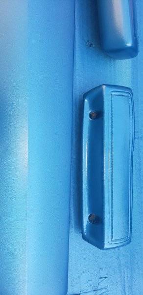

I would agree with you based upon what I have seen in my research. The Kick Panels, dash metal and A-pillar covers looks to be the same.
You would be correct Mario! The only thing that I found on my car is the Dash pads and the console are
a Turquoise shade as seen in the pics. Also, the arm rests are turquoise. Go figure!
