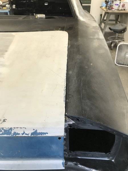

I had some serious issues getting the trunk lid to even fit in the opening.
There was plenty of clearance at the front but the back was tight on the left side and overlapping a bit on the right side.
Had to drill out the spot welds holding the quarter panels and push each side out 1/8" to even get the lid to fit.
Here's the side that was overlapped at the rear now able to fit.
Found the only way to adjust the hinges is to bend them.
Being a bit fearful about cranking too hard on them, I just did a little at a time.
Here you can see that I need to adjust the hinges a bit more to the left. That should square things up.
Still a bit more adjusting to do as well, however I am close. Now to try to get rid of that popping sound when I open and close the lid.

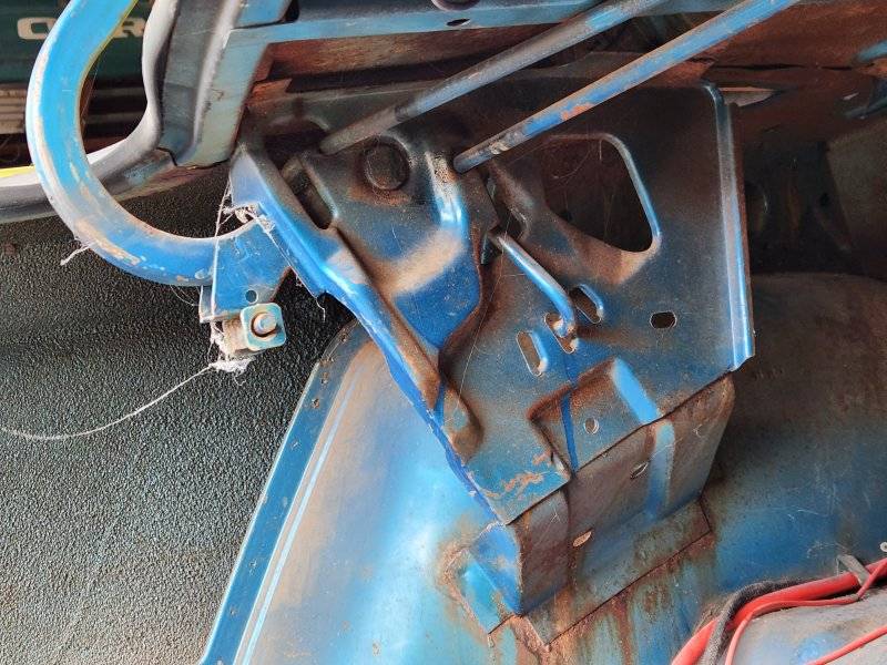

I need some serious help diagnosing what's wrong with my torsion bars. They hold the lid open but when I go to close it, there is some seriously loud popping as the front portion of the torsion bar slide about half an inch slamming into the back of the slot.
I tried increasing the pressure by moving the rearward most slot on the adjusting end. Didn't help and actually caused the bars to slip too far forward and pop off the hinge cam, thus shattering my plastic bushings.
Here's a pic before I disassembled the car:
Here's a pic of where I am now:
What am I not seeing?
Stupid question, may not matter anyway, but did you happen to switch them from side to side?
When you look at this picture, right next to the little wasp's nest, how that the torsion bar is sitting in a recessed area of the slot that looks like a backwards 7.
For some reason my torsion bars will not stay in that position but jump toward the rear of the car and fall down into the slot.
Does anyone have a picture of that recessed area? I am wondering if mine are worn out or distorted.
I have a ‘71 so it might be a little different, do you have the captive washer on the pins that holds the arms that connects to the lid (if that makes sense). The pins that the lid support arms pivots on. I just reinstalled mine to fit trunk to quarters and found that if the arms have a lot of play on that pivot pin, it messes with everything. When I took mine of the first time, these washers went flying off into the depths of my quarters...thank god my car is on a rotisserie, a quick turn to upside down and they fell out...phew!
I just checked the recessed area in question on my 57,000 mile '69 GTX, and it looks identical to the picture before disassembly, functions perfectly. I think the previous post may have answered the question. I had a problem with play in the arms on my '66 Imperial when it passed 130,000 miles. I Mcgivered it with a pair of vice grips, and sold the car a year later.

Come to think of it, I have had to push those locking washers on to the arms repeatedly to reduce the play in the in arms. I'll start there and then if necessary work on the recess areas.
I will let you know when or whether I have resolved the issue.

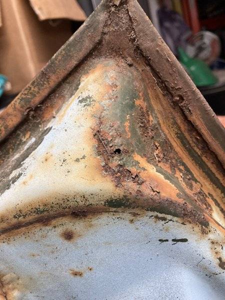

Well I got the skin off the frame today. Never found any spot welds but there sure was a lot of rust.
Glad I opted to remove the skin as this was rusted way worse than I originally thought.
I was amazed at how well the adhesive/sealant was still holding after all these years.
Now to get it all rust free and epoxy primed, then put back together.
