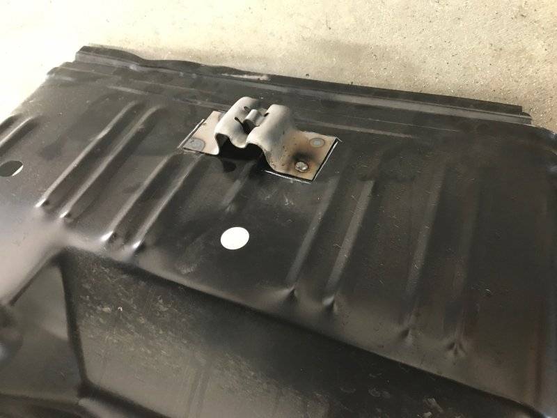

Waiting for my epoxy primer order to get here, so I decided to start transferring parts from the old pan to the new one.
Media blasted and then painted the underside of the seat belt nut supports and emergency brake cable guide and welded them in to place.

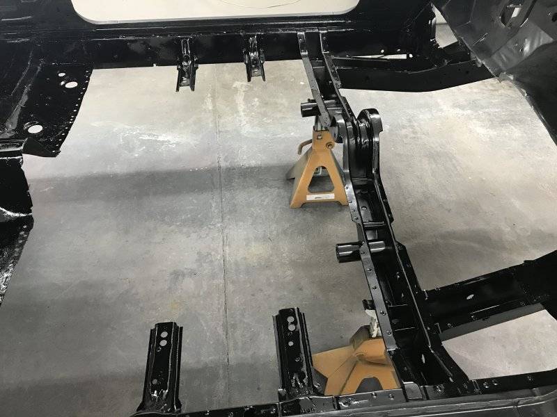

Got the floor supports media blasted and spray with two coats of epoxy primer today.
Should be able to start floor pan install on Saturday.
This time I blasted it where it sits.
Cleaned up the mess. Took longer to clean everything, including inside the frame rails, than it did to blast and paint it.

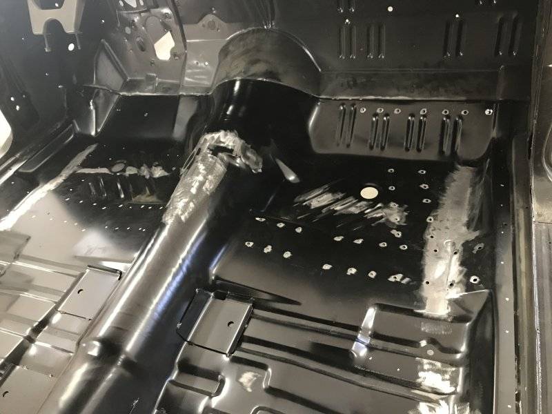

Floor pan is in.
Gave it one coat of epoxy for now. I will put the seam sealer on and then shoot another coat.

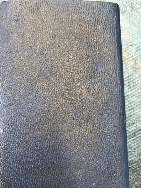

While waiting for my seam sealer, sandpaper and filler order to arrive, I decided to look at my console.
It has 3 series cracks in it, which I super glued to close them up. However there are chunks missing and the edges of the seams have some wear so show.
My current plan is to mix up some JB Weld clear epoxy. Then use a toothpick to fill and level the seams. Once the epoxy begins to set, press a piece of vinyl cloth into it in order to create a texture similar to the surrounding areas.

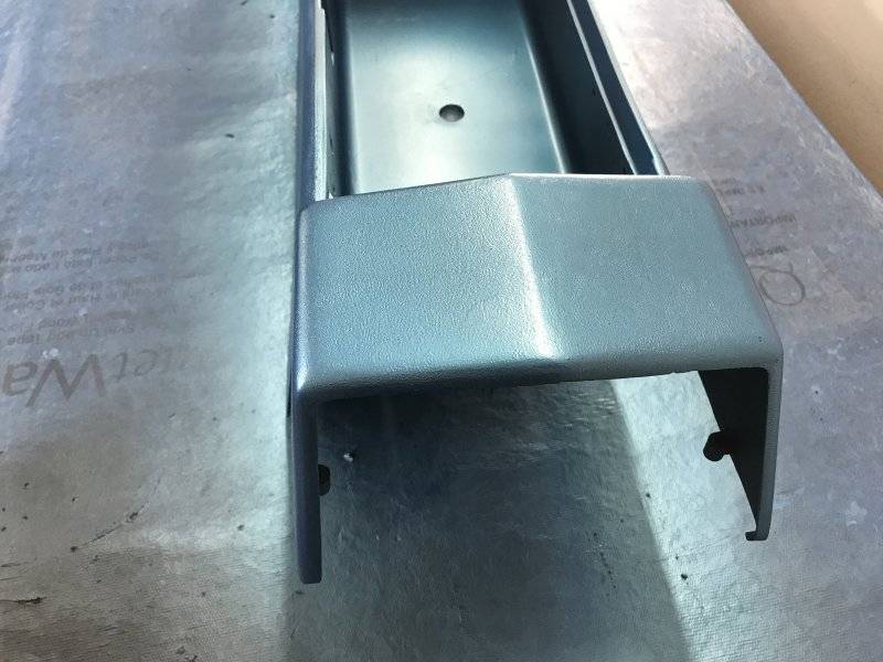

So here's what I got.
Had to change up the game plan a couple of times but it came out pretty decent.
Not perfect but I doubt most people will notice.
Looks great! Is that black?
No, was a darker blue and very beat up and old.
What I ended up doing was to use Plastik Honey to get some filler real slick and then just skimmed over the bad areas.
Sanded that with 150 grit and applied two coats of SPI black epoxy, reduced about 20%. Once it started to firm up I pressed the texture into the surface and then let it cure out for an hour or more.
I found an old Spanish New Testament sitting underneath a bunch of stuff and it had a vinyl cover with texture that was almost a perfect match.
I then mixed my Q code base for interior use (Mixed 1:1 and 10% clear activator added) and sprayed three coats. This mix doesn't need clear over the top. Works great on dash pads, arm rests, kick panels, etc.
