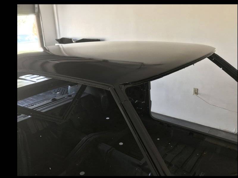

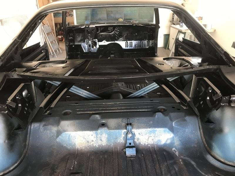

Prepped and sprayed epoxy primer on the roof skin, drip rails, underside of package tray and the rear deck supports today.
Tried using the DeVilbiss DeKups for the first time today. They were perfect for spraying the underside of the package tray and the rear deck supports.
It did seem as though I needed to up the air pressure from where I normally set it. Anyone have experience with these things?
New roof skins and rear deck pans do not have the factory nubs for the moulding clips, so, what is the preferred method to installing them, pop rivets or small screws. Great metal work, really coming along.

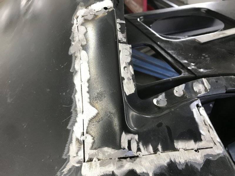

So I went to work on the lower left corner:
I had to round the right side to form a mating surface for the rear deck panel.
Getting it tack welded into place.

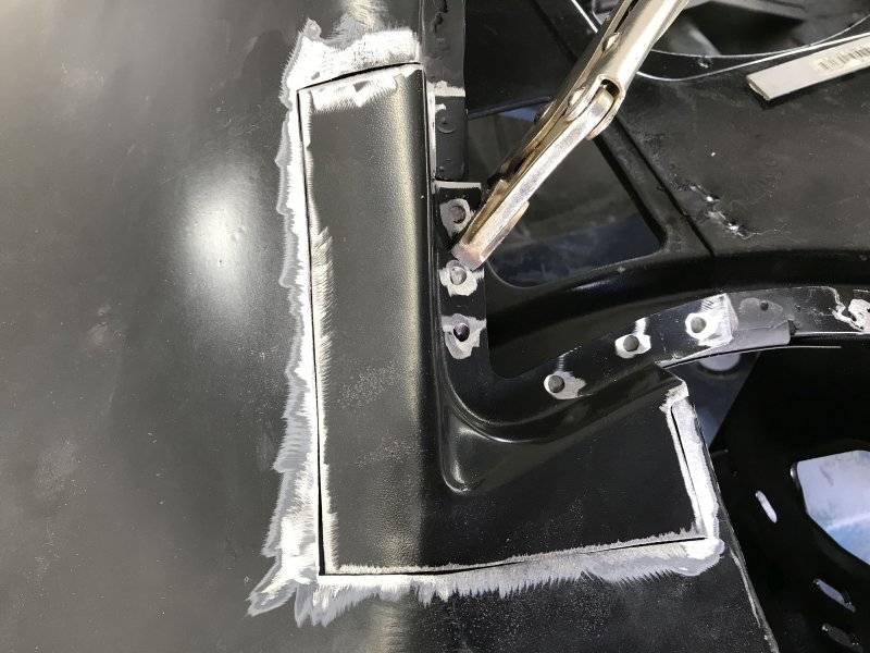

Installed the lower right window corner.

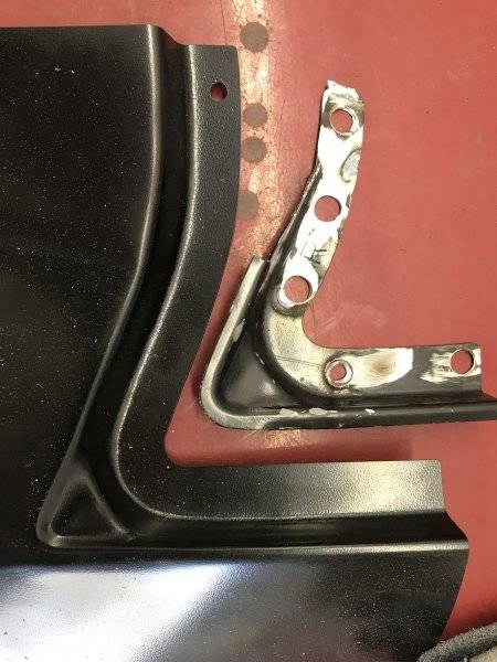

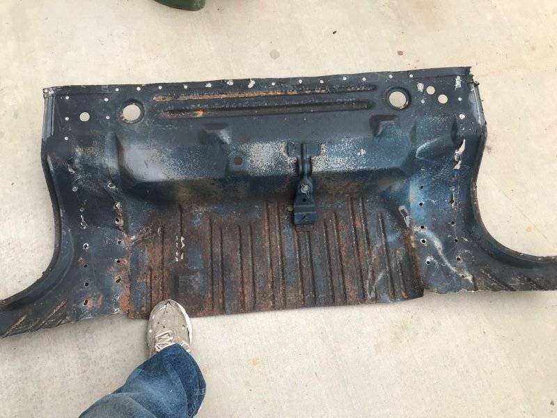

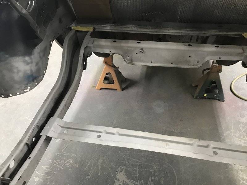

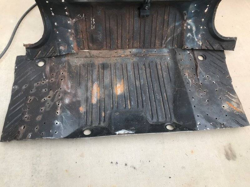

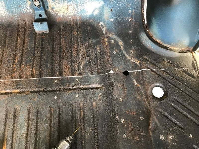

Decided it would be better to replace the trunk floor now, with the filler panel not installed.
After drill spot welds out, I cut the floor in front of the cross brace so I could remove the front section.
It was a fight but got the front section out, then tackled the rear portion.
Still need to clean it up, hammer and dolly the edges straight for welding, then get it all in epoxy primer.
Measured the location of the pieces I will need to transfer to the new floor pan.

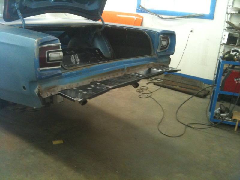

I am wanting to put this trunk floor pan in without cutting it. However the only way I have found is by a guy who removed the rear cross brace.
Here's a some pictures of what he does:
Looking at removing the rear cross bracing, I found it is spot welded to nearly everything, including the inside of the trunk floor extensions.
This seems like way too much work to me and a risk of distorting the tail panel as well.
One thought I had was to drill the spot weld holes and then cut a seem through the holes that run front to back on the frame rail. This would allow me to install the panel and have some metal backing for welding the seam.
Any other ideas on how to install the one piece floor pan without having to cut it? I will cut it like I described if I have to.

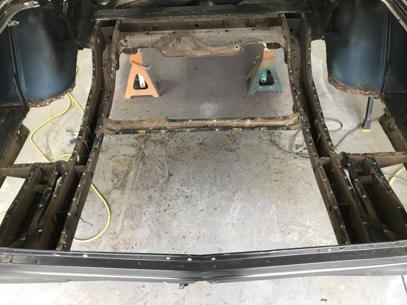

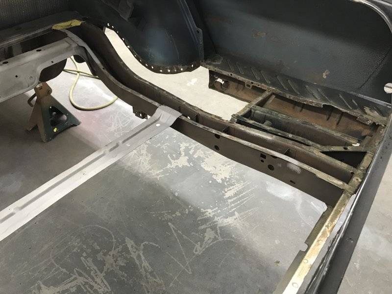

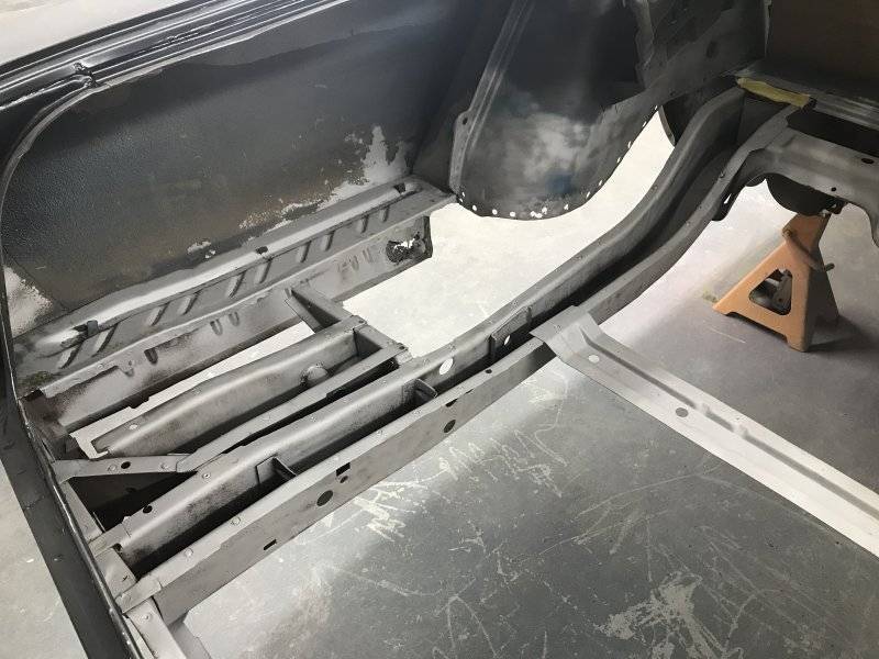

Started media blasting the frame rails and trunk supports today.
Hot and dirty work, especially with the monsoon rains here in Arizona.
Got tired so still more to do.
My goal is to get the worst of it the first time through and then go back and make sure I got all the rust. Clean it up and apply some epoxy primer.

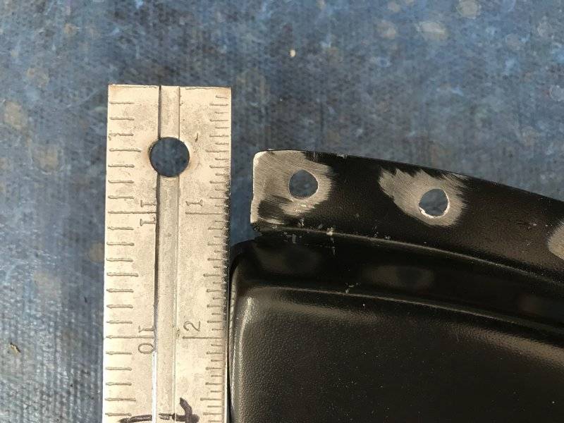

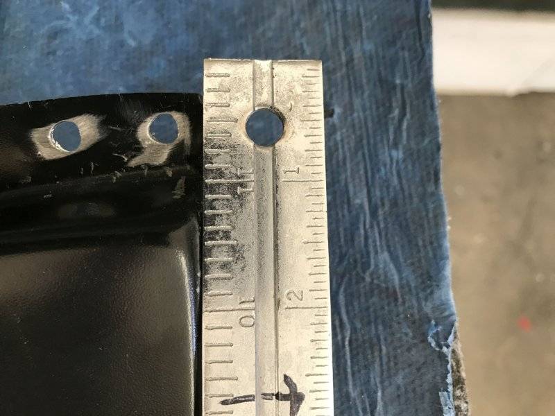

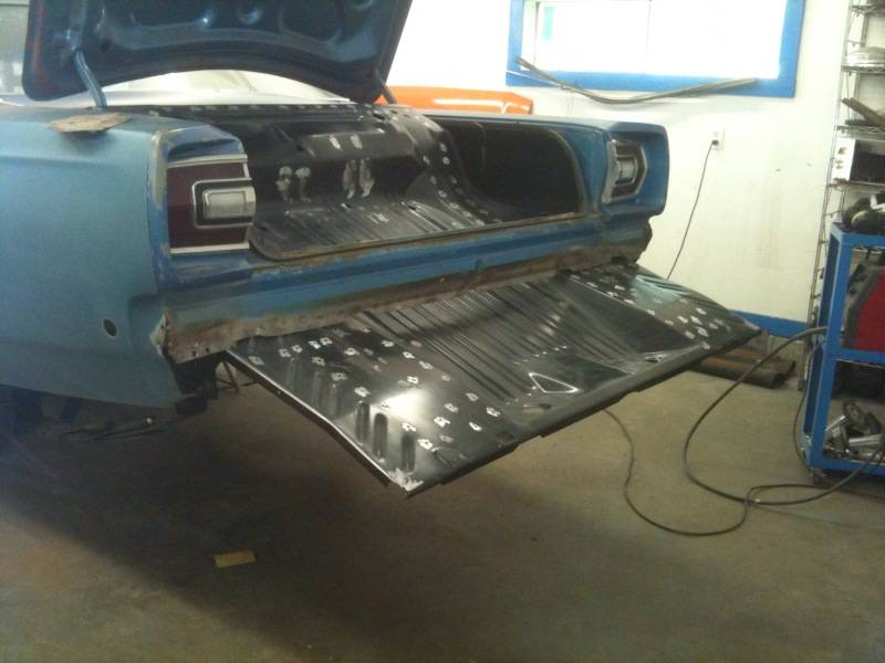

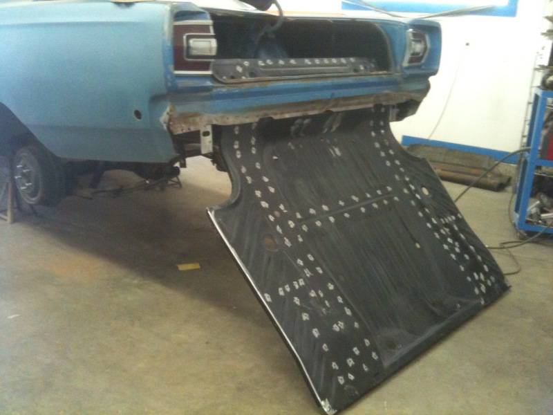

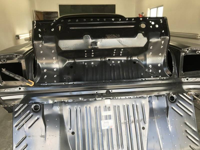

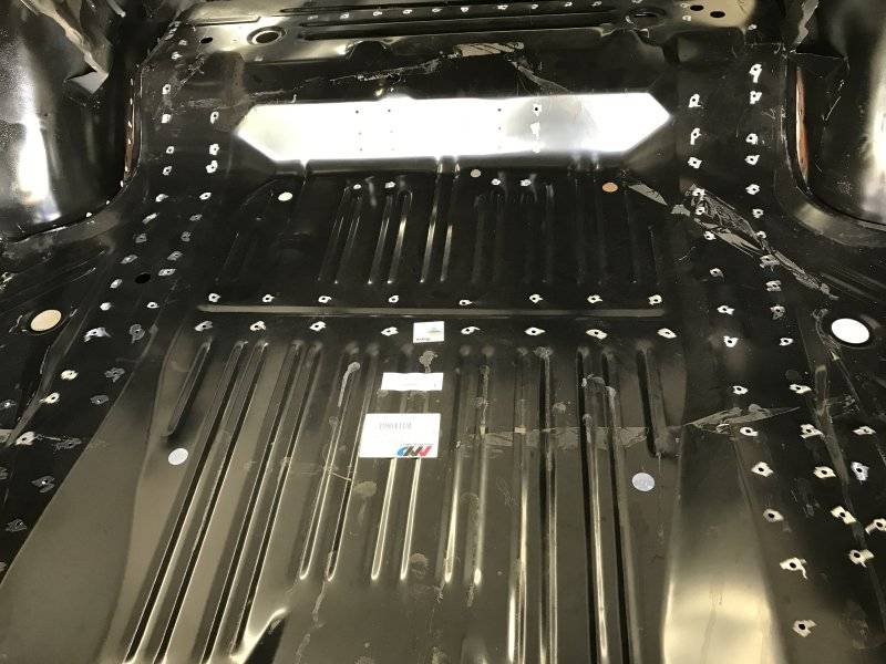

Got the floor pan installed today in one piece. Not going to say it was easy but I did learn a few things during the process.
First, you need to drill out all of the spot welds along the bottom and sides of the tail panel. You will be bending this out quite a bit to be able to maneuver the floor pan into place. I actually used a couple of 2x4 pieces to help hold the gap wide enough to get the front edge of the floor pan under it.
Second, you need to have the rear of the car elevated high enough to start the lip of the pan up under the tail panel. I was able to do this on the jack stands by raising them up about 6".
Next, be sure you have all your holes drilled and cleaned on both side, especially where they weld to the trunk floor extensions.
Here's where I got to when I realized I hadn't drill all the holes in the floor pan yet. Fortunately I was able to drill them with the panel in this position. Notice that I clamped it in place while drilling.
The next step was the most difficult as it required bending the tail panel out quite a bit. I had been trying not to bend it any farther than necessary but it became obvious after a few minutes struggle that things weren't going to work out the way I was doing it.
Working by myself, I had to bend one side of the tail panel out while pushing the panel up an inch or two, then do the same on the other side.
In this next photo, I had it inserted just far enough to clear the rear deck supports and it is resting against the trunk lid hinge brackets.
From this point I had to push on the floor pan with my legs, while lifting the tail panel high enough to let it slide forward.

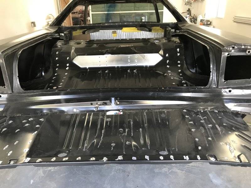

Here it is fully resting in place. Look at all those spots welds I have to make.
Here's the tail panel after installation:
I carefully bent it back down and then working from the center to each outside edge, I would use vise grips and a body hammer to slowly put it back into place.
I will get the trunk floor all welded in and then concentrate on getting the tail panel as nice as possible.

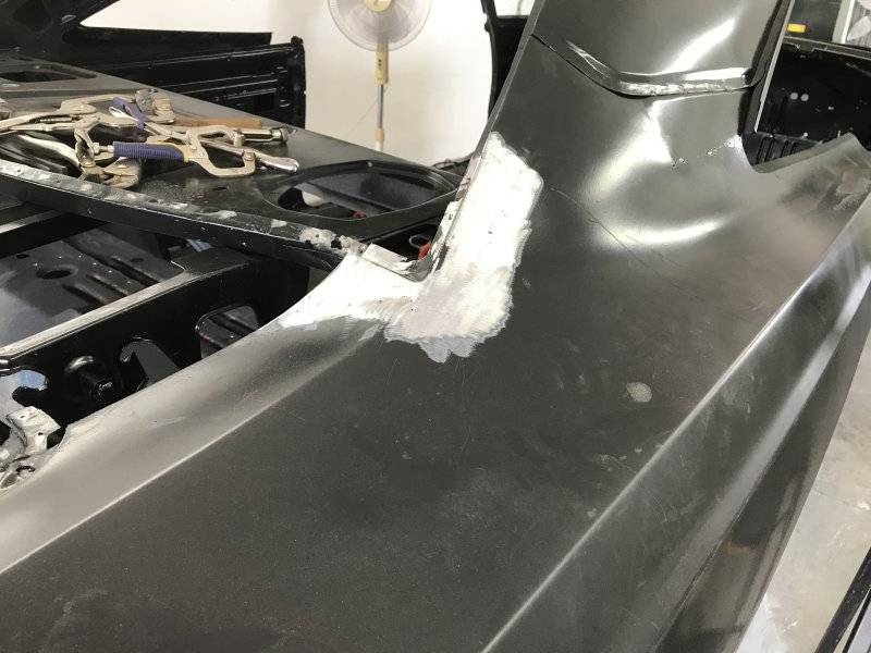

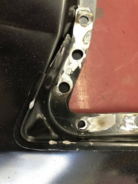

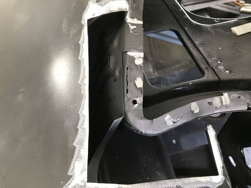

Just an FYI. When doing the roof skin, I found one of the support rail corners hadn't been welded from the factory.
Yesterday I discovered the same thing on the left hinge support brackets for the trunk lid where it attaches to the rear window support area. There were two places that looked like spot welds but had never fully penetrated and bonded with the rear of the bracket. The other side was welded solidly in those two spots.
After taking several measurements I found it was nearly 1/2" out of position. The trunk lid spring rods and the welds at the rear of the bracket on the deck filler panel were all that was holding it in place.
