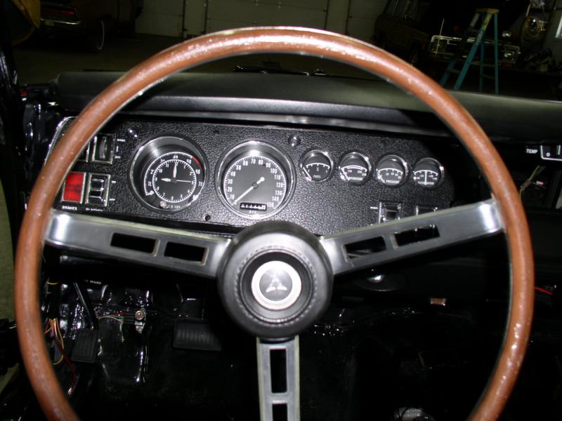

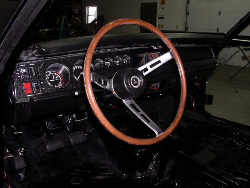

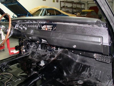

Piece by piece it's all coming together. It has been a long time since a dash has been bolted in this car, and I must say it looks a lot better than when I bought the car.
good lord H2E that looks stunning. someday i will see this car in person. its just awesome. imo
That dash does look good sitting in there like everybody has said. The steering wheel really catches my eye.
It does kinda stand out doesn't it? There sure is a lot of black on this car, the wood almost looks out of place lol.

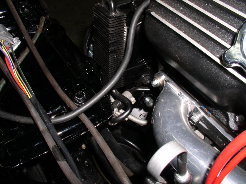

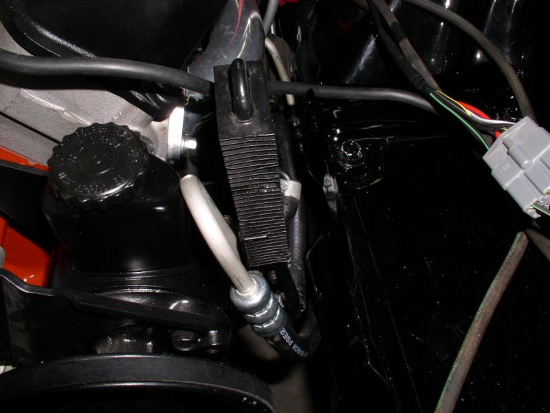

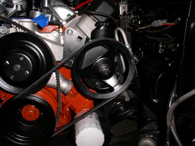

Been working on the engine compartment some and am doing as much as possible before I bolt the front end together. Looks like Speedy and myself are at the same stage so some may be almost duplicates of his build. I ended up having to use a 1" shorter belt on the power steering pump on account of the cooler. The lines from this were bumping into the vacuum canister with the called for belt.

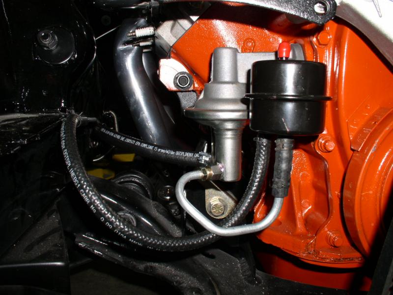

I also used the factory style fuel separator, but don't think I would if I had to do it over again. I originally had a pump for a 69. It had a 5/16" inlet and a 1/8-27 outlet thread. After receiving the hard line set, I found out that the threads on the short line was 1/2-20. So after a little research, I found that a 1970 pump has the correct outlet threads for the short line, and as a bonus the inlet is 3/8 which matches my fuel line to the tank. I had quite a time getting the bends correct on the short line, but it turned out great in the end. I just have to make a line going up to my Holley and the fuel lines will be done.

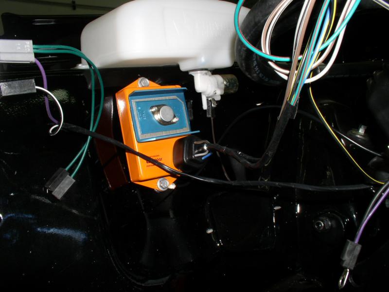

I found a spot for the control box that was out of the way and for extra peace of mind made up a #10 ground jumper from this to the block. I am waiting for the engine side tach wire which I apparently forgot to order with the rest of my harness'. Once that comes I will be able to wrap everything up neatly.
