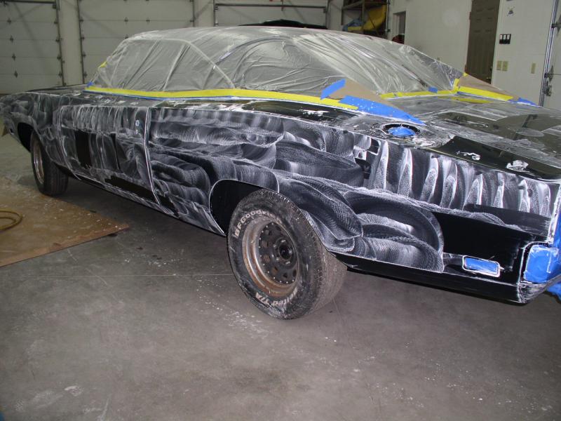

Here's how black beauty is going to bed tonight. After talking to several other body guys, we learned that the Martin Senour as well as some PPG clears turn to the hardness of cement after about 4 days. This 4 day window is when wet sanding and buffing should be done in a perfect world. So it was recommended we wet sand again, this time with 3000 grit on a da. It took 8 hours to do the car on this step (and another $130. in materials). We went from 2000 grit sanding block marks to 3000 grit da swirl marks. We are now hoping this ends up saving some buffing time. To be continued............
i know this is a pita but your car is gonna be EPIC black mirror status when you get done...you will be happy ya buffed it.

I sure hope so. The kid isn't letting anything suspect slide by.
Thats going to work out great elk i have faith in the work being done there, everything so far has shown great results!

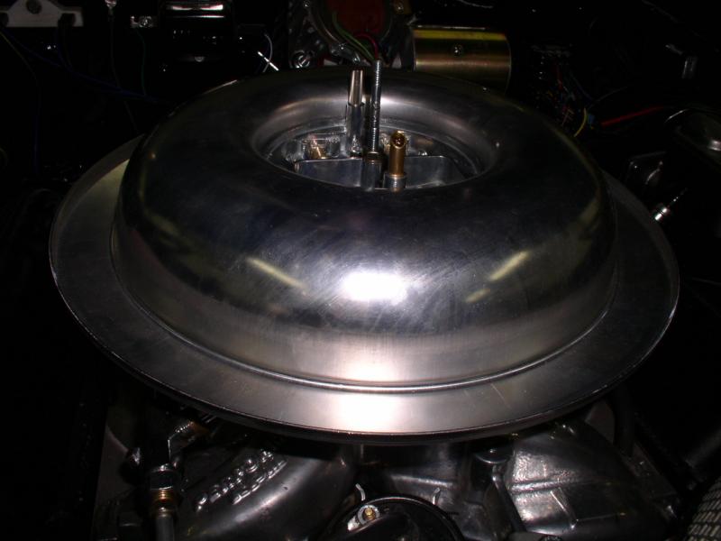

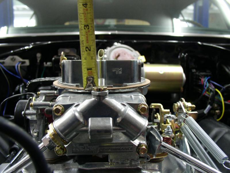

Time to talk a bit about Edelbrock RPM intakes, Holley Street Avenger carbs, and air cleaner fitment issues on a 440 in a Charger. I am also using a .25" carb spacer that gave the motor another 15 hp on the dyno. This is the best I have found so far and would appreciate any other options that you guys are aware of. Here is a shot of a Proform 1.5" drop base siting on the carb. With the top that comes with this air cleaner, the hood wont close - and it is butt ugly imo.

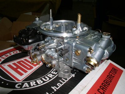

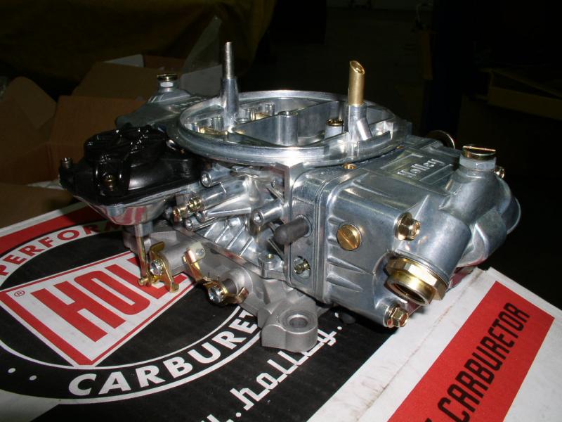

You can see how tall the choke horn is on these carbs. I am concerned with airflow, so I had this stuff milled off the carb.

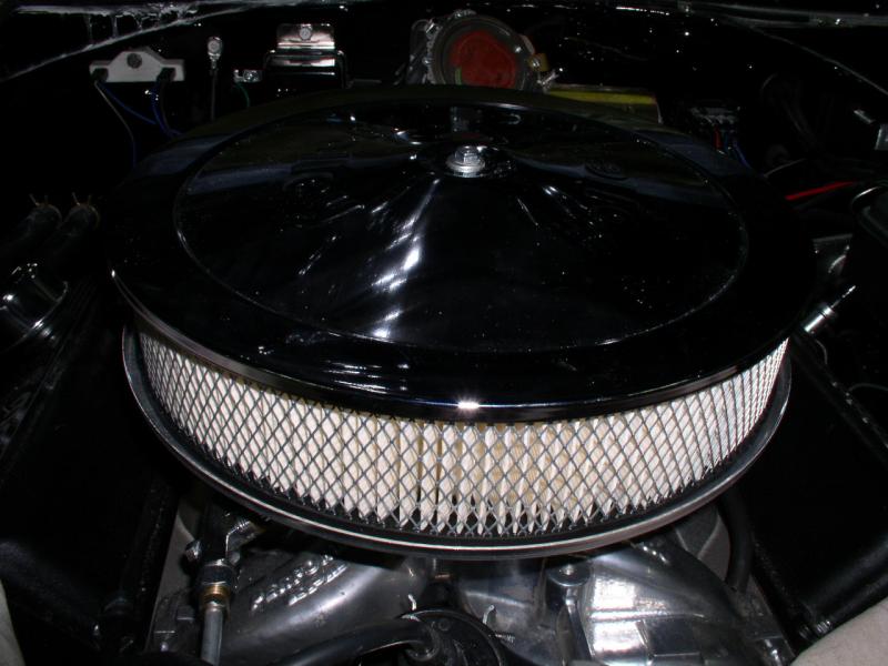

Here is what it looks like now. I then bought a Holley air cleaner that comes with a 1.25" drop, but only used the top and filter. I still can't use the supplied stud nut because it is to tall. I put a flat washer and nut on the stud cut off as short as I could. This leaves me with .75" from this to the bottom of the hood. I have a hood pad insulation that I want to use, but am thinking it might not work. My restricted area from the top of air cleaner to the bulge in the base leaves me with 3/4" of air flow around the opening of the carb. I wish this was more, but as of now that is the best I can do and still shut the hood.
I have to agree with you. That is butt ugly.

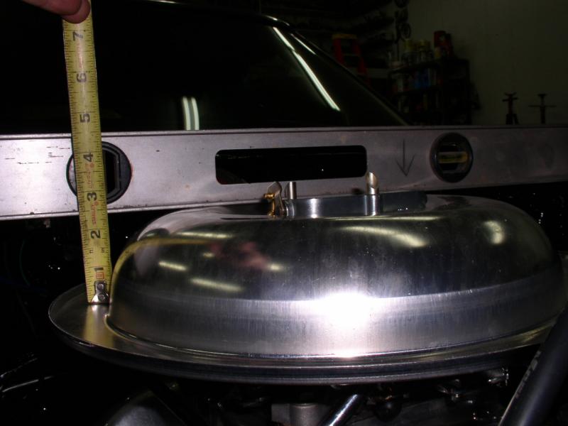

How much are you shy of closing w/o hitting the hood?
How important is 15 HP to you versus solving the problem and having a a/c you are happy with?
How tall is that filter 3" or more? Maybe shorter filter?
Can you use the drop base to modify a stock a/c setup to work w/o the spacer?

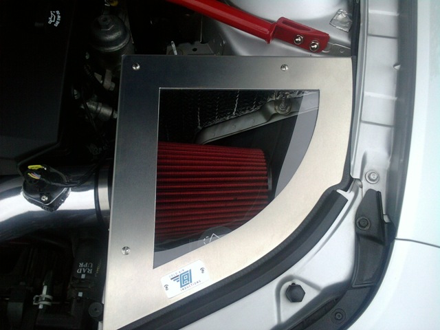

Hey H2E . . . here's a wild and crazy idea . . . just a thought . . .
What about changing it up and making it a Cool Air setup ? ? And you could place the filter like this ? ?
Just throwing the idea out there . . .
You already know I think outside the box . . . or in this case, inside a box ? ? ( smile )

Actually Bryan that is a bad picture, but it is the Holley top which I could live with. The Proform is really bad. This is with a 3" element. Even with that I am worried about not having enough flow. This is the shortest combo I can come up with so far. The closest part to the hood is the center where the nut is. I have 3/4" of space with this setup. I kind of like the 15 hp. What do you mean by modifying a stock a/c setup? And did you notice I can finally spell you name lol.

Good to see you back on the forum Speedy. Everybody must be healthy again in your neck of the woods huh? I looked at the K&N also and like the extra flow through the top, but thier bases only drop 1.25" - the same as a Holley.
That would solve my problem, but it is a little to modern looking for me - no offense.
View attachment 176266View attachment 176267
View attachment 176270View attachment 176271
