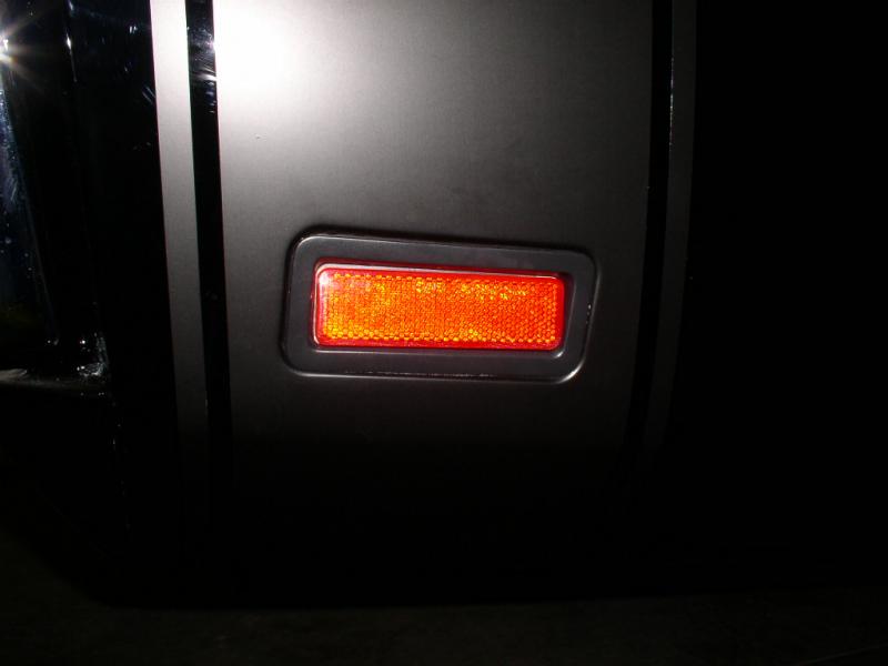

Thought I better get this thread updated a little bit. I got the rear reflector bezels back and couldn't be happier with the color match to the stripe.

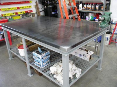

I also got the King Kong workbench finished up. It is a brute, that's for sure. I used 7 gauge for the top which if I remember correctly is about .19" thick. I welded up and ground smooth the corners. I then cut a piece of 3/4" plywood to go between the base and top, mostly to quite the thing down when pounding on it. I then welded 11 1/4" studs to the bottom of the top, stuck these through the plywood and base, and locknuted it all together. Then soaked it with wd40 for a couple of days and wiped off the excess. Turned out pretty decent if I do say so myself. It did turn out a little heavier than I thought it would, but at least I shouldn't have to worry about anybody walking off with it lol.
H2E . . . Love the bench, I'm sure it's going to get a lot of use ! ! !

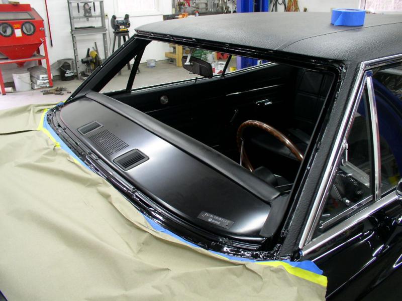

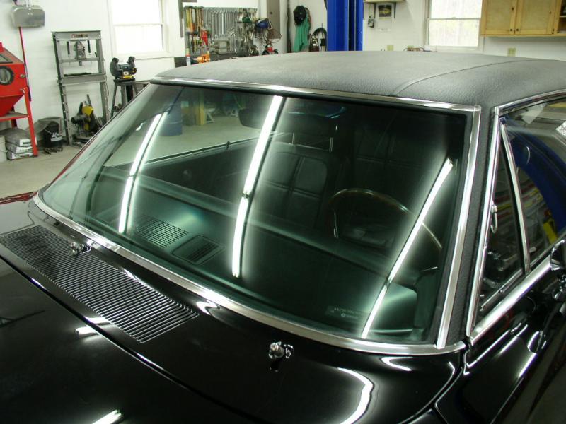

And back to the windshield from hell. It was pulled out early last week. I spent 2 evenings cleaning out all the urethane we had put in previously.

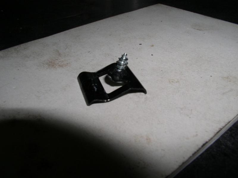

I pulled out all the clips and put a dab of 3m strip caulk on the threads.

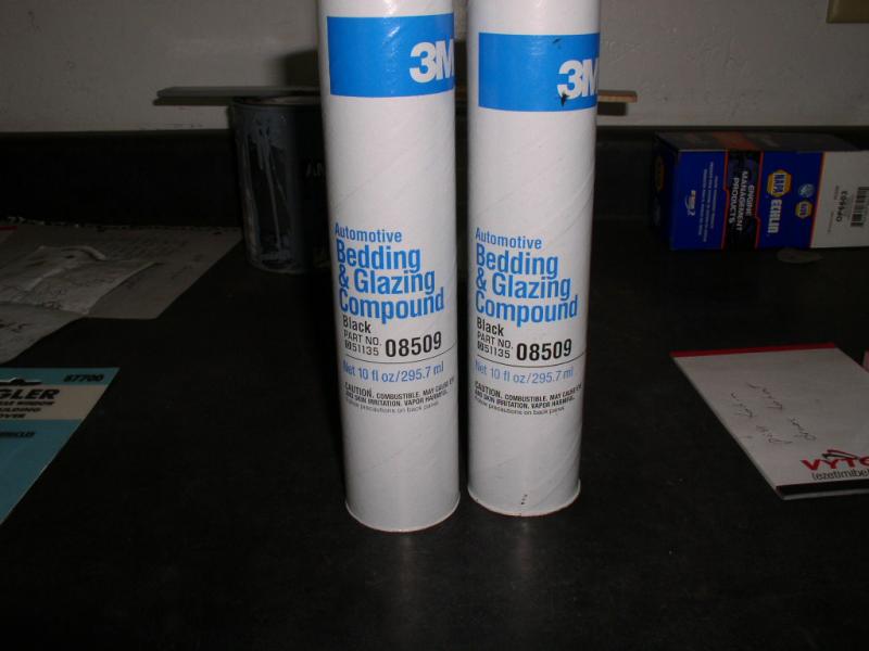

And after a bunch of research, decided to go with this 3m bedding compound. This stuff reminds me of roofing tar, but doesn't dry out. It stays quite soft actually. The reasoning behind this is that these cars flex, and need some give to prevent leaks in the future. The urethane used on todays cars create a bond between glass and body that is actually relied upon as part of the structure of the car - very different than these 69 and earlier cars need.
So right or wrong, this is what I did and it is not coming out again. First we put a small bead along the top and side pinch welds. We placed the gasket over these areas, and then laid a bead along the lower channel with extra in the lower corners. Got the gasket placed where we wanted it. Then a bead was put in the glass channel along the bottom and about 6 inches up each side. Finally time for the glass to go in. It was a little difficult because of all the sealer, but we got it in. We then shot a little more sealer into each bottom corner after sealing the zip of the gasket. No doubt about it, this was a piss poor design to seal a windshield that Ma Mopar had devised. Just having a pinch weld along the bottom channel would have made a world of difference imo.
Finished windshield install looks great and so does that nice wood grain steering wheel .. envious :)

I feel I did the best job possible this time around and actually feel pretty good about it now. It's just a terrible design that is just asking for leak issues. The other problem is that it is hard finding anybody familiar with these older designs, willing to put them in, and the little tricks of the trade to try to prevent water leaks. I think I will have to find somebody else, or do my own next time because this guy said he is done with this style from now on. Wonder if it is just this car because the kid told me this is the last car like this he is doing also LOL.

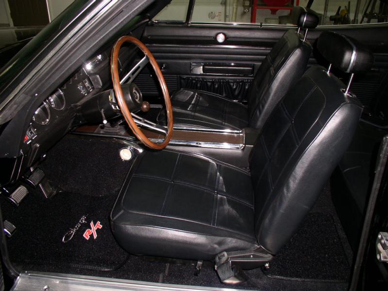

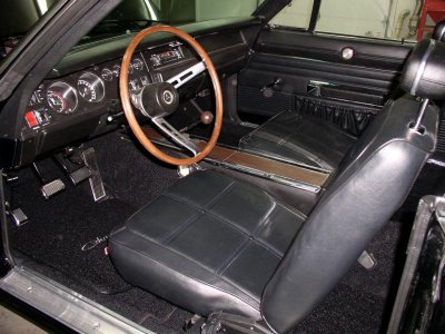

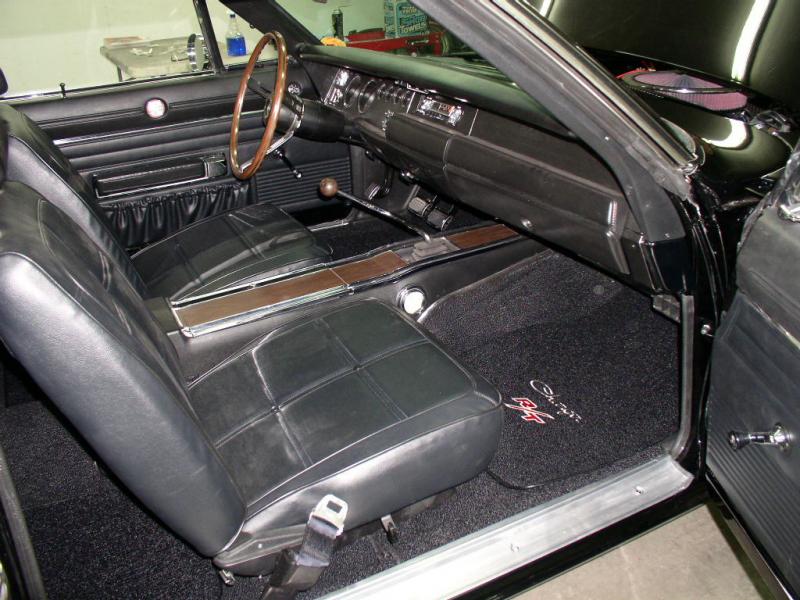

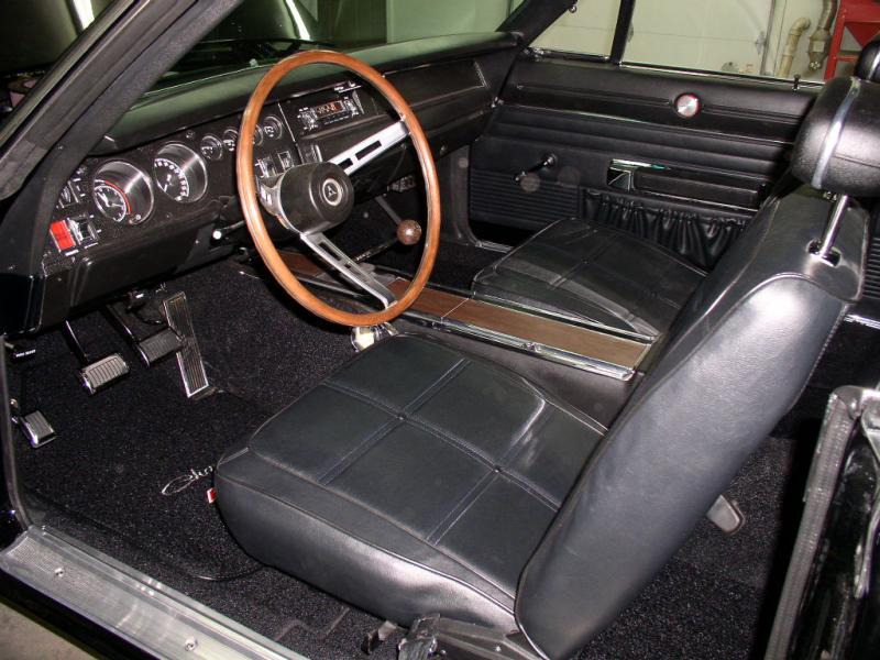

Also got the interior buttoned up. A little dirty, but it is done.
All I can say is WOW H2E . . . inside and outside look incredible, looks like you're about ready to be putting some miles on the "Bad Boy" very shortly.
