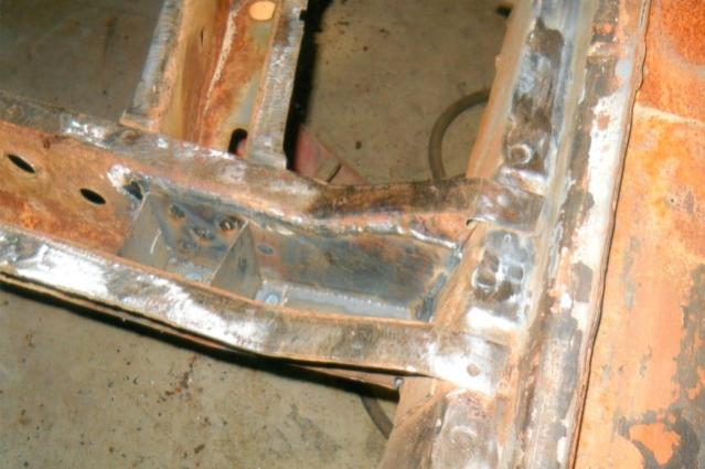

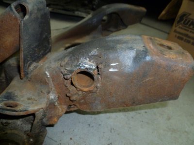

Well, went up to the car today to work on the K-frame. I took it completely apart, not good news. Looks like maybe the drivers side was hit or bent. My body guy tells me he does not feel right trying to fix it. When we tried to remove the lower control arm stud, it would not move, then we look and see that someone welded the 2 together. He had to use a cut off wheel to get it apart and you can see by the picture how bad it was, looks like someone welded in the sleeve. So I'm in a bad spot. I'm going to put up a separate thread asking for opinions. He wants me to go to a new style frame support, like a Q1A style.
I wanted to try and keep it original. Either way I have to calculate the cost to see which way to go. I don't want to lose the torsion bars, but I might have to. Has anyone else gone to the new type "K" frame?

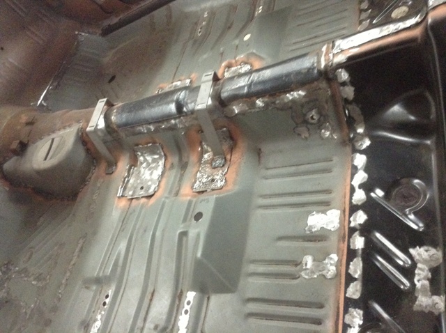

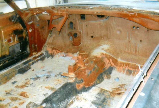

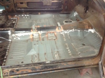

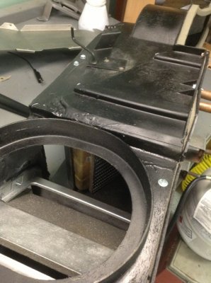

That was the ugly, here is some of the good and the bad. I going to try something a little different. If my body guy has the before's and after's, I'll post them that way. I think it might be better that to try and go back to the beginning of the thread. So with that said, here is the floor pan the day the car came into the shop and after it was fixed. Notice all the sand. The guy that had it before me tried to sandblast parts of the car and failed miserably.
![floor pan with sand.jpg floor pan with sand.jpg](https://www.forbbodiesonly.com/moparforum/data/attachments/129/129049-142b363f9be9180cc93535ee71a2ccd1.jpg)

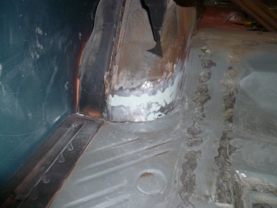

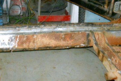

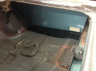

This is the front frame, once the floor pans came out we found rot and it need to be fixed, so he hand fabricated the pieces that need to be fixed. Once done he always sprays cooper coating. It will never rust again ( at least not in my lifetime)
![side frame unfixed.jpg side frame unfixed.jpg](https://www.forbbodiesonly.com/moparforum/data/attachments/129/129055-f0adccaff5bd589e56613a797fbbbf75.jpg)
![side frame fixed copper.jpg side frame fixed copper.jpg](https://www.forbbodiesonly.com/moparforum/data/attachments/129/129057-948073dc932f05c29baa67a2df7eb297.jpg)
