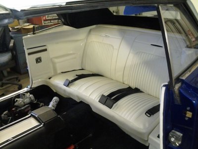

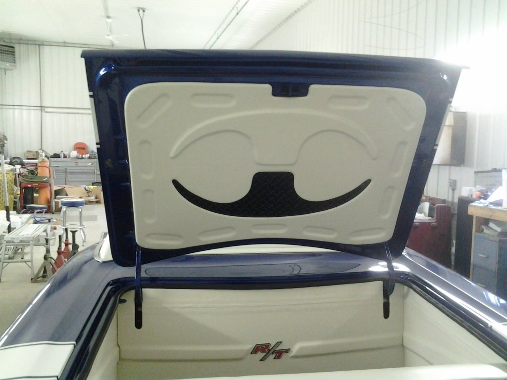

Trunk lid piece done.
Please tell us what you used and how you made that trunk liner. looks cool.
PVC foam board.Cut out the pattern,shape it with closed cell foam 1/4 or 1/2 thick depending on what you want,DAP landau top glue and good vinyl.

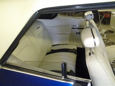

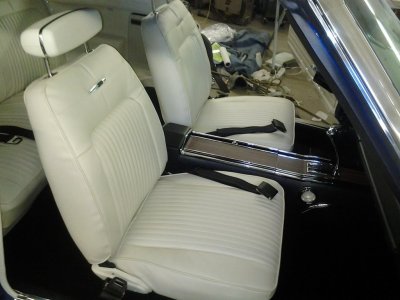

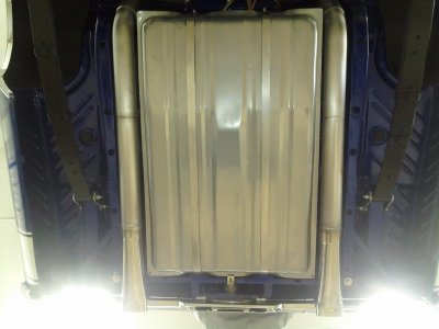

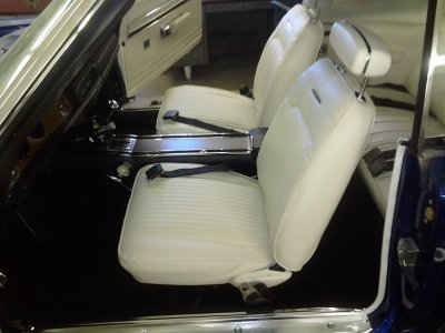

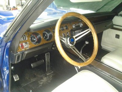

Finished off the interior.Moving into a new facility so as soon as the hoist gets moved the car will go on it and I can build the exhaust and finish underneath.

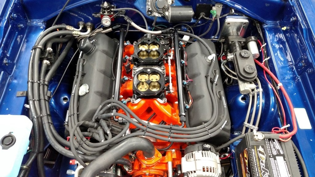

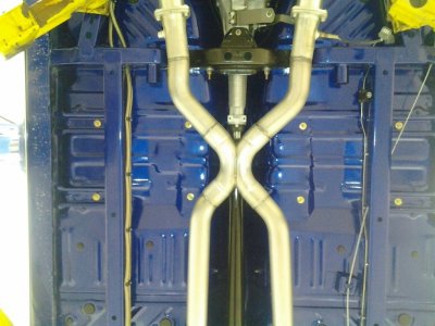

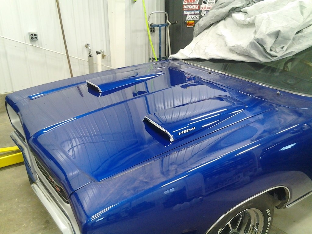

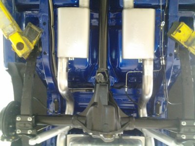

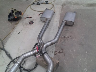

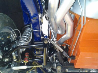

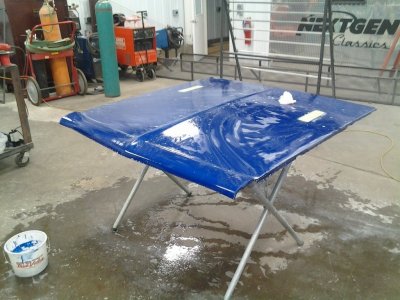

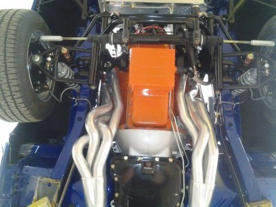

So finally settled into the new building and got a chance to get back on the coronet.I finished the steering shaft and column,built the stainless exhaust system,finished the hood and scoops and got that on and now am building the air cleaner assembly to fit properly on the EFI system.Oh and I fired it up the other day and it sounds BADASS.:thumbsup:

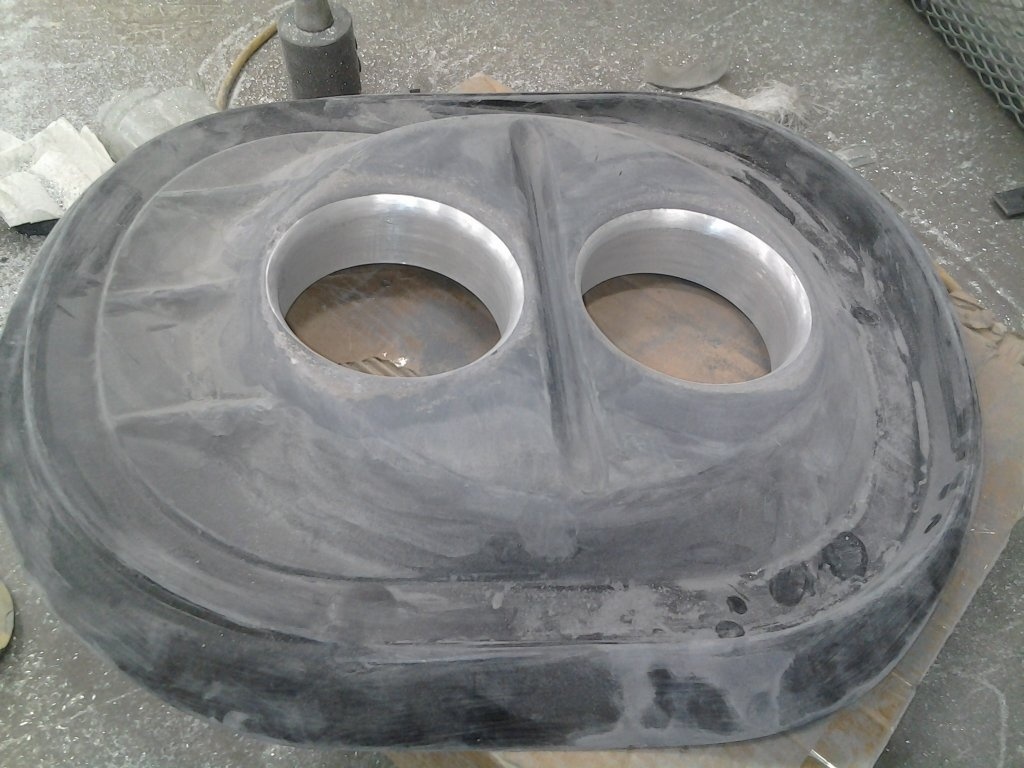

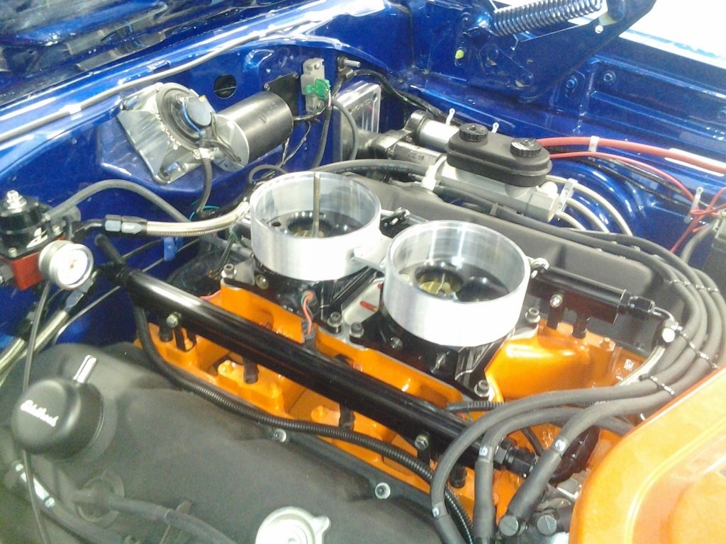

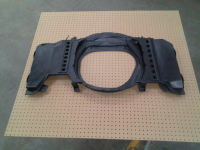

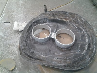

Here are pics of the modified air cleaner base.I also blasted and painted an original ramcharger induction so it is ready to go.

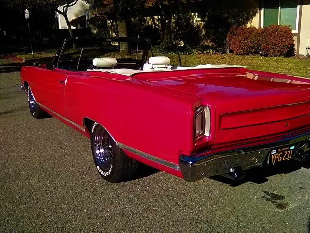

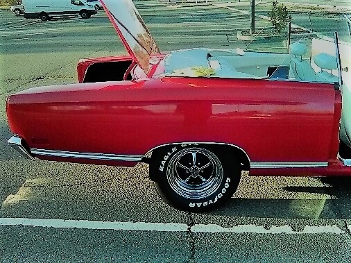

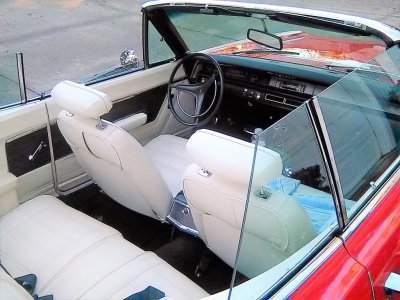

good job jamie.thats incredible,,i realy admire your work and finished product,,enjoy that bad boy,,i drive my 69 satellite vert ,every weekend ,the weather is gettting nicer, i love the attention i get from my baby,,,cheers happy cruises.
