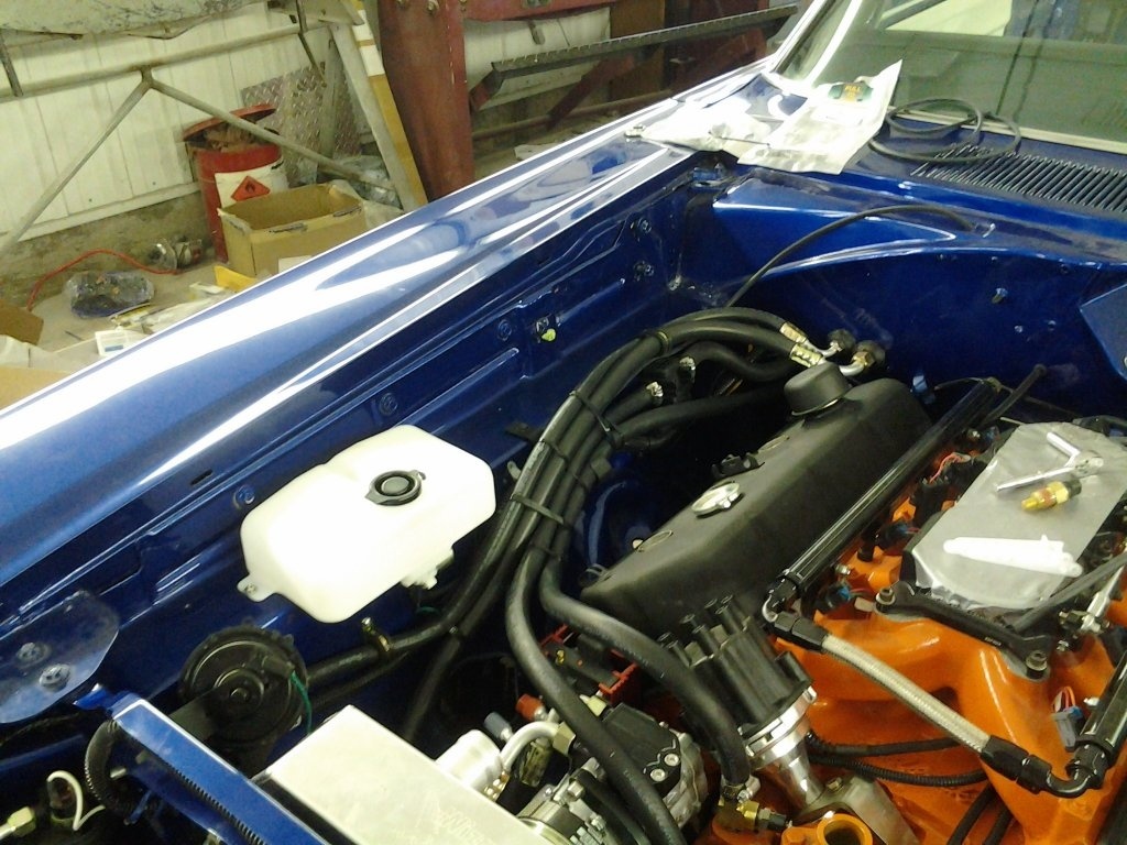

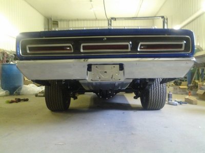

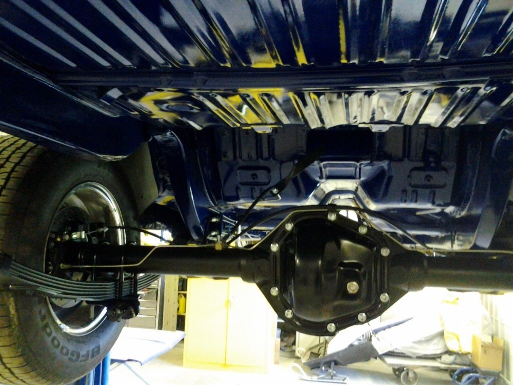

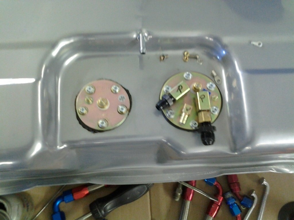

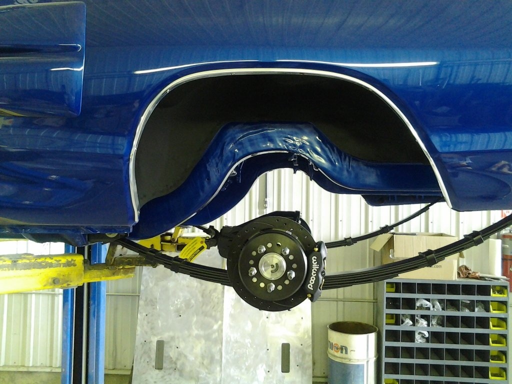

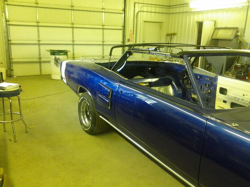

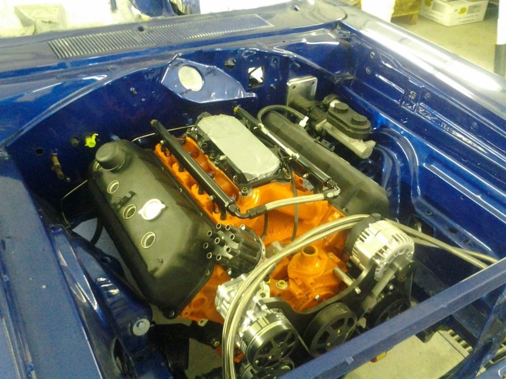

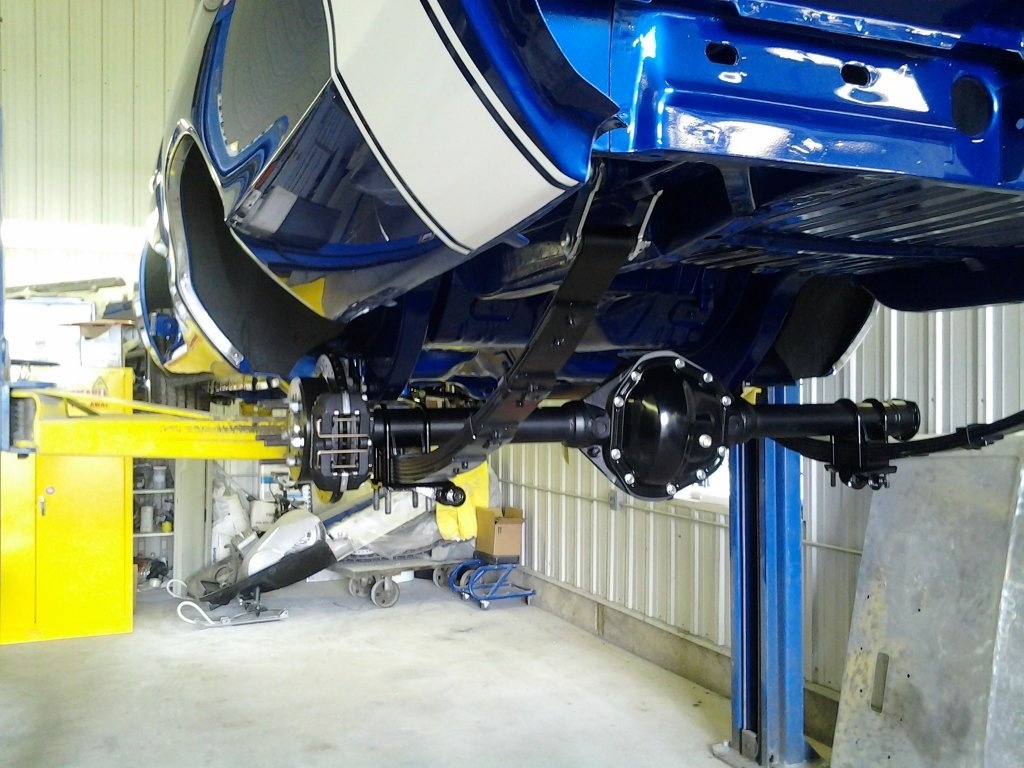

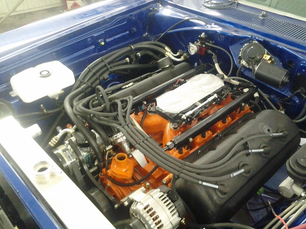

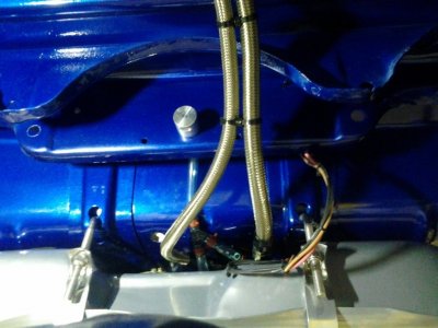

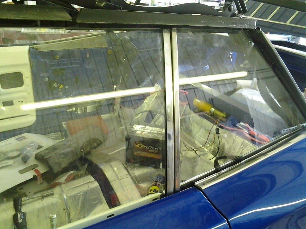

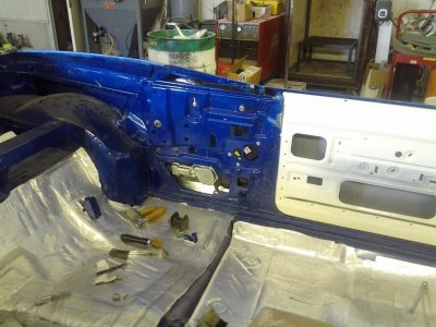

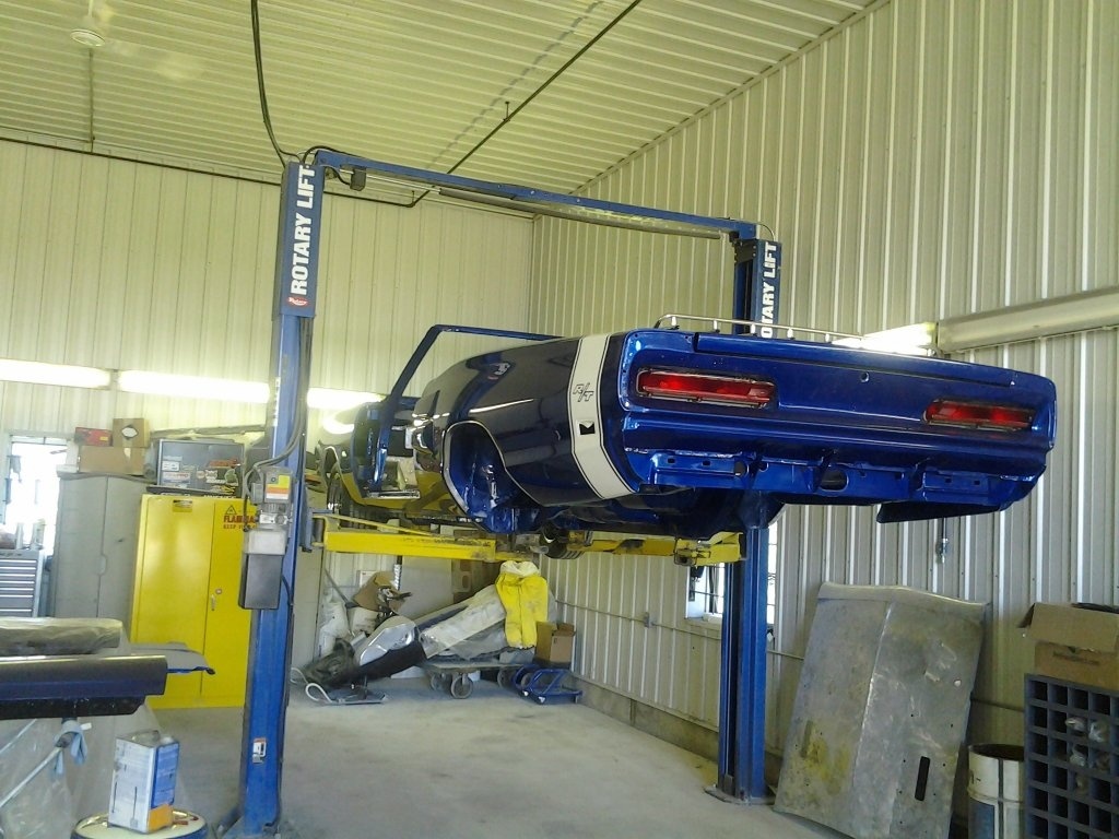

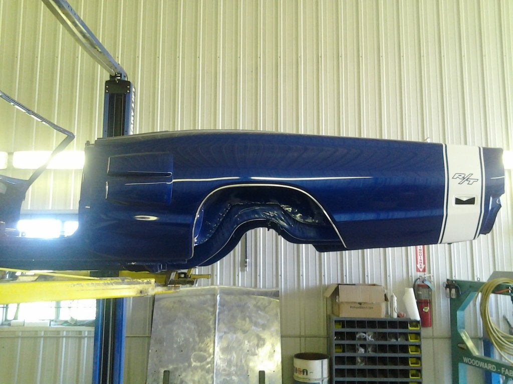

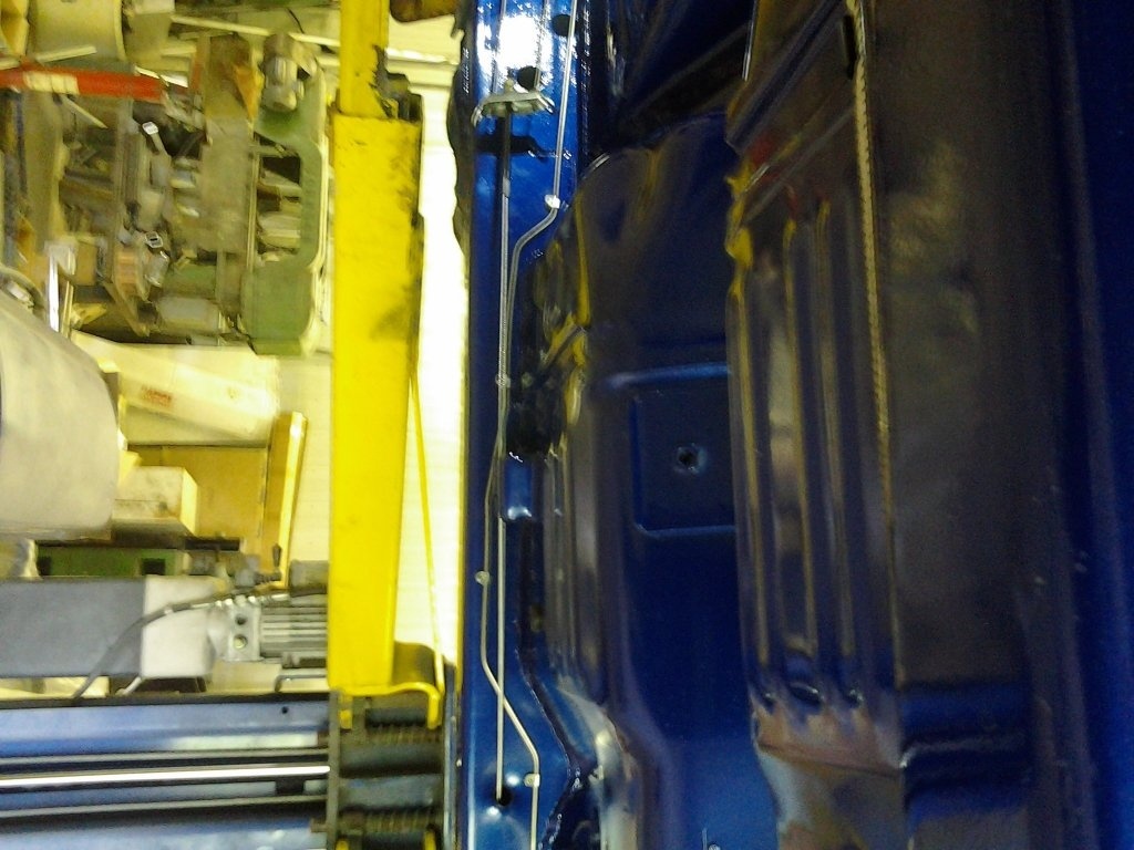

More pics.EFI tank is in.Nu-relics rear windows are done,engine/trans is in,moser60 is in,rear end put together,brakes done,repainted inner doors white.

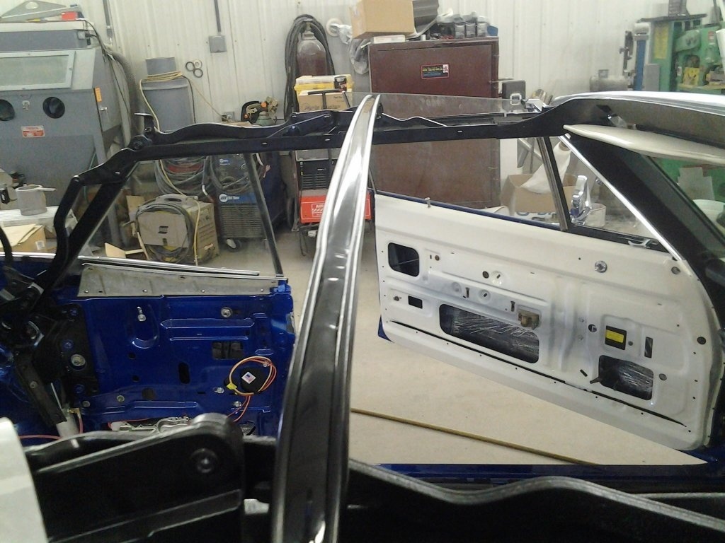

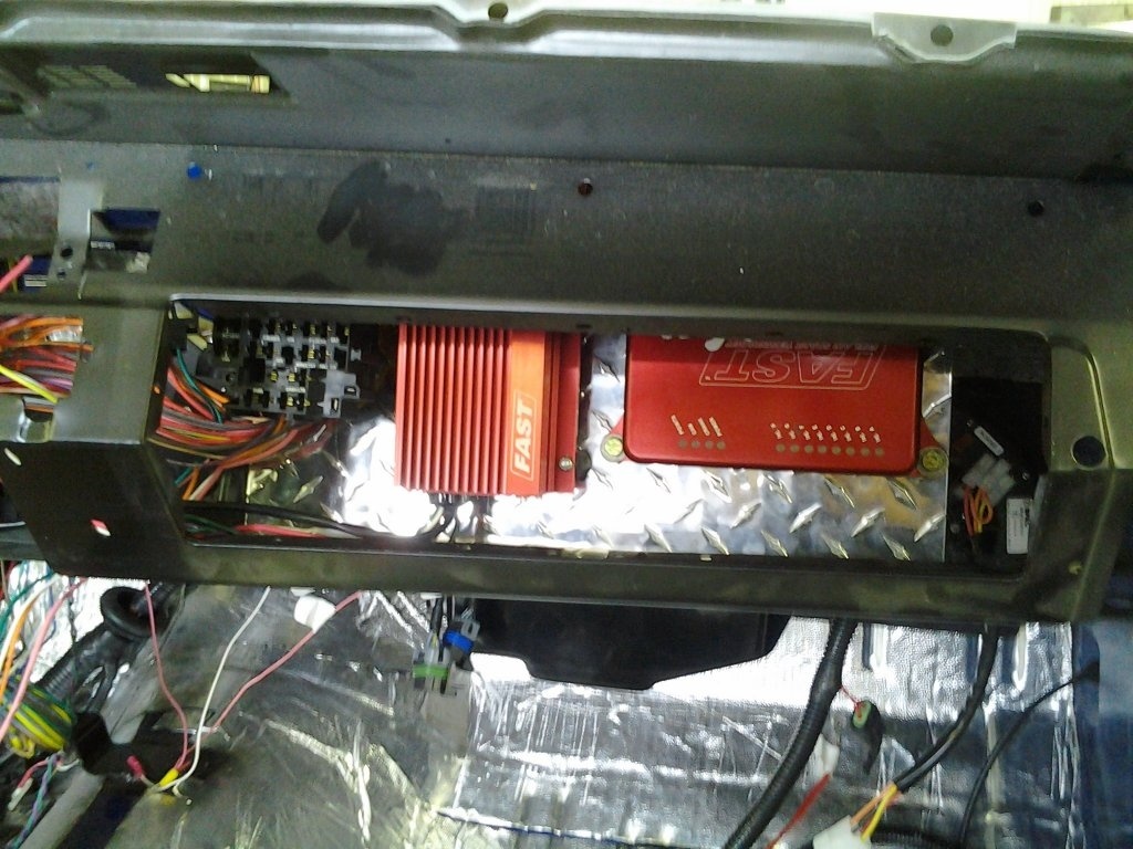

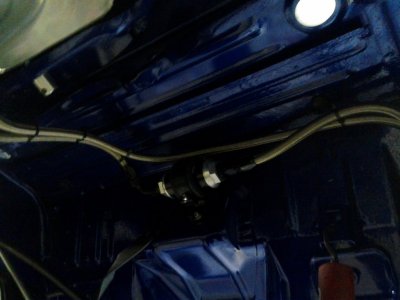

Got top and hydraulics in,drivers side vent window and window in.Started mounting ECU and other electronics.10lb's of **** in a 5lb bag.

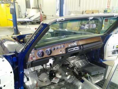

Under dash wiring finally done,dash and windshield are in.

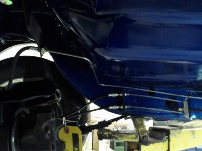

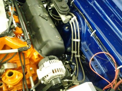

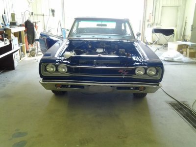

Front end together,ac lines done,hydraboost lines made,shortened all the plug wires.Attacking the convertible top tomorrow.Never done one,wish me luck.

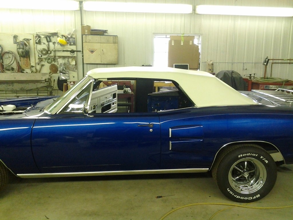

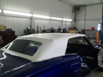

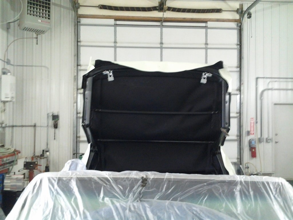

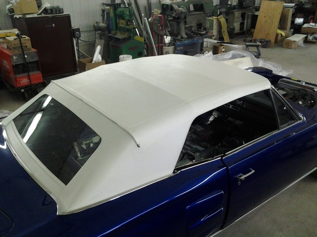

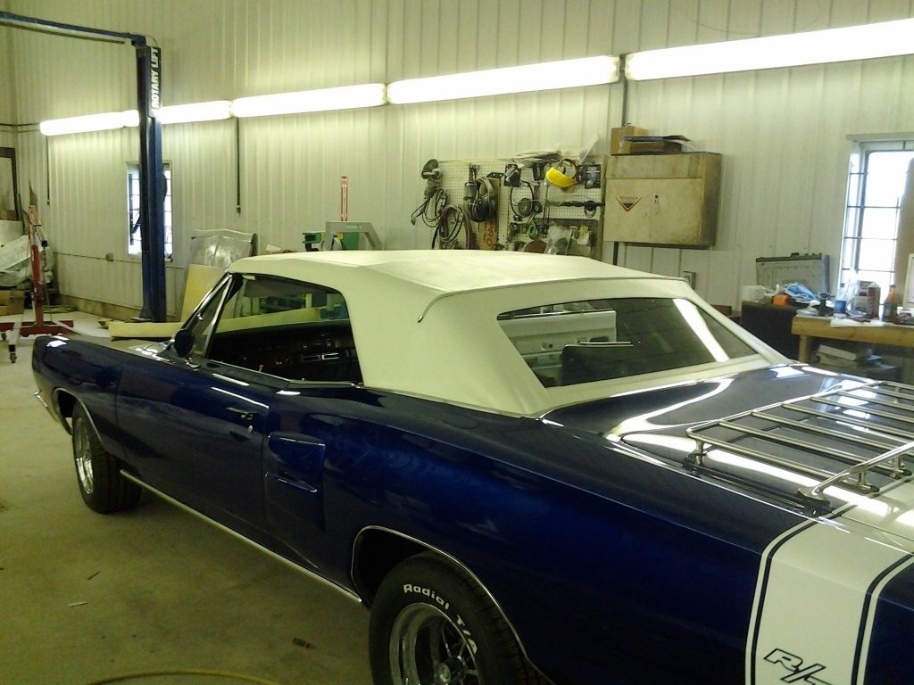

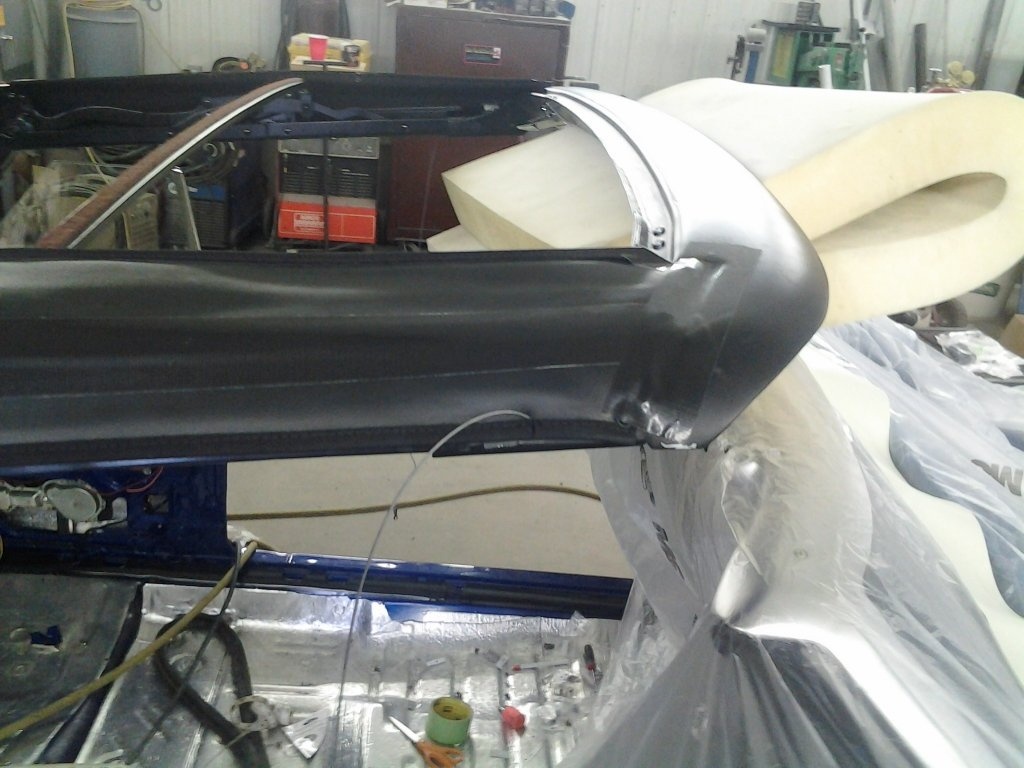

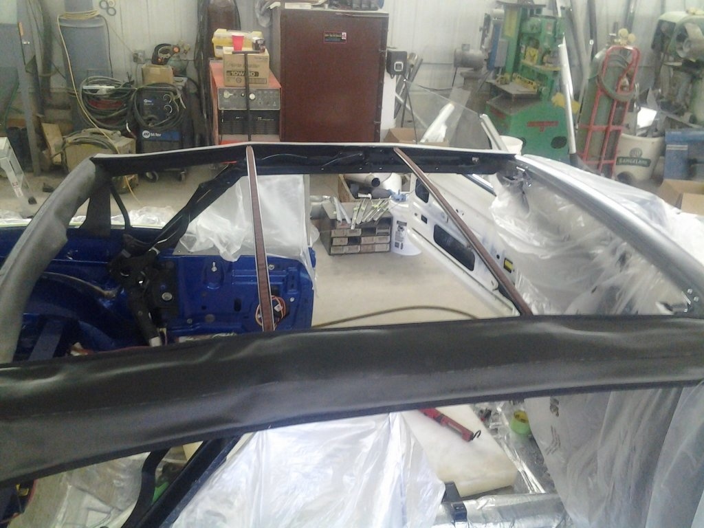

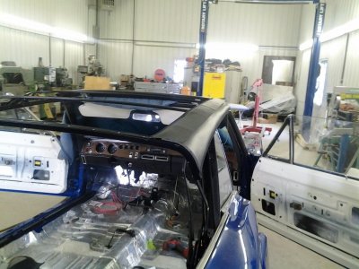

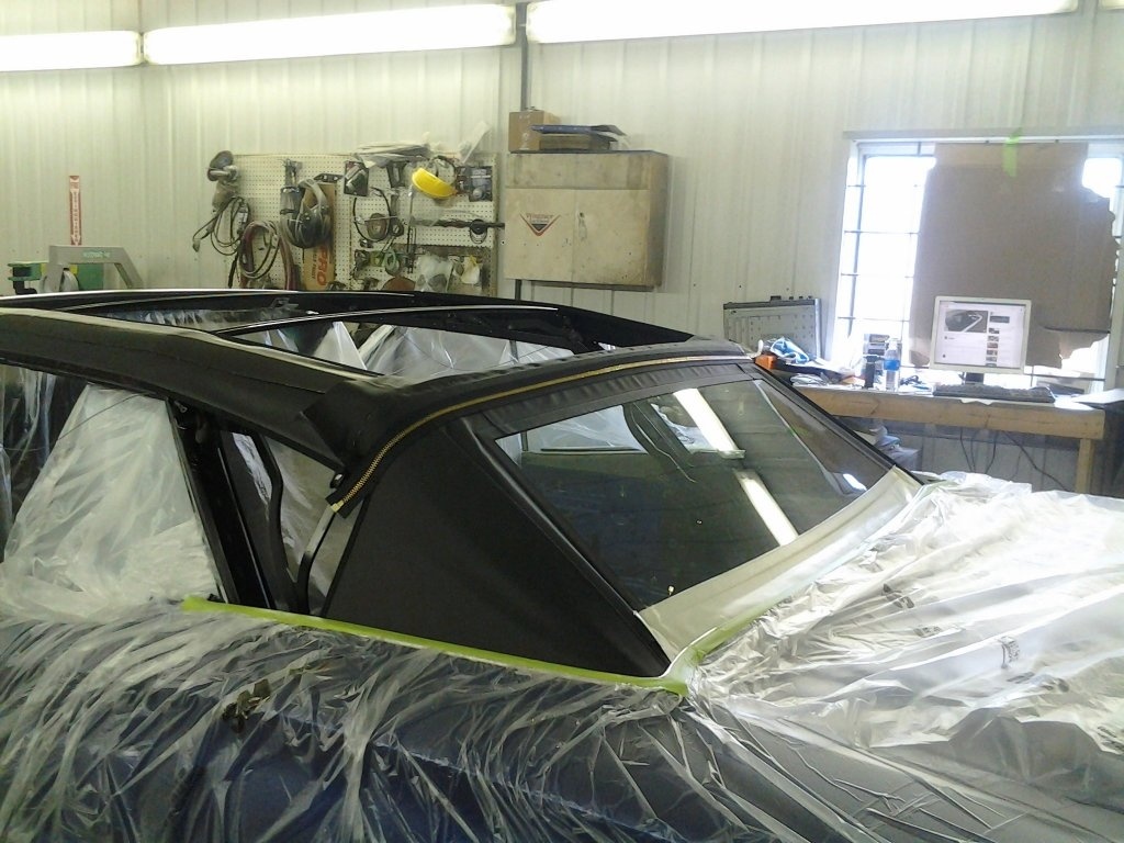

The top is done other than the weatherstripping.I thought it went pretty well other than the top was sewn crooked by the top of the back window.
I called Electron about it and they basically said that was impossible and it was my measurements that were off.I sent them pics and heard nothing more so I went ahead and installed it anyways.I was able to,for the most part,hide their mistake so I think it will be ok.
I ended up with one small wrinkle in the driver corner by the quarter that should come out with a steamer.Maybe I got lucky but I thought it was fairly easy compared to some of the things I get into.:thumbsup:

Car turned out unreal. Nice work. Love the luggage rack.

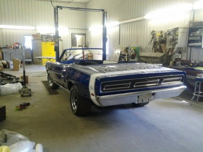

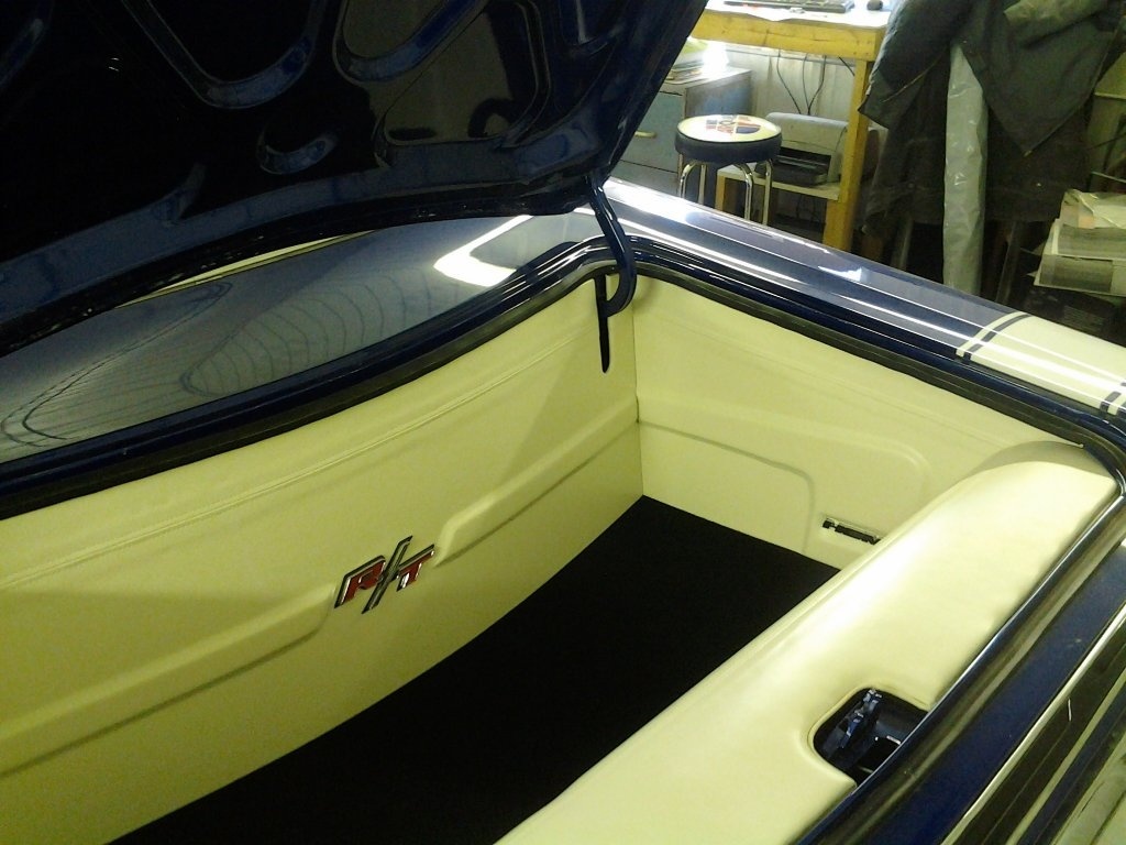

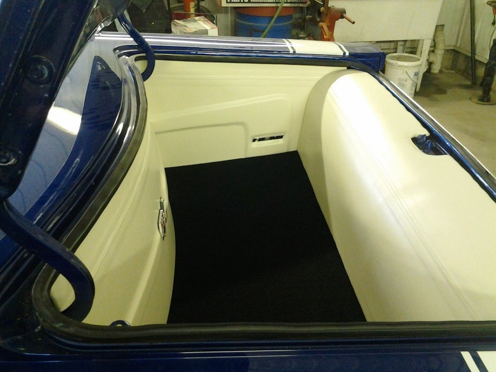

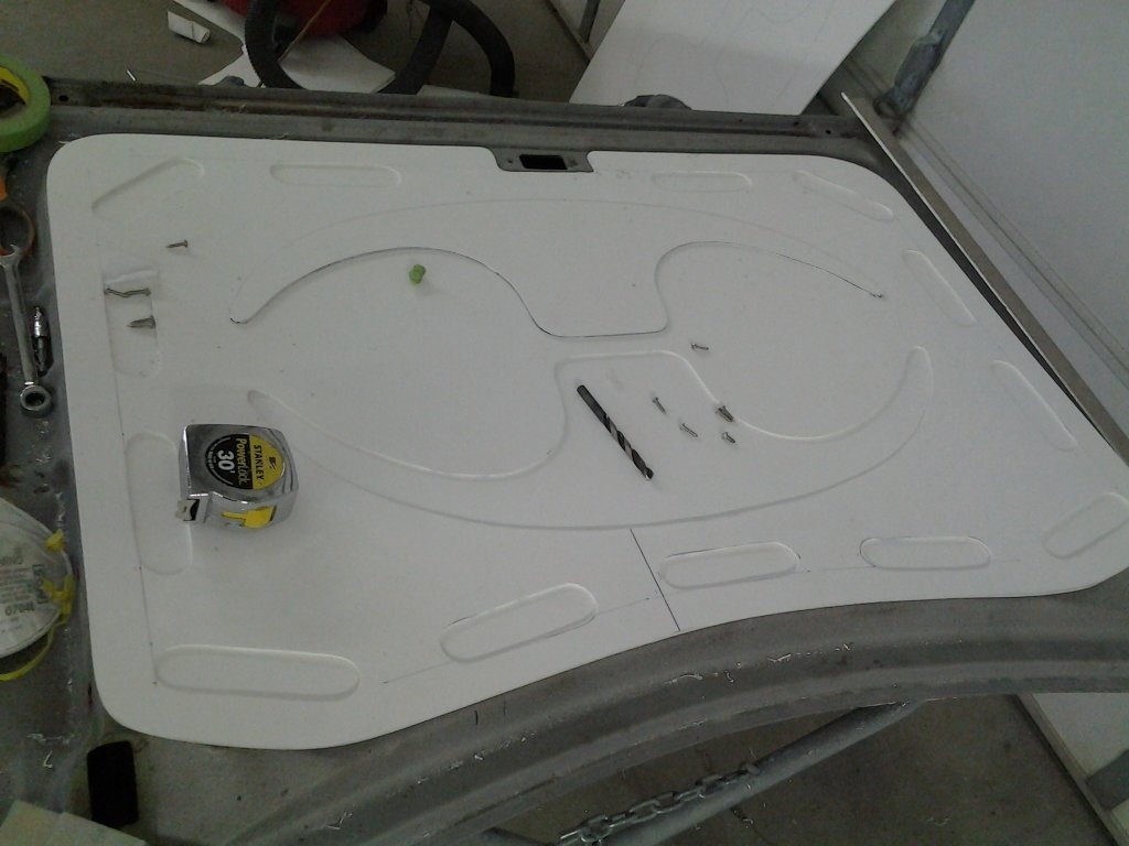

So I don't really care for the big 'ole trunk in these cars so I thought I would finish it off.It is not a numbers car anyways,just a nice driver and it can all come right back out in a few minutes.I am making the panel for the underside of trunk now.

jamie,,thats amazing idea..its a show winner.

its beautiful,,wow,,jamie your smart,,,i love that trunk,, its a show winner,,100 percent.good work..craftsmanship.
