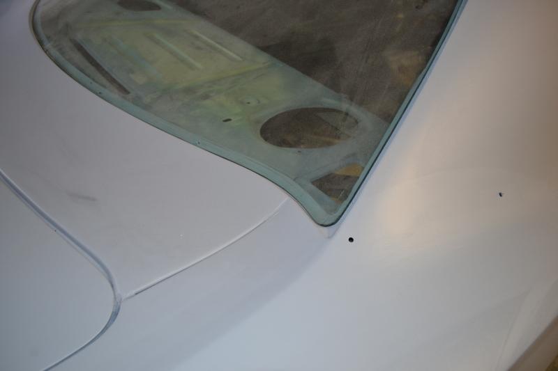

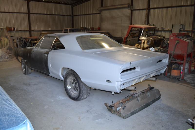

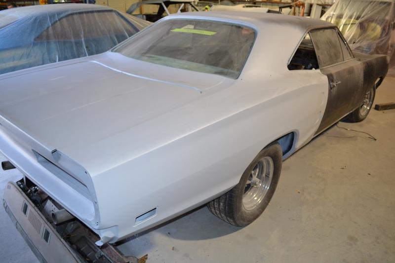

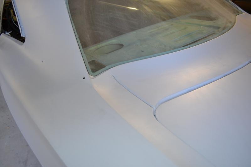

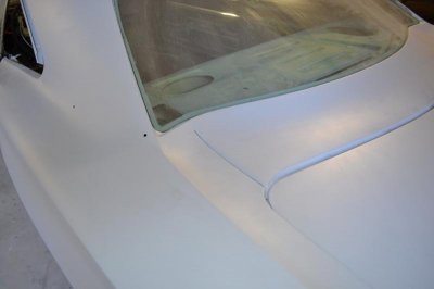

Update - Quarters, tailpanel, trunk, wheel wells, and rear window corners are repaired and in primer - pretty much a new back half of the car.
Pics:
Getting ready to start tackling the floors and rockers the next couple weeks.
Craig
I agree, everything looks great and that back window fits snug in the channel. When you get it sealed in place, there's no way any water is going to leak down underneath.
Looking good. Looks like you found some decent help for the stuff you aren't comfortable doing.
Wow, You have this looking good! no doubt this is going to look great..
