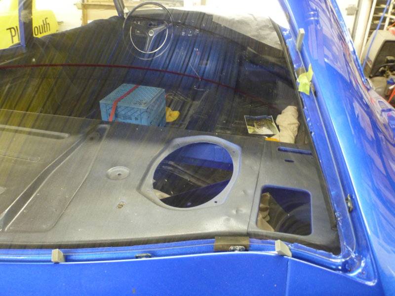

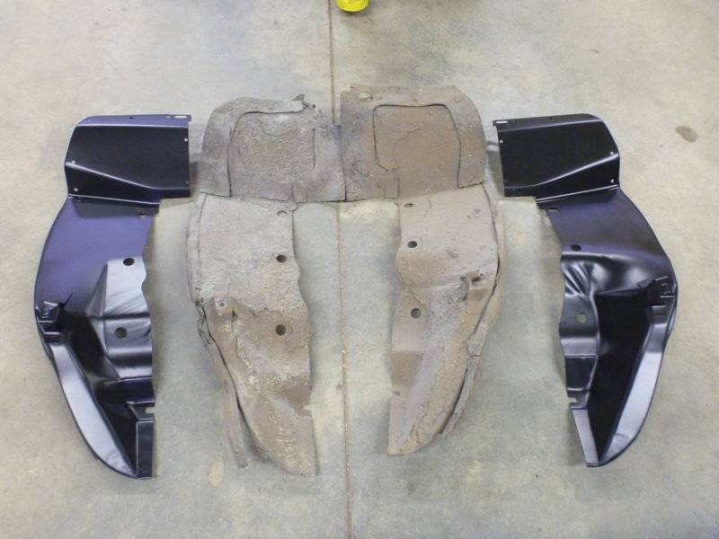

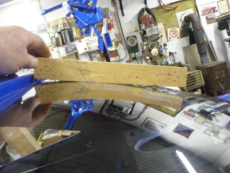

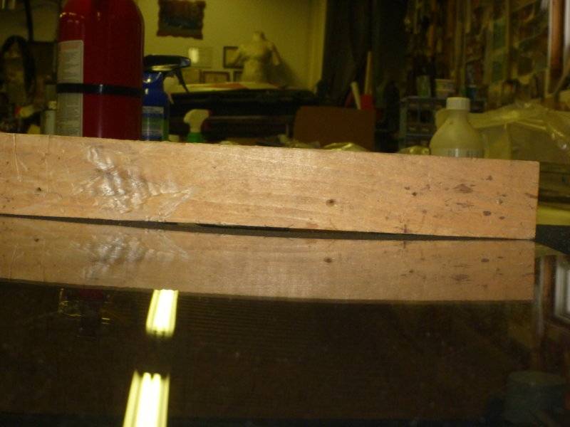

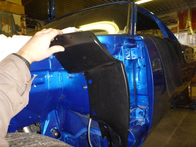

Back glass install on hold, so carry on! Making sure my AMD front fender splash shields are correct, compared to the OE's. I don't need anymore surprises...

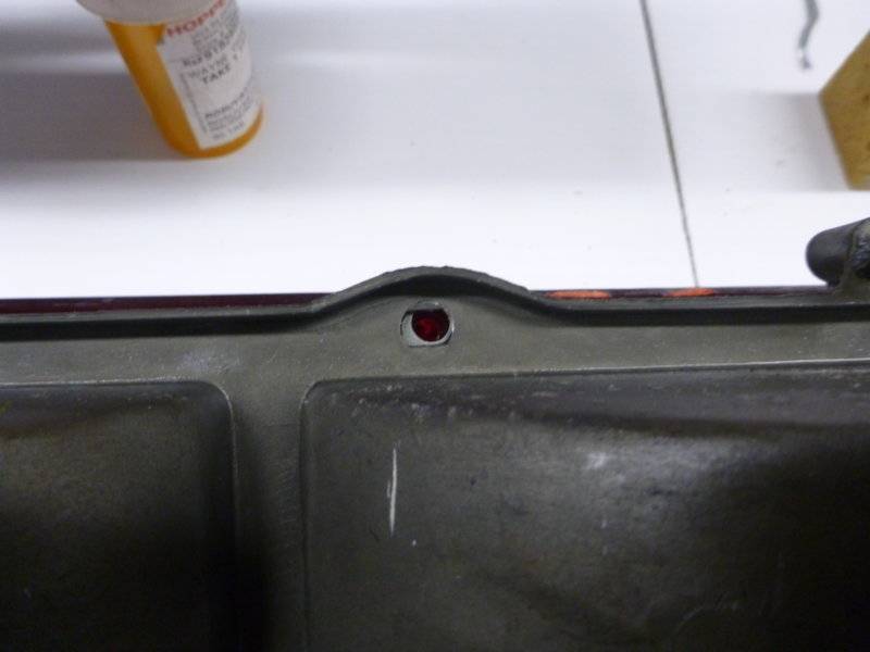

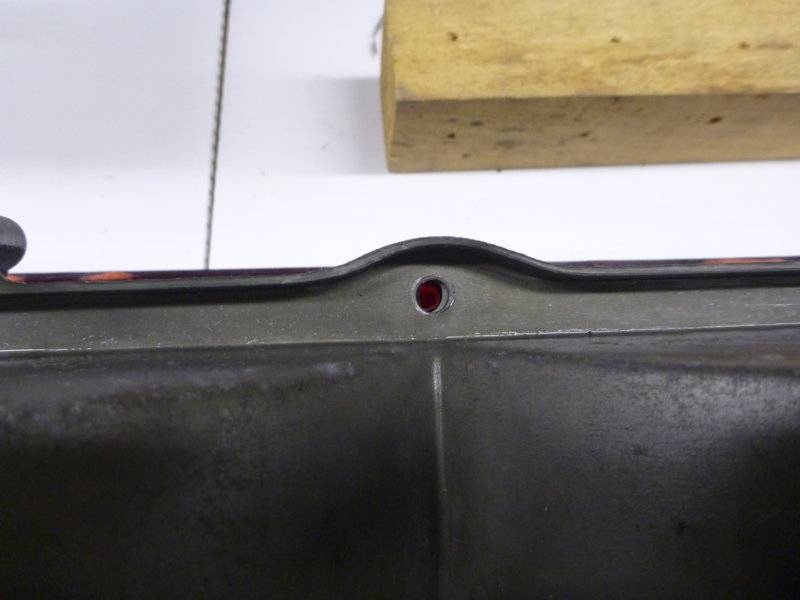

Checking fit, drivers side needs a little "adjustment".
Adjustment performed.

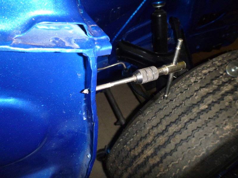

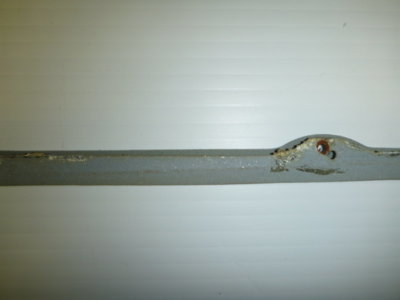

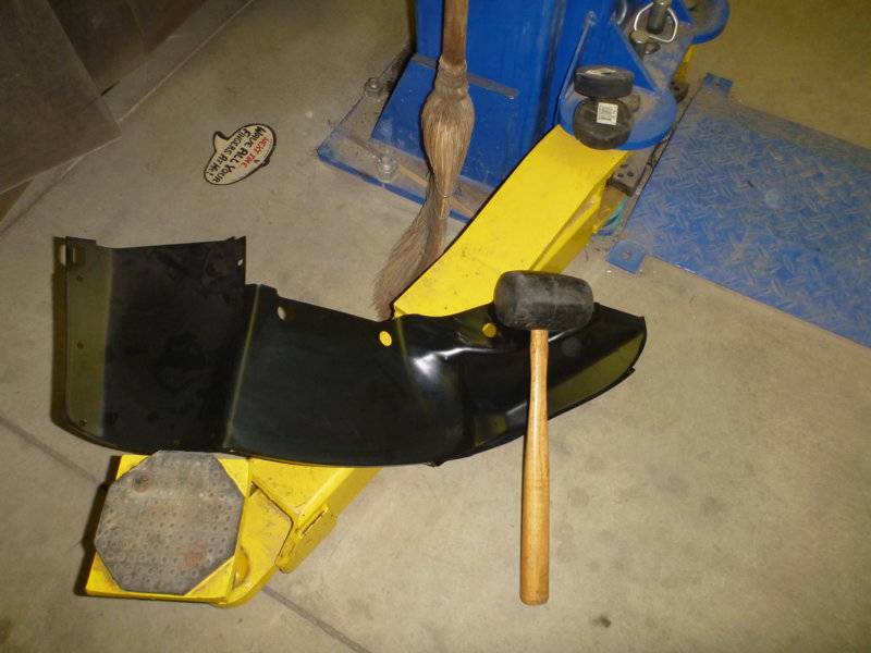

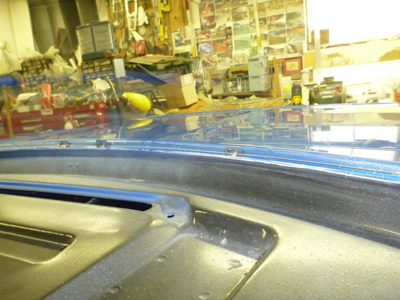

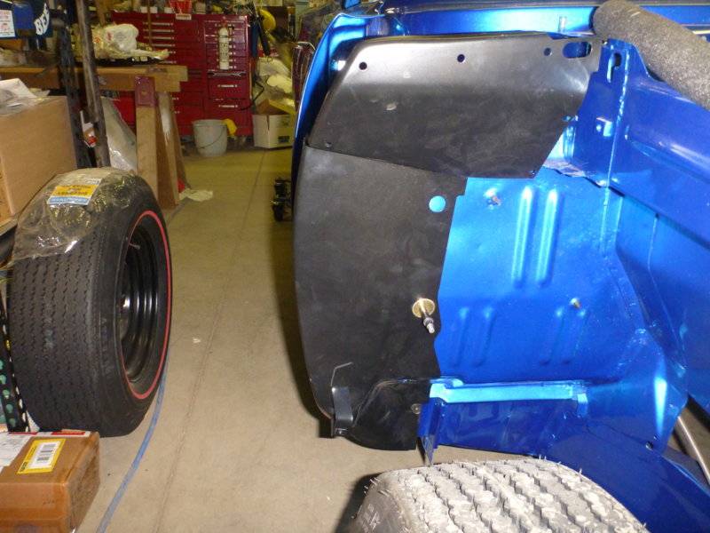

Passenger side fits perfect, but my upper mounting hole on the body is AWOL.
A couple of holes got welded up and / or covered during repairs and body work. Making sure all the holes are ready to go so not fighting when the fenders are in the way. Tap is 10-24 BTW.

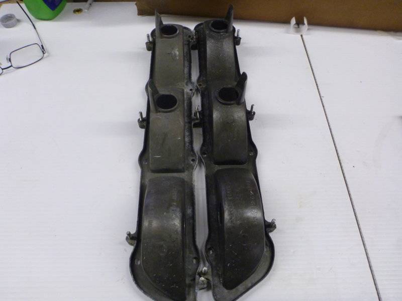

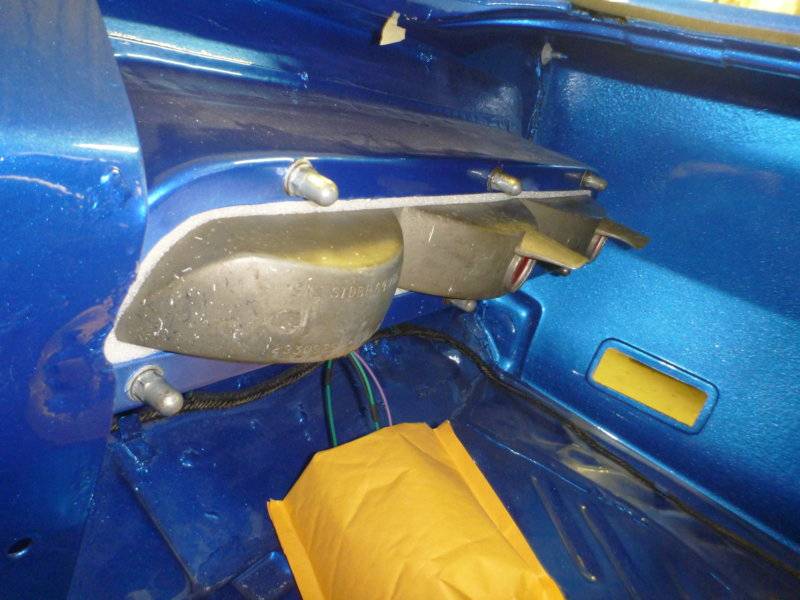

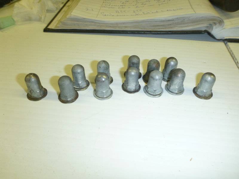

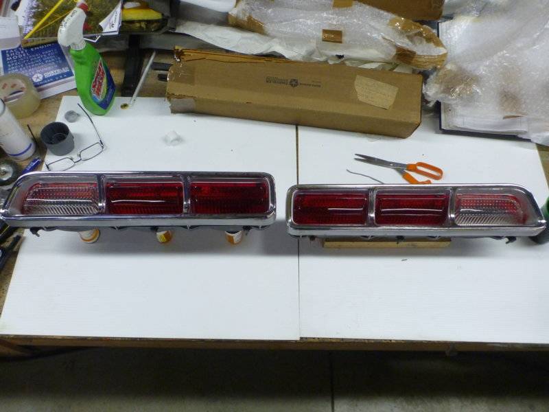

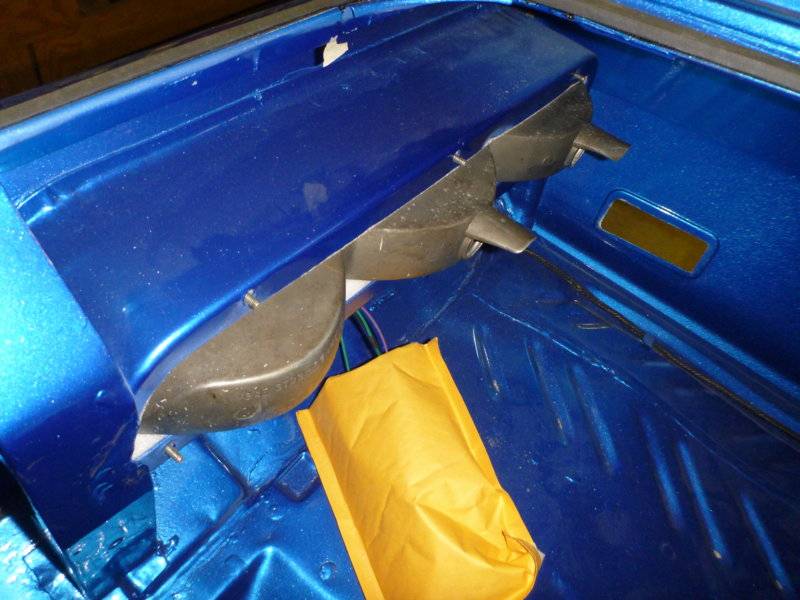

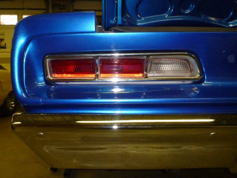

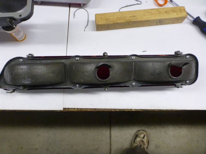

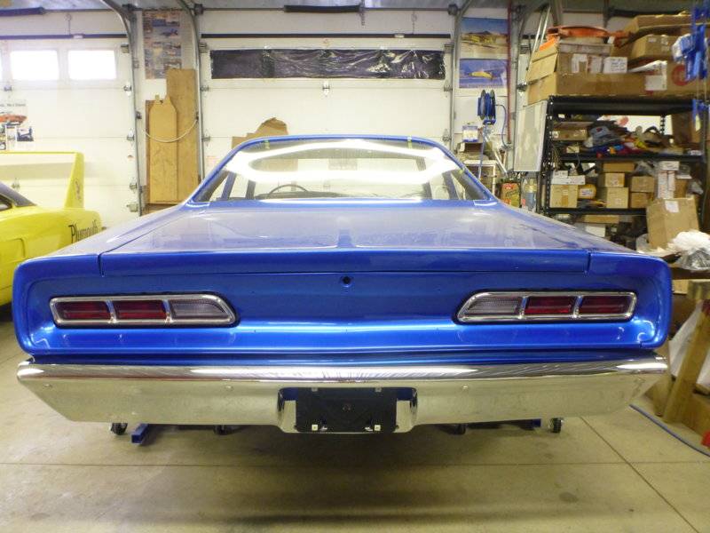

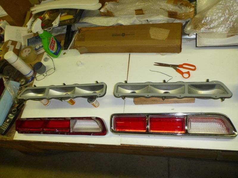

Acorn nuts out of Evaporust for tail lights. Most cleaned up pretty good. Will keep an eye out for some more clean ones to swap out a few at a later date.

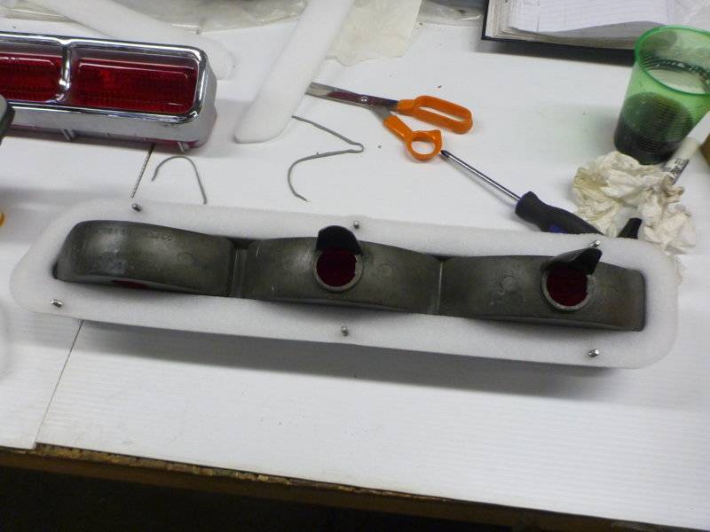

Tail lights lightly tightened in place to start squashing foam and will wait for final tightening and alignment once I have the rear trim panel restored and in place.

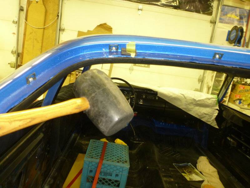

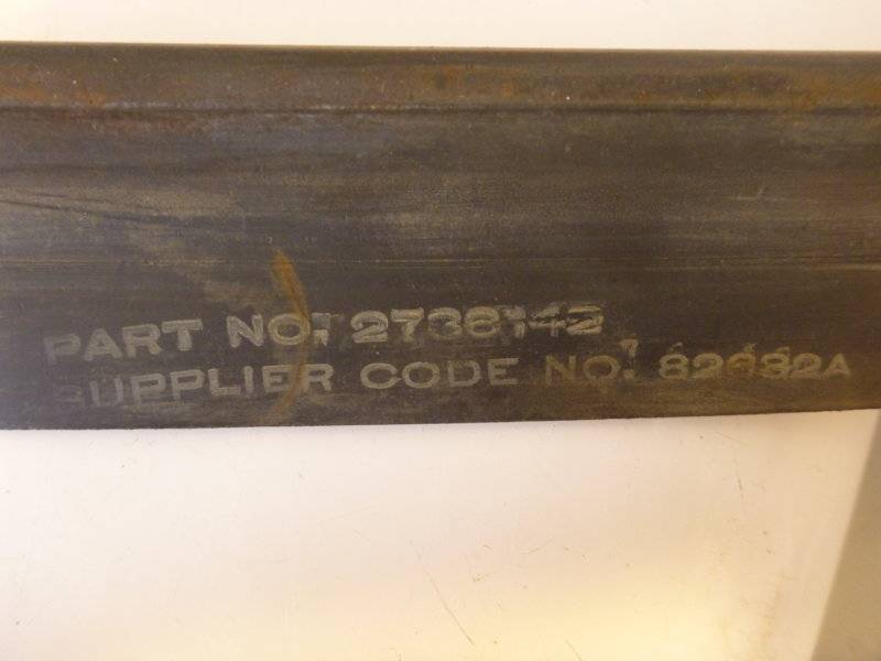

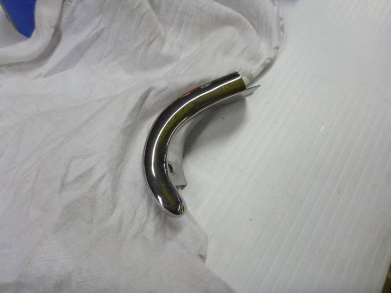

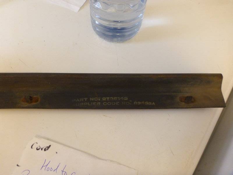

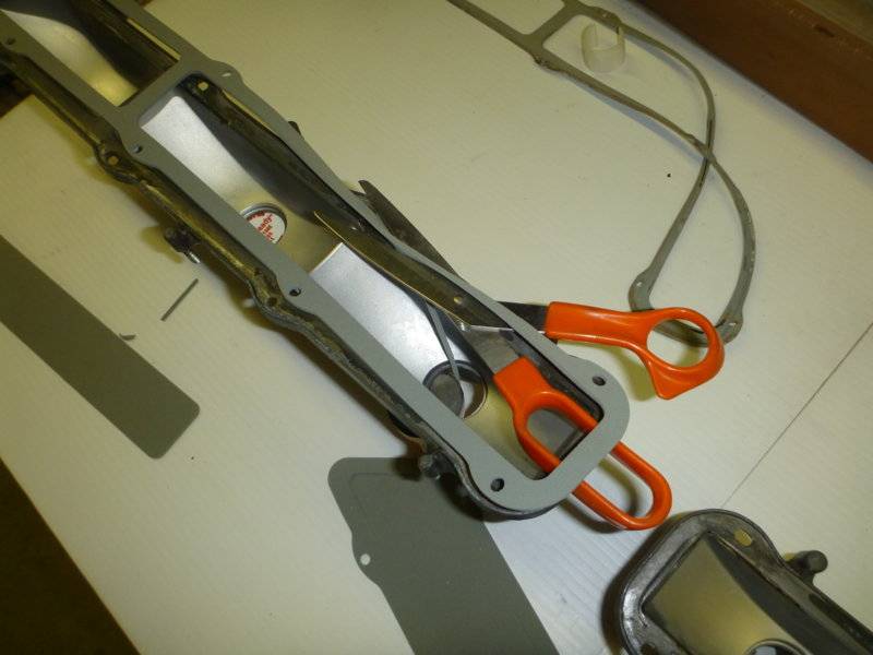

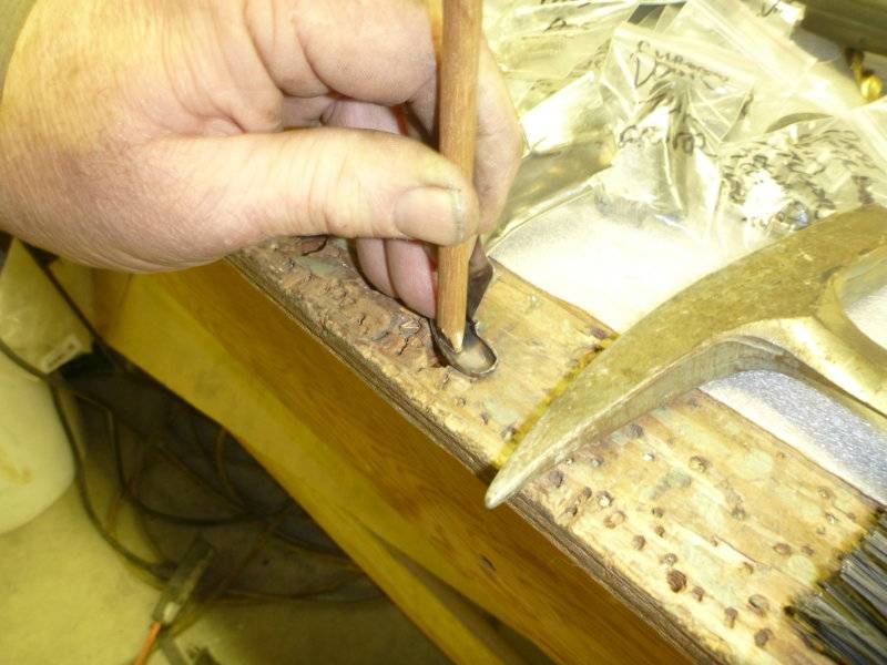

You can teach an old dog new tricks. Cut a dull point onto a piece of maple dowel rod and hammered out a dent in the drip rail trim.

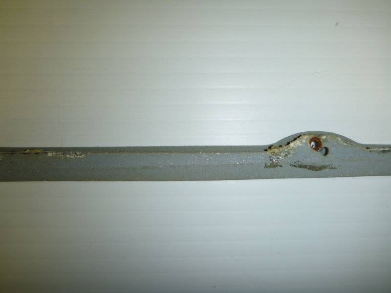

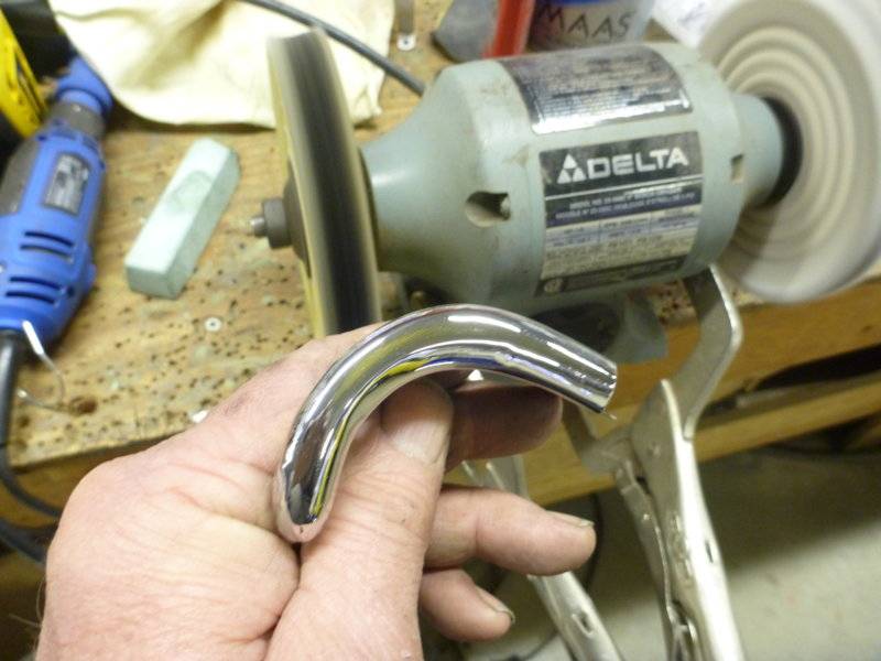

I had already started on this piece previously. but couldn't get one spot to clean up due to the dent. Dent taken out and part way through the "cut and buff" process with green compound.
About 45 minutes of work on that little piece. Have both sides done now.
