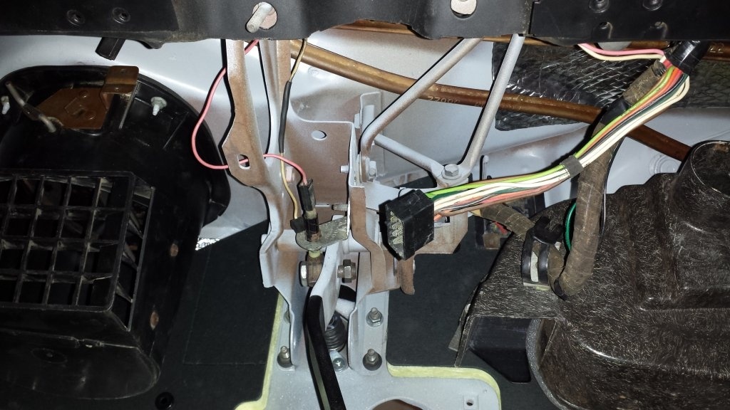

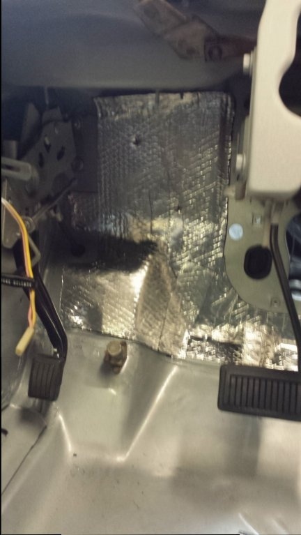

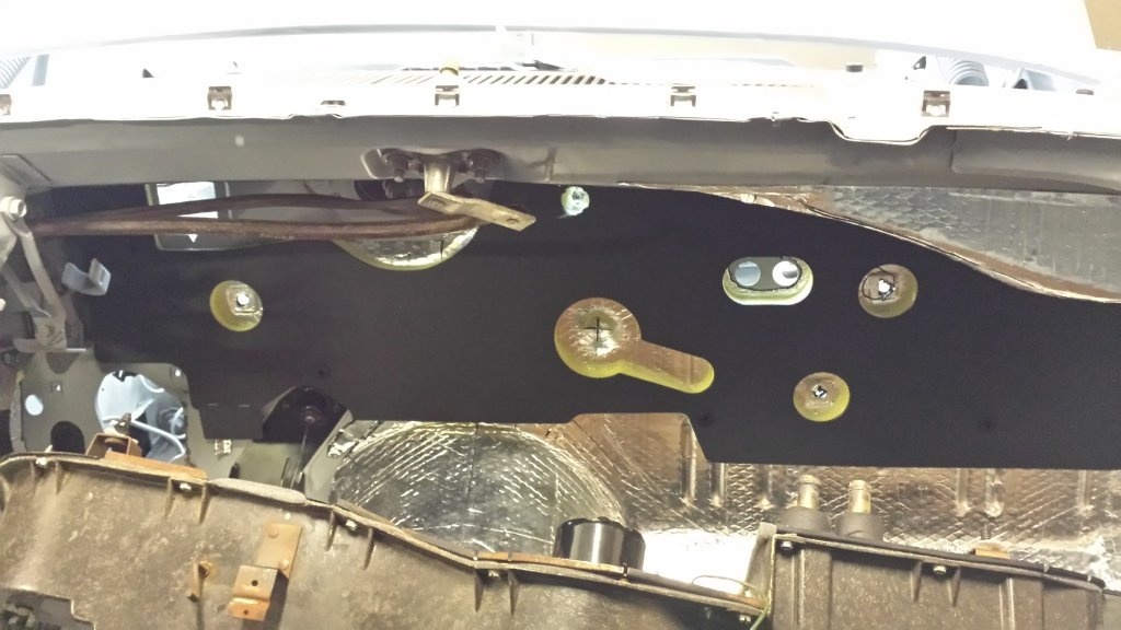

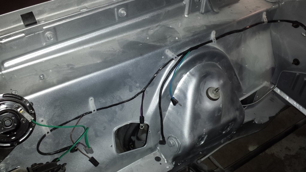

My garage looks like a hurricane hit it, stuff all over. I got my firewall insulation finally so I took down the heater box, put up the insulation and replaced the fan vent tube and buttoned it back up.

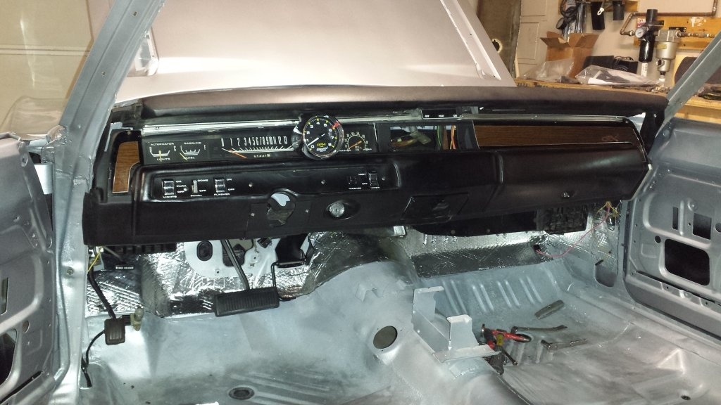

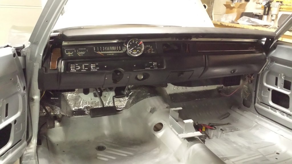

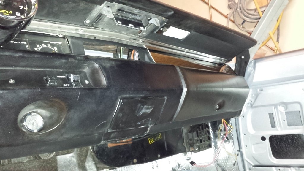

With that up I could then start on the dash. I ran the wires for the tach I had and put in on in a location where there was already a hole for the wires and for the screw. Not super thrilled about the location so I will move it. Ran the ground and pickup for the tach out an unused hole in the bulkhead. Then threw the dash in lol. Not super easy by yourself but doable, and I cussed a lot.

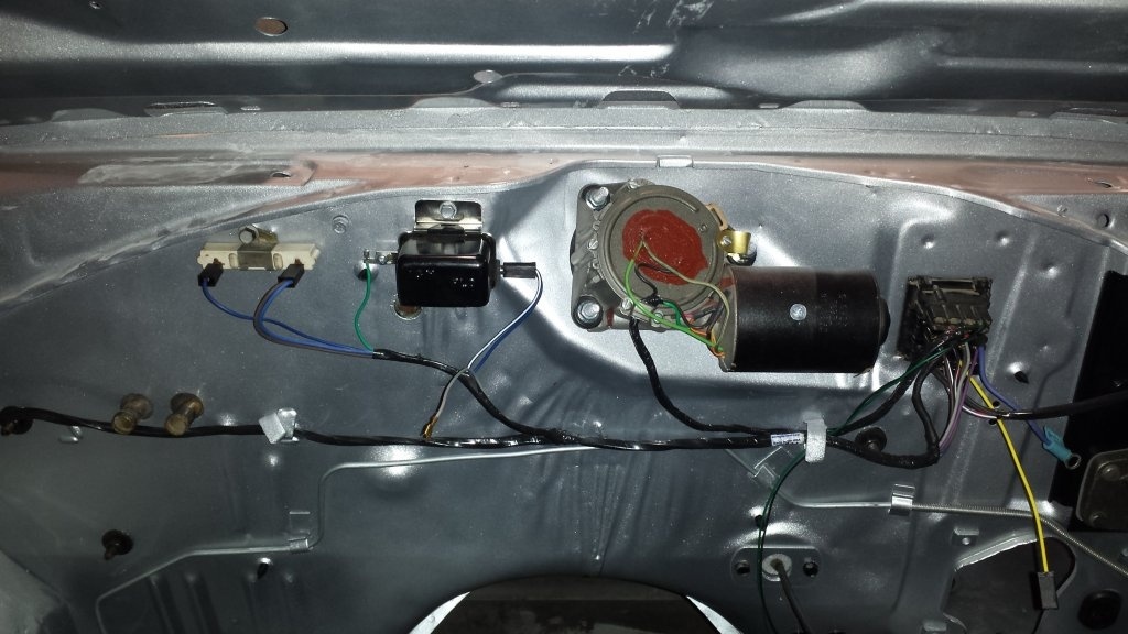

And I started hooking up wires. Ran the trunk light back and plugged in the connectors as I went along. Pretty easy. And with the bulkhead connector in, I ran the engine wiring too. The main power feed I ran straight through the bulkhead connector bypassing the Packard 56 connection. Everything seems to just fall in place. I'm tired!
