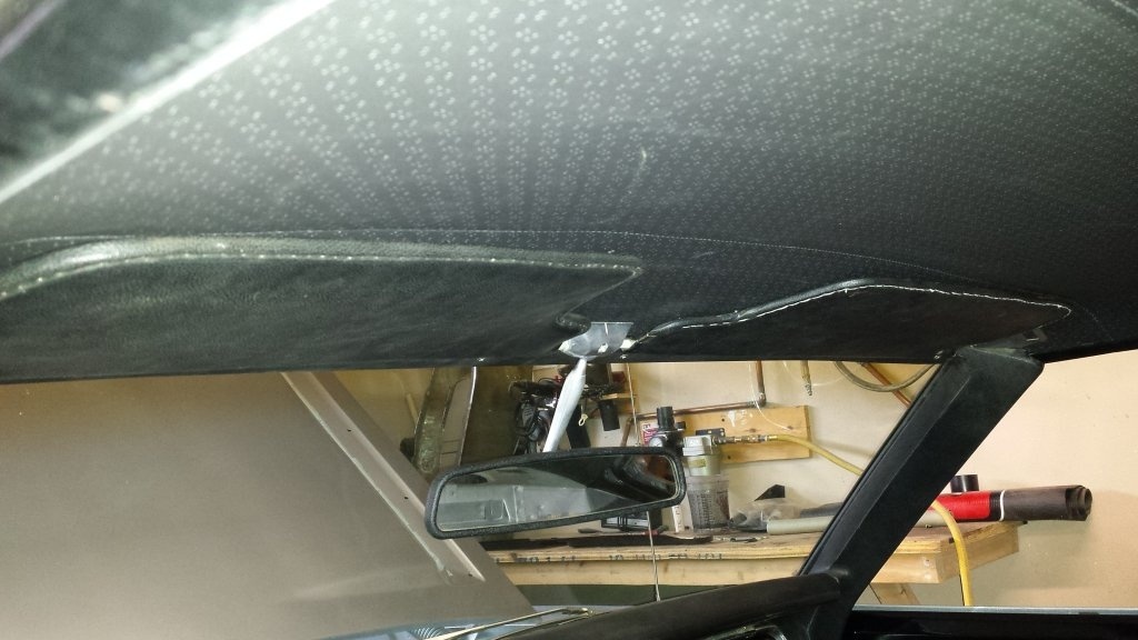

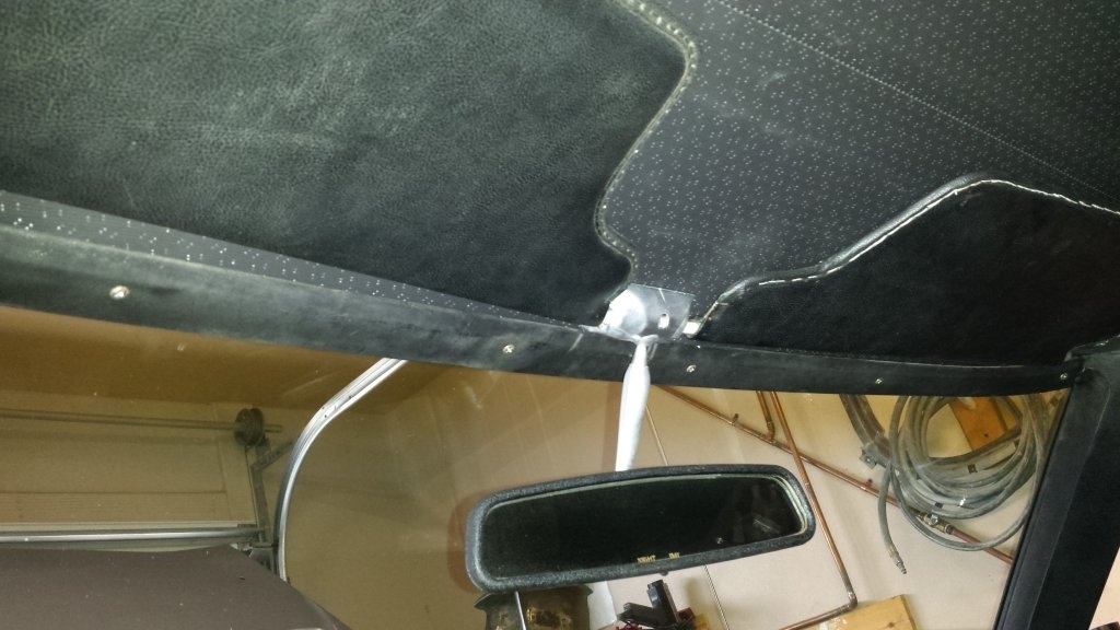

I got my A pillar mouldings installed. Driver side is missing a tab and I had to plastic weld the passenger side. Not bad shape and look good. New pieces are $177! so maybe in the future I will get new ones.
I also cleaned up the rear view mirror and installed it as well as the sun visors. The visors were in excellent shape except the stitching was pulled out. I got out my needle and thread and sewed them back up and put them in.
View attachment 393588 View attachment 393589
And a seamstress too! After you install my windshield I have some clothes you can sew up!
I hate taking photos of the interior ceiling, in real life it looks great but under flash photography it make it look washed out and amplified EVERY flaw no matter how small and insignificant!

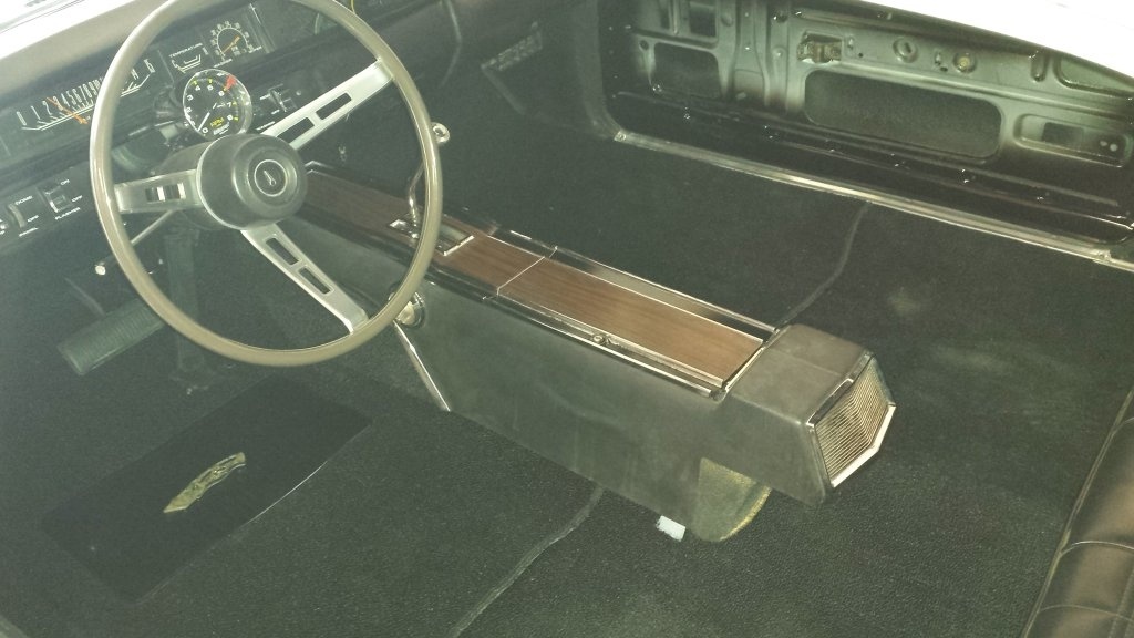

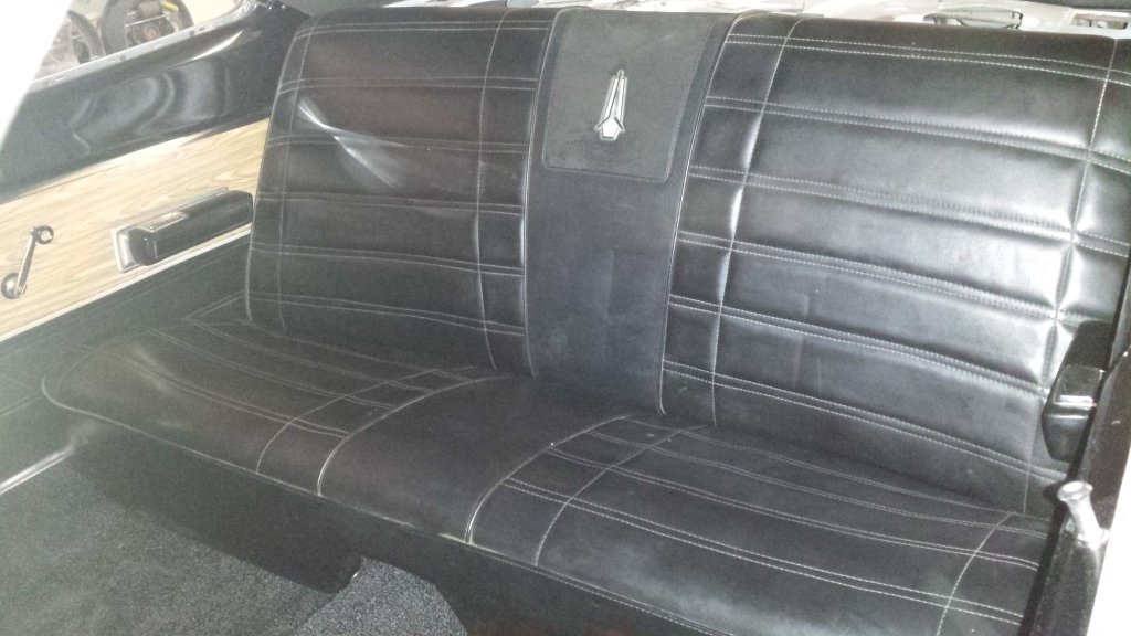

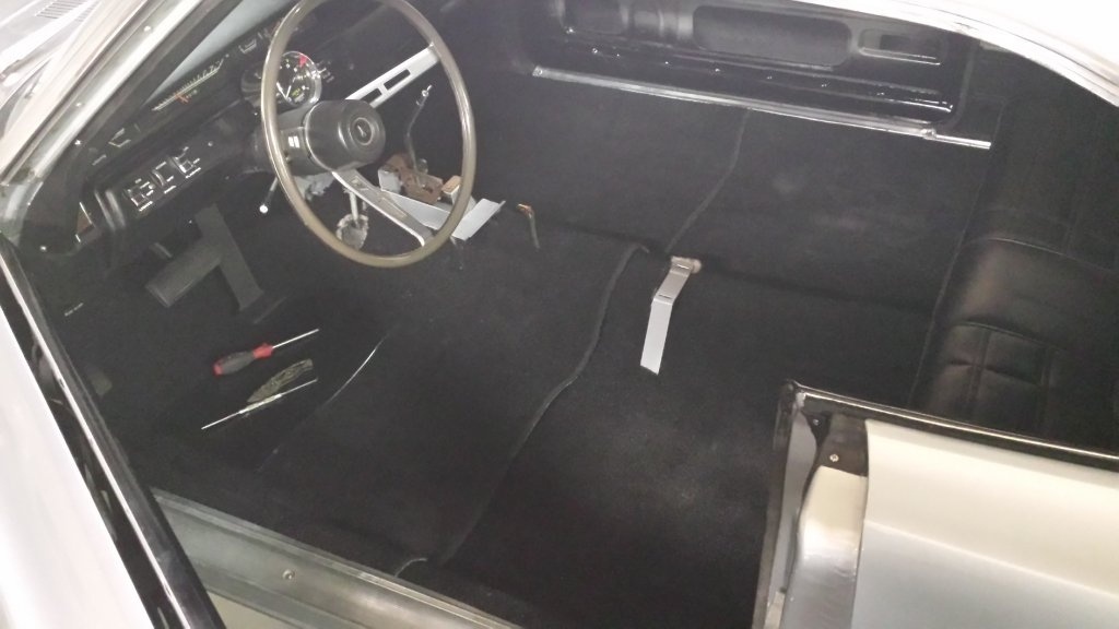

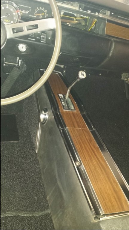

Received the carpet and got it installled. It is a pain in the butt with the console brackets but I think it turned out fine. Sill mouldings and kick panels are in good shape. Rear seats seem recovered but look good with the Plymouth emblem. I did have to weld the drivers ode attachment loop as the spot welds were busted. I should have the console in tomorrow.

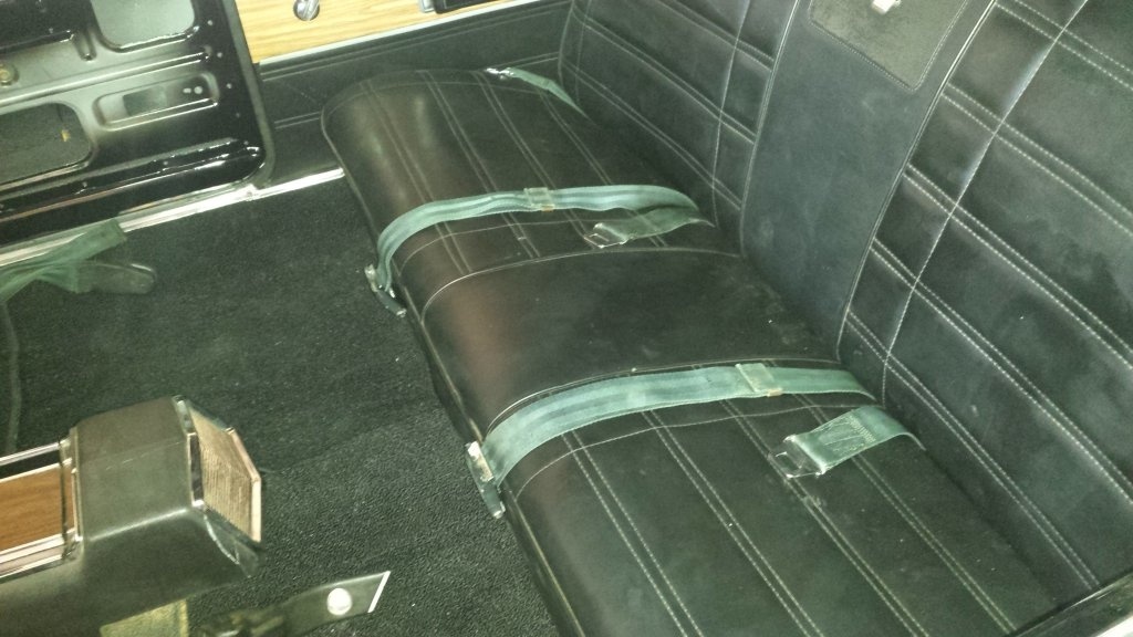

Got the old seat belts in. FYI, put the rear belts in before the seat back....which I didn't do. For the front I have my eye on a 3 point retracting belt with stock looking hardware. I need to get my seats in do I can get measurements for what I need. Mine has original hardware for 3 point but the uppers are missing.

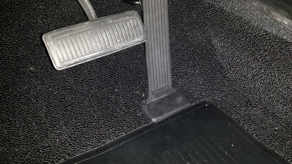

I also installed the gas pedal. I have seen them both in the mat and in front. Mine landed in front. Got it where I wanted and taped the footprint so I could see what to cut.
