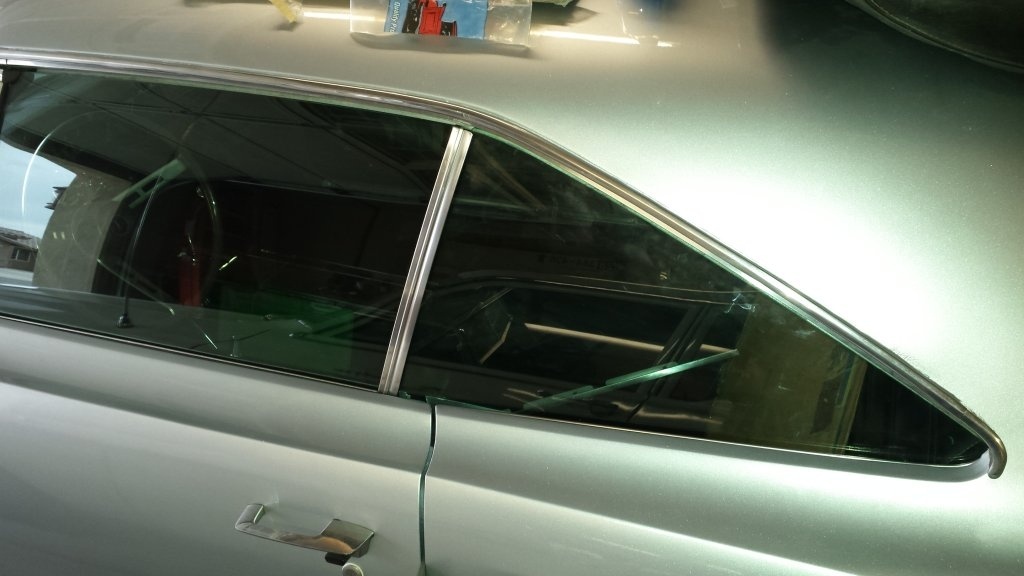

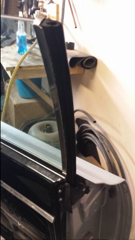

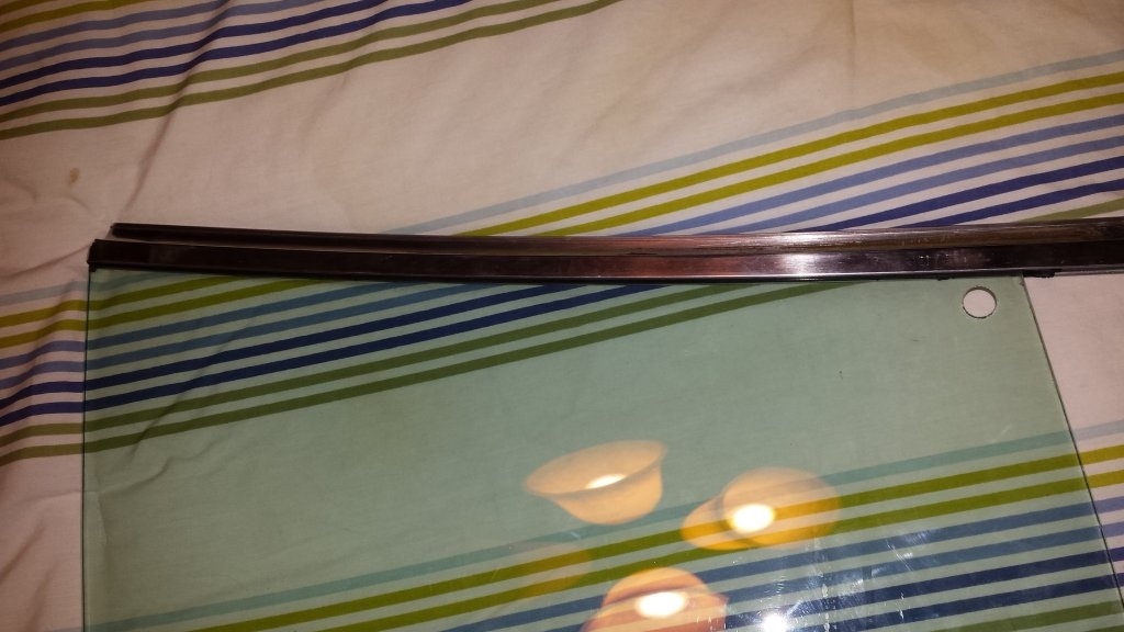

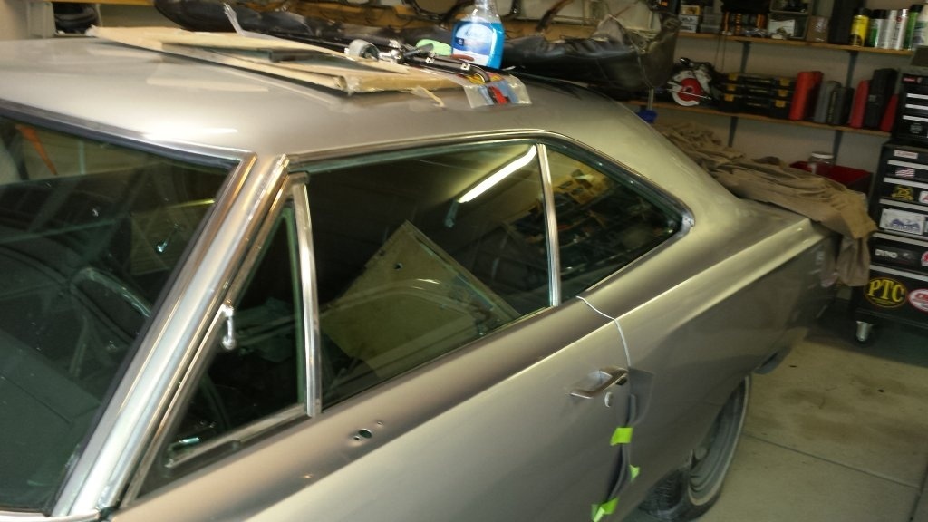

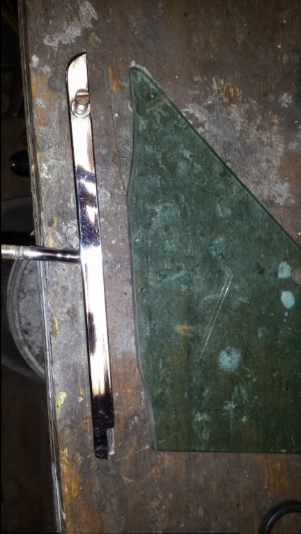

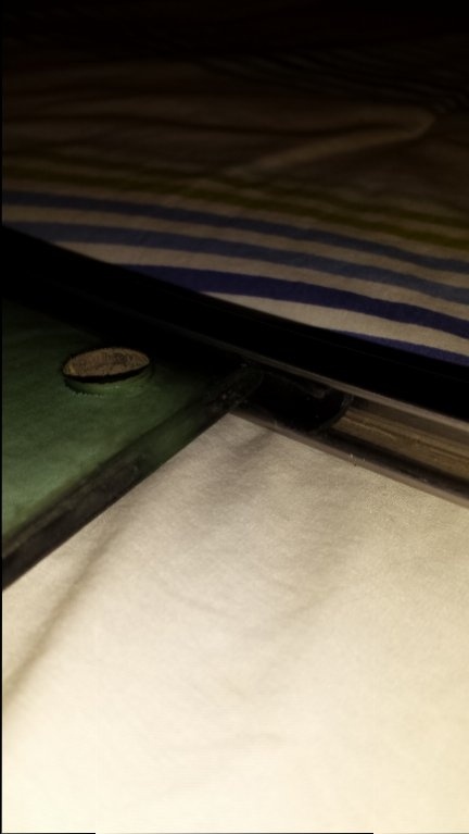

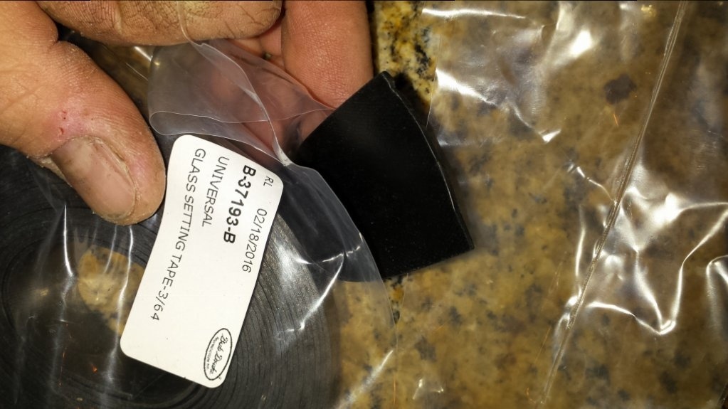

Messed around with my door windows earlier. The quarter window seal moulding and vent window are held in the groove with window setting tape. A couple pics to show it. Worst part is cleaning the old stuff out. I wrapped the tape around the glass edge and set it into the groove with some strong hits on the carpet. Trim the excess with a razor blade.

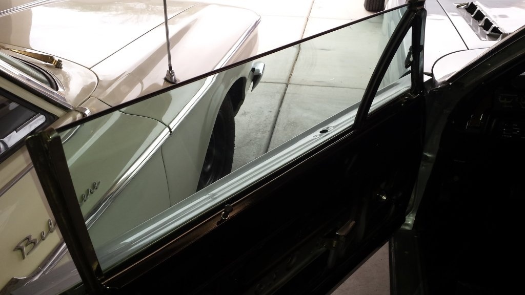

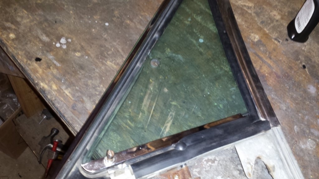

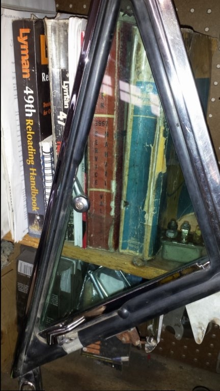

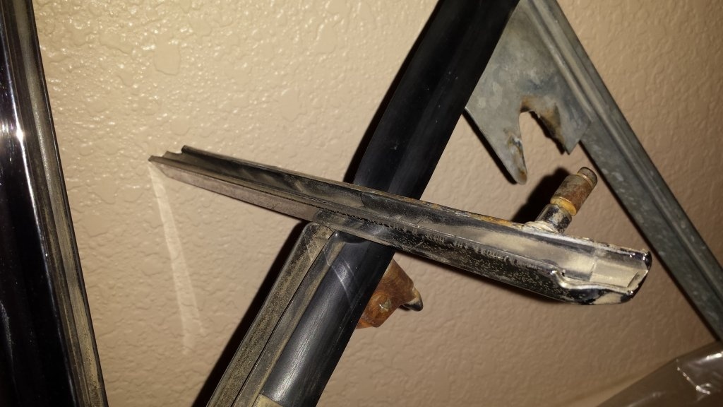

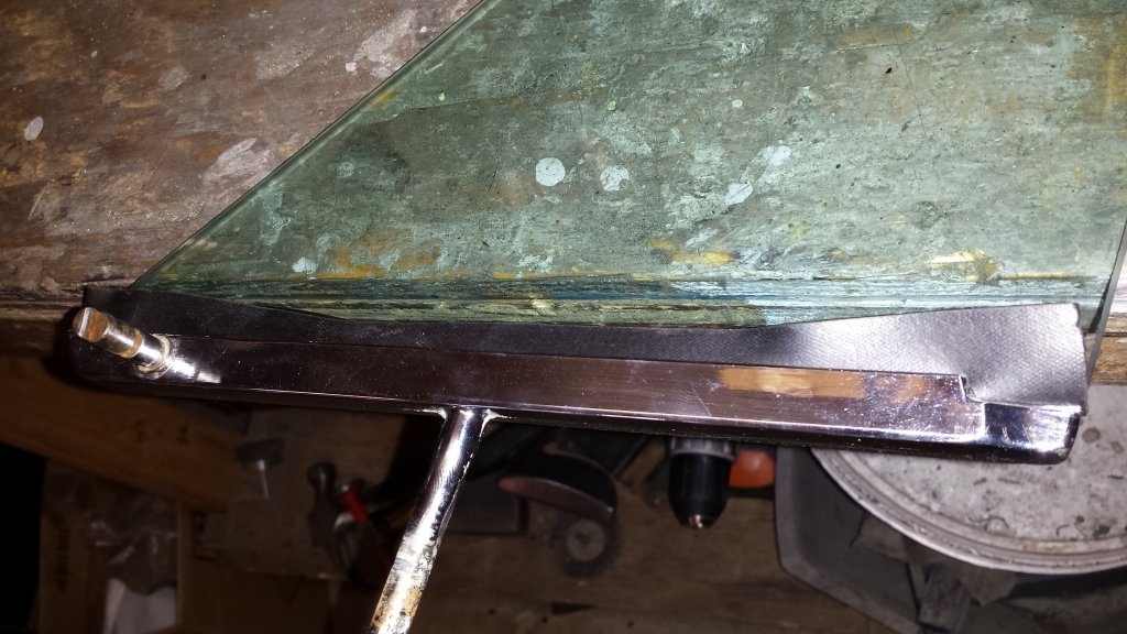

More tinkering. I needed to set the vent windows and clean up the hardware. I cannot remember how I got the frames out but it looks like they go into the door complete.

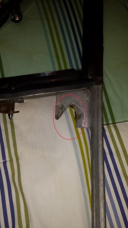

And this little guy...looks like it needs repaired. It is the same on L and R but suppose to be a u shaped notch?

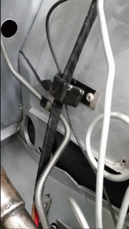

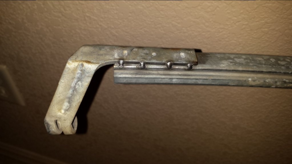

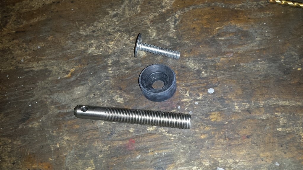

And here is the bottom frame adjuster that I repaired. Both were broke off...

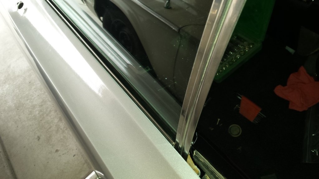

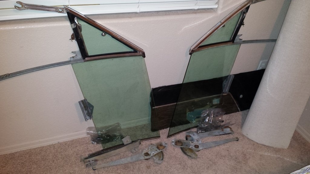

R and L window assemblies waiting patiently for installation....window felt cannot get here soon enough!
I'm about to start on my window mechanisms also.

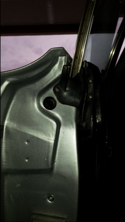

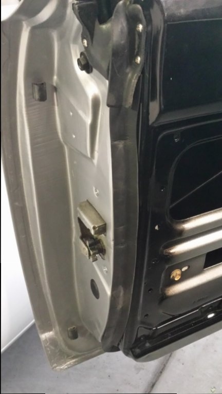

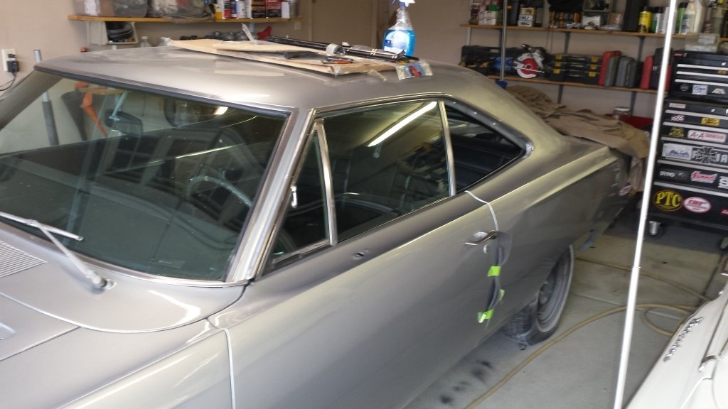

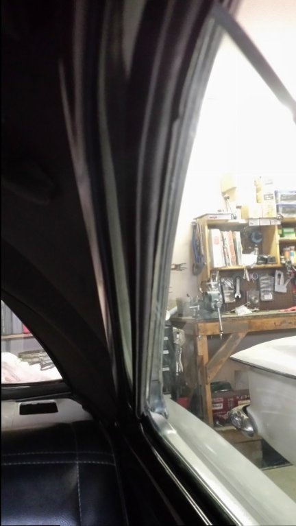

This car is going together easier than it came apart. I got my window felt in today so i started on the windows. The driver side door was messed up when I got it as the vent window frame was hitting the roof rail trim. No issues getting it back in and it aligns very well. On the front window track felt...I had to sand down the plastic guides as the entire thing was binding and flexing the frame. The new felt didn't help and was tight to begin with. The front and rear window align nice, just need to add my weatherstripping to be sure. If anyone wants a specific picture of an assembly let me know.

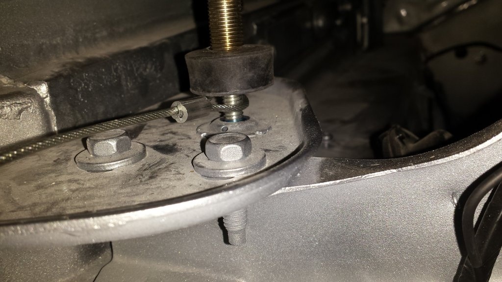

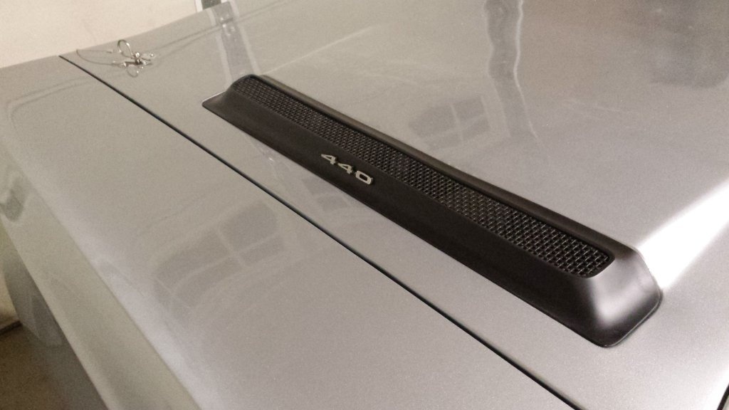

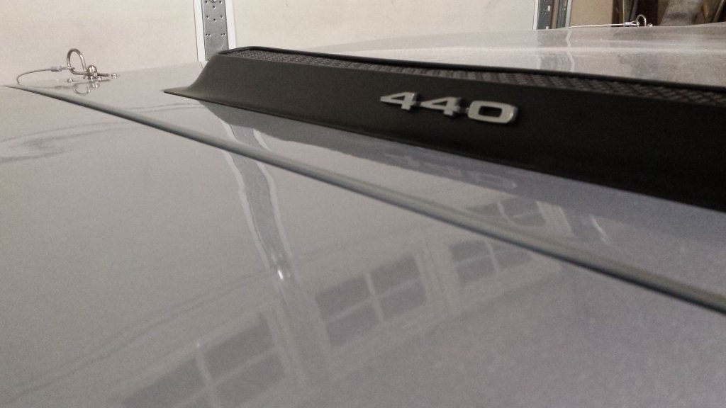

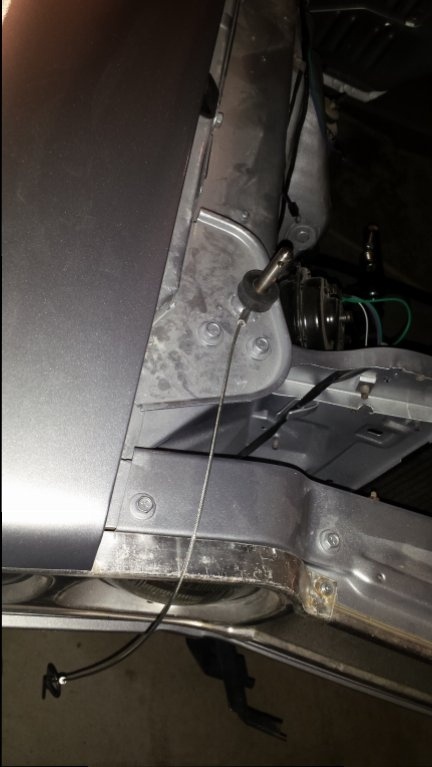

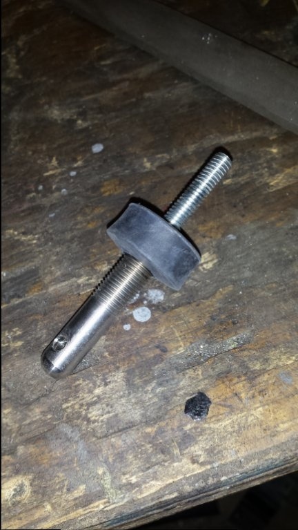

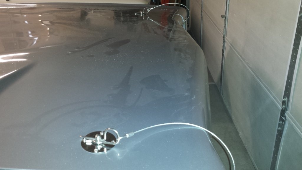

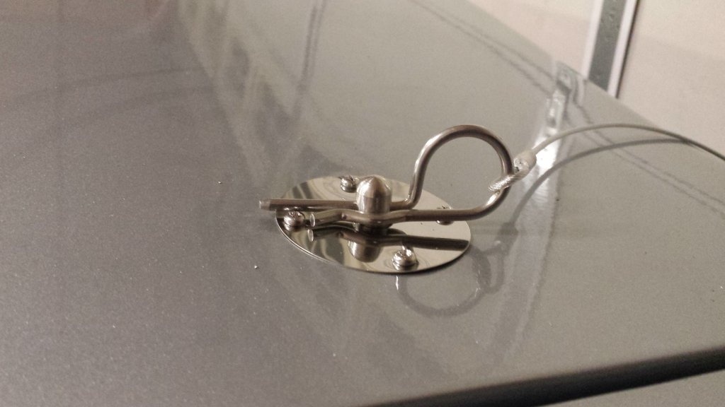

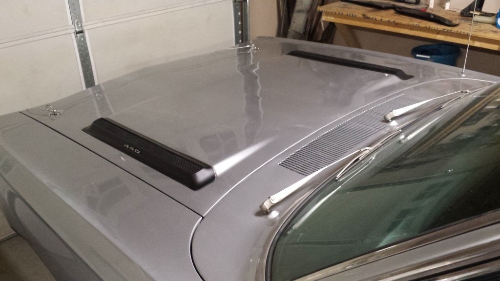

I got my hood pins installed. The hood had the holes centered over the hood bumpers so I left that as it was. It is not correct but better than patching a hood. To get them to work, I cut down the pin and welded it to the hood bumper post and re-used the bumper.
I always liked hood pins. Do the cables damage the paint over time?
So have I and the existing holes were my excuse. I would say they probably will if they are flapping around at speed. I need to see about making them a little shorter or I may just get a clear vinyl to put on the leading edge of the hood.

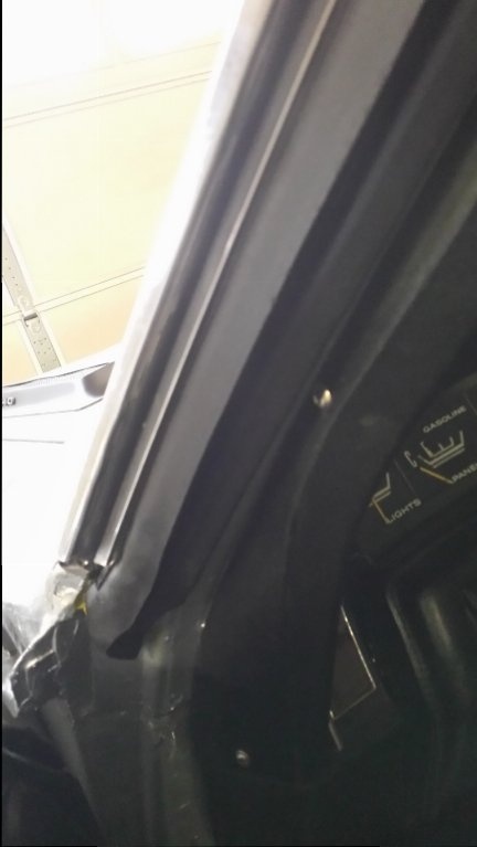

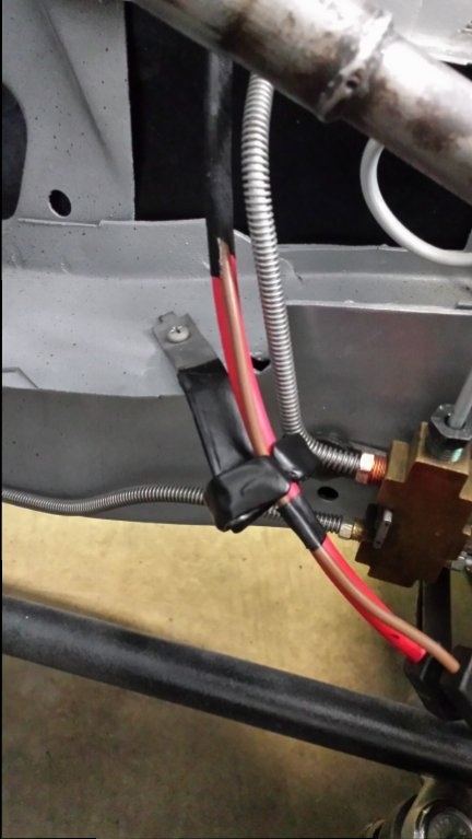

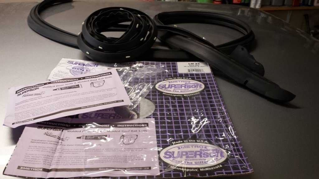

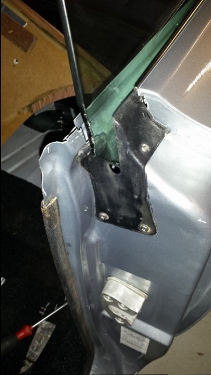

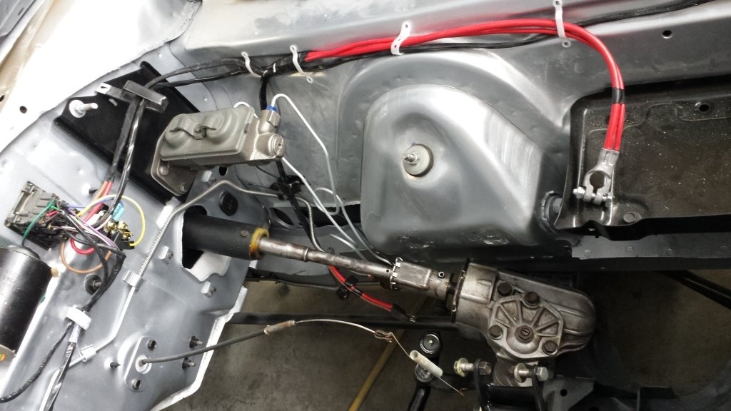

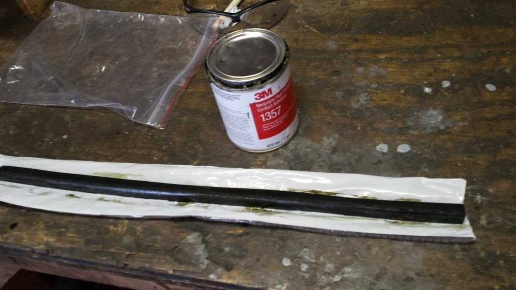

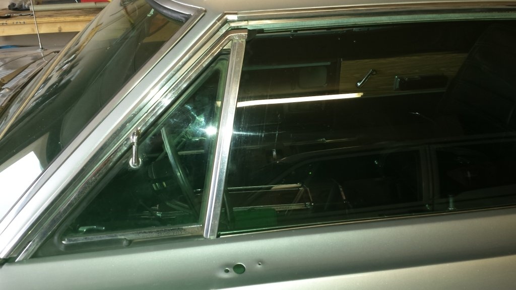

Received the positive battery cable harness and quarter window seals. Kind of a pain to get installed as the short side gets tucked under the trim and is glued so it gets too sticky to tuck. I think it came out fine and mates well with yhe front windows.

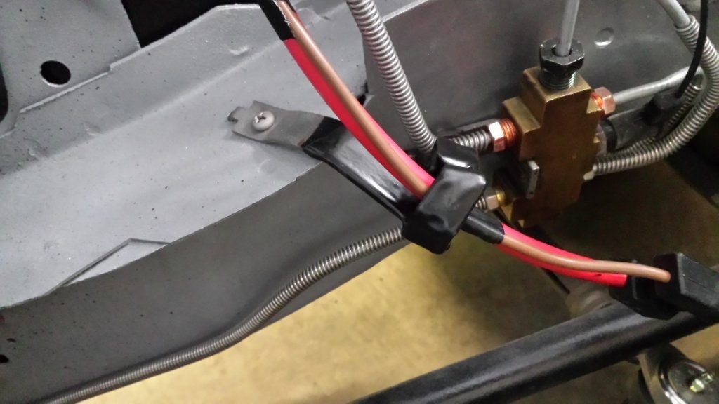

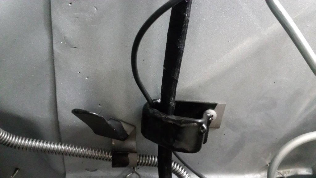

While it's easy to get to, could I get a close up picture of the 2 lower battery cable metal clamps. Thanks
And I finally received my weatherstripping from Metro. It is some nice and soft stuff. Driver side fit like a glove, quarter window is tight near the top of travel but I suspect it will break in. Roof rail tucked right in like it owned the place. On the front of the roof rail w.s., I used adhesive over the windshield moulding hold down.
