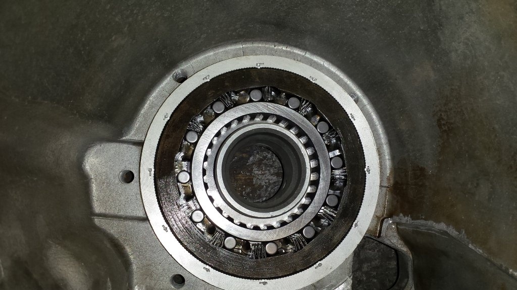

Finally got time to start breaking the trans down. I am leaving the overrun clutch outer race in the case and replacing the guts. Everything looks great except the underside of the stator housing, cannot tell if it was a machining flaw or trash. Two swipes in the end of the channel. Pump looks fine. Bushings all look great too. Plus 4 friction front and rear with 4 pinion planetaries.

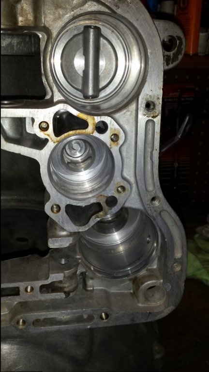

Putting the new servos and accumulator back in. The accumulator is a funny beast and comes in several variations of which are all correct. Some have top spring only, some have bottom spring only. Some have top and bottom spring whereas others have no springs. Thanks Mopar! Mine had no springs and a factory tube installed to keep it from moving up or down in the bore so i re-installed as is. The billet servos are plug and play. I contacted the manufacturer and he said to use the spring he provided as opposed to the spring provided in the TF-2 kit. My assembly lube is good old petroleum jelly.

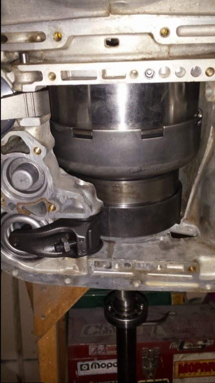

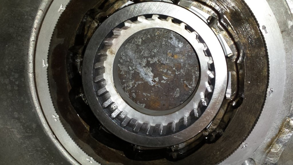

Moved on and installed the tail shaft support. 4 bolts hold this on and if you use a bolt-in sprag the same bolt holes are used to bolt it in. I just replaced the rollers and springs on mine and re-staked the outer ring to make sure it stays tight. Put the rollers in first then add the springs between the rollers and tabs. Once this is done and before the rear planetary set is installed don't bang the case around otherwise these will fall out.

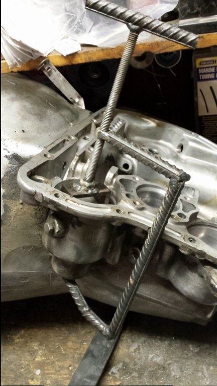

Got the planetaries in, front/rear drums packs. Replaced 2 of the thrust washers, difference is +.002" overall. Still waiting on my governor from A&A (love their stuff but it seems they still ship stagecoach lol). And waiting on my solid kickdown band so I am at a standstill. I will clean up the tailhousing and rebush the yoke support but yhat is about it. Oh. How do you like my transmission holder?lol This trans had an inspection hole up top that was meant for hanging.

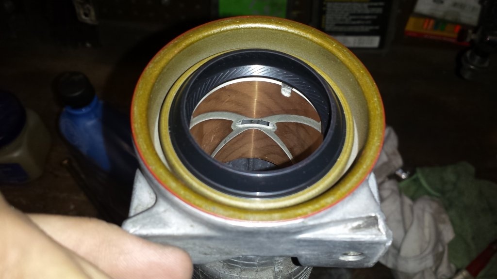

Tailshaft cleaned up, new bushing and rear seal installed. Permatex also used on the mating surface of the rear seal.
