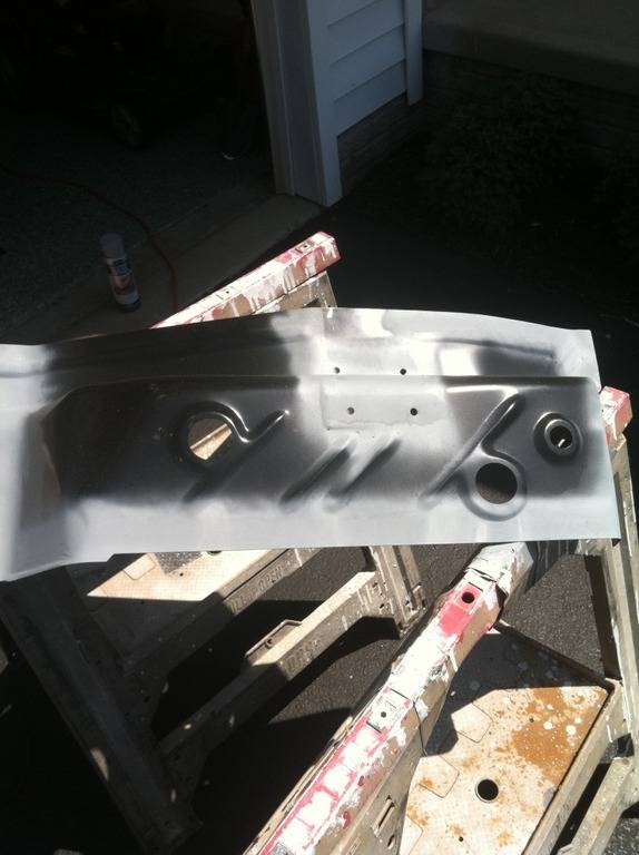

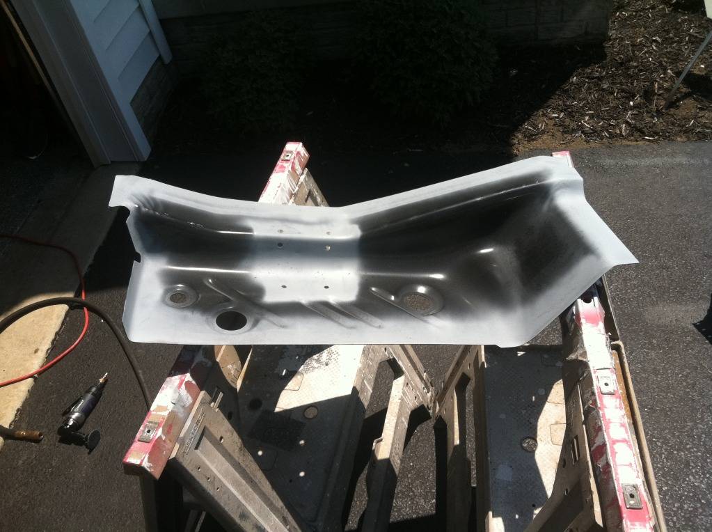

I started to prepare the rear passenger side footwell.
Then, it was time to finally weld in my first piece of sheet metal. That's when all hell broke lose.

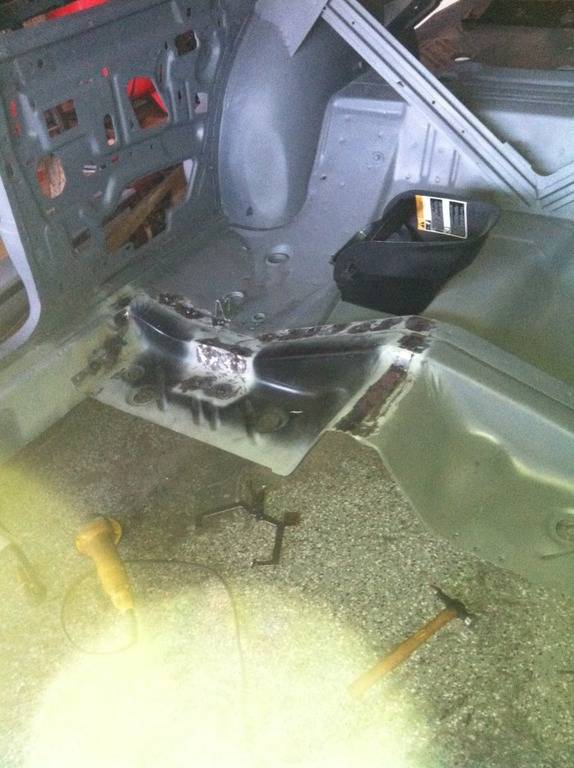

I get the pan in position after tweaking it a bit. Clamped in place, ear plugs in and welding helmet on. (ie: I can't hear or see ****) I run thru all 18-20 plug welds...bouncing back and forth from side to side as to not warp it. Take off my helmet...and something didn't look right. The welds didn't look anything like I practiced....they weren't bonding and were popping once I removed the grips. I couldn't figure it out...blamed it on the weld-thru primer from Eastwood. They say it's some sort of organic blend...I don't know. But, I couldn't weld thru it...it sent splatter everywhere. ok...grind it all down and try again...same results. Frustrated, I get out of my car and that's when I see it....my argon tank on the ground...regulator busted and an empty tank. About $60 worth gone. I guess at some point, I pulled the torch knocking it over...I obviously don't remember doing that, but I couldn't see or hear anything. It was just a flux core welder at that point and I didn't realize it. I litteraly was able to pull the pan off with no pressure...the dang thing nearly fell off. Instead of rolling the car into the yard and setting it on fire, I ended up walking away for 2 days. Friday and Saturday sent me to the store for more gas and another regulator.
Yesterday, I decided to try it again. This time with no primer. I'm not sure what the initial problem was...the primer or the lack of gas, maybe a combination of both?
But, after cleaning everything up, it's firmly in place now. I sure hope I got the measurments correct. Again, I had no help to put the full floor pan in for an accurate alignment of the back pan, so I just took a bunch of measurments for the alignment and did the best I could. Maybe I should have waited until I had help, but I was bored yesterday and wanted to do something.
Looks like it turned out good in the end Capt. Main issue....no shielding gas. The welds would have been full of porosity and have been a royal pain in the rear to puddle in with no shielding from the elements.
As far as the Eastwood primer....couldn't tell you how great/poor it is...never used it. I use the SEM zinc weld-thru primer without issues. Some folks use the copper. Eastwood makes some good stuff/some bad. When it comes down to using primers, sealers, paints ect...ect.. Your almost always better off using the higher end proffessional stuff made by 3M, PPG, SEM, Evercoat..ect...ect. You truely do get what you pay for. Not to say cheaper/off brand products can't perform, cause some of them most definitely do, but sticking with the proffessional series takes a lot of doubt out of it if you don't have time or want the unknown of dealing with a off the wall product.
