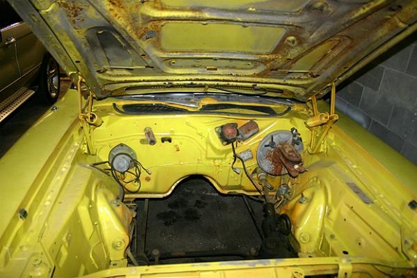

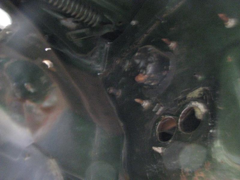

Does anyone know what these holes in the firewall are for? I fond this pic on the internet what appears to be a 72 with similar holes. AC maybe? Is there a correct blockoff plate for them? Thanks
Nice car! My 73RR only has one hole, the one closest to the motor, and its for the heater box drain, so that may have been modified. You said in your original post you were keeping it original, but have a 440 for it? Are you going to upgrade or keep the original 340?

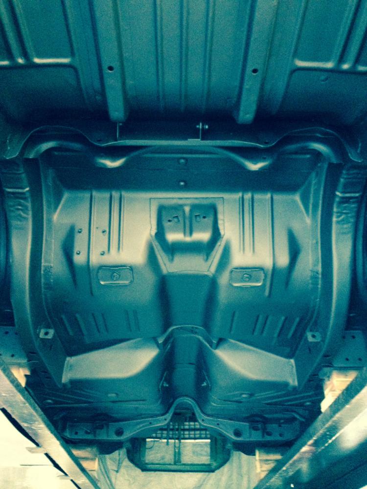

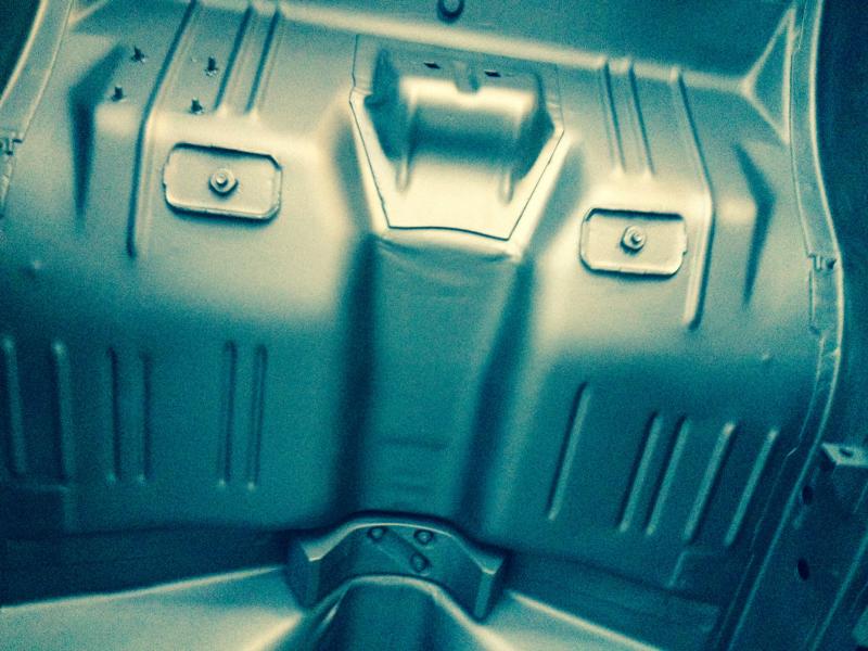

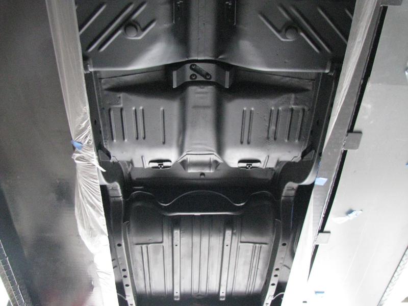

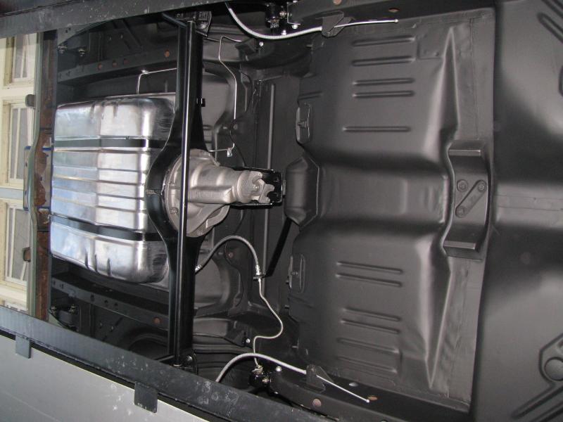

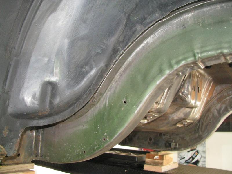

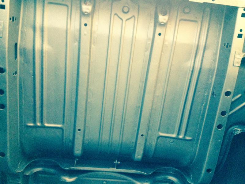

Started cleaning underside of RR over weekend and happy to find only surface rust. Does anyone know if Canadian cars were factory under coated? Its coming off in sheets in places so I think I can successfully remove all undercoating. I would like to stay factory correct on underside but don't want to have any undercoating. I removed the gas tank and it seems everything was sprayed a flat or semi gloss black first then undercoating wherever they could hit. I'm assuming in 73 they stopped body color on the underbody, can anyone confirm that, or is each car and factory different in treating underbody. I would be happy with a clean black underbody when done. Can anyone suggest what flavor of gloss would be close to factory? I'm thinking matte or satin. Also could use suggestions for other underbody finishes like springs, rear, center section, k-frame etc. Thanks.

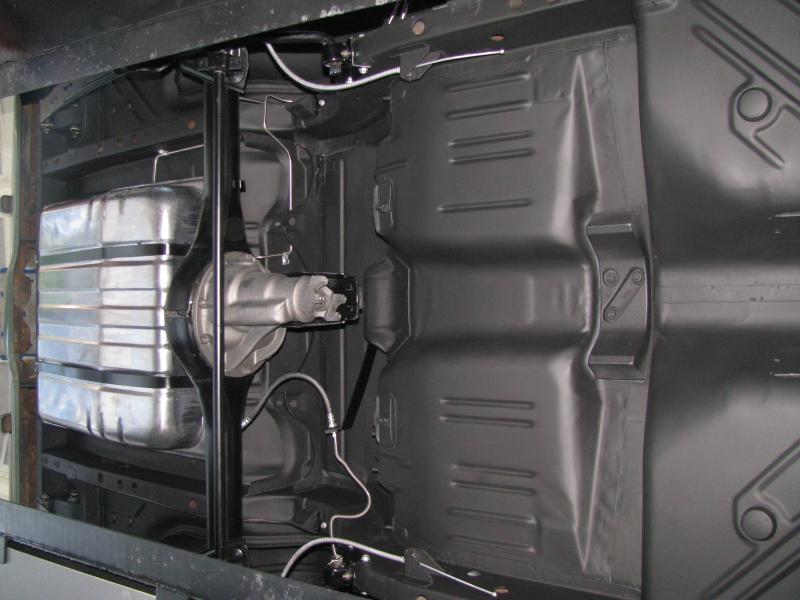

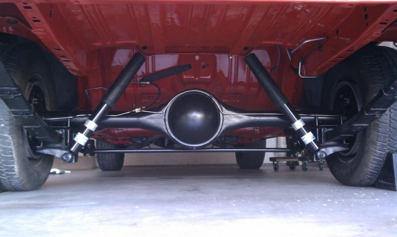

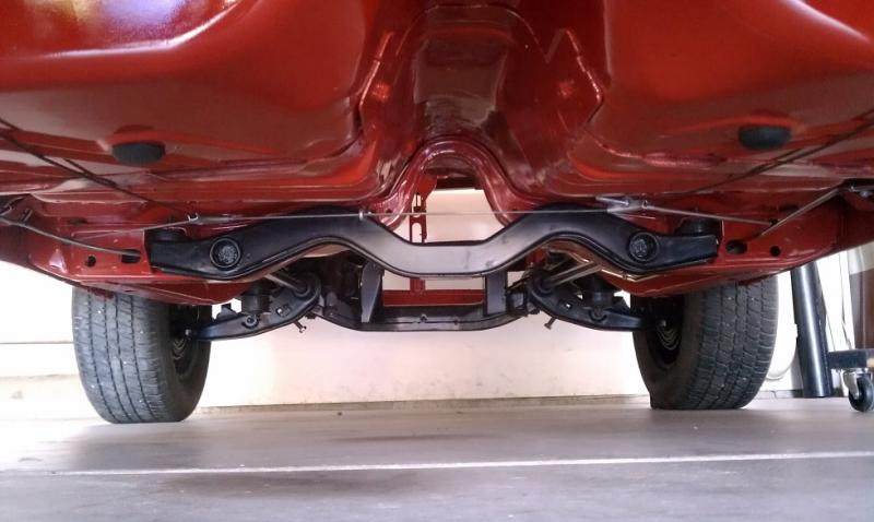

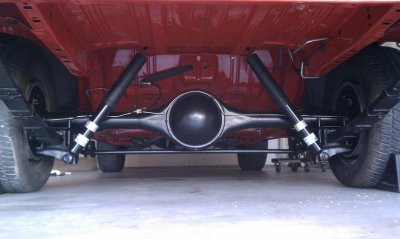

My 73 RR was body color on the underside, of course, it was covered with undercoating as well, but when I rebuilt it, I didn't put the under coating back. Regarding the finishes on the other parts you mention, those were usually painted black, but I went ahead and powder coated everything.

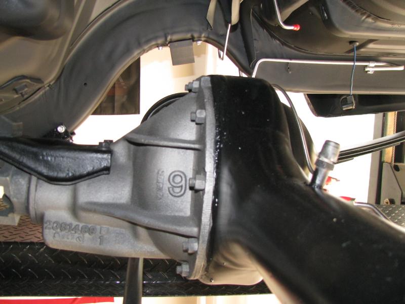

Here are a couple of views before she was all put back together just to give you an idea of what it looks like.
X 2, That is a beauty, color combo and straight as an arrow!

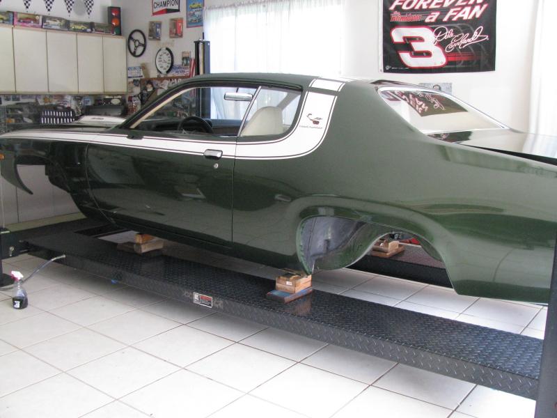

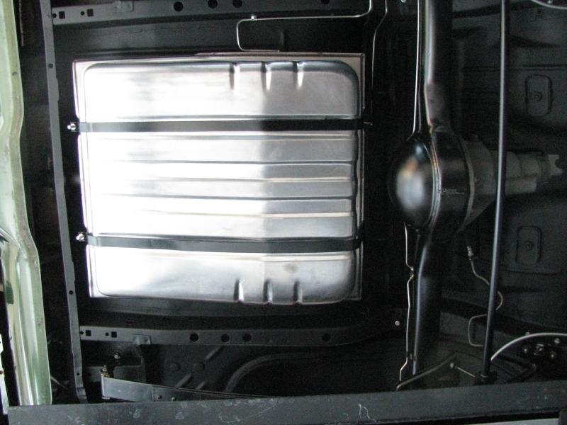

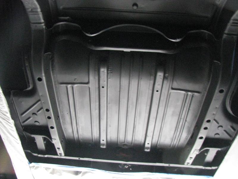

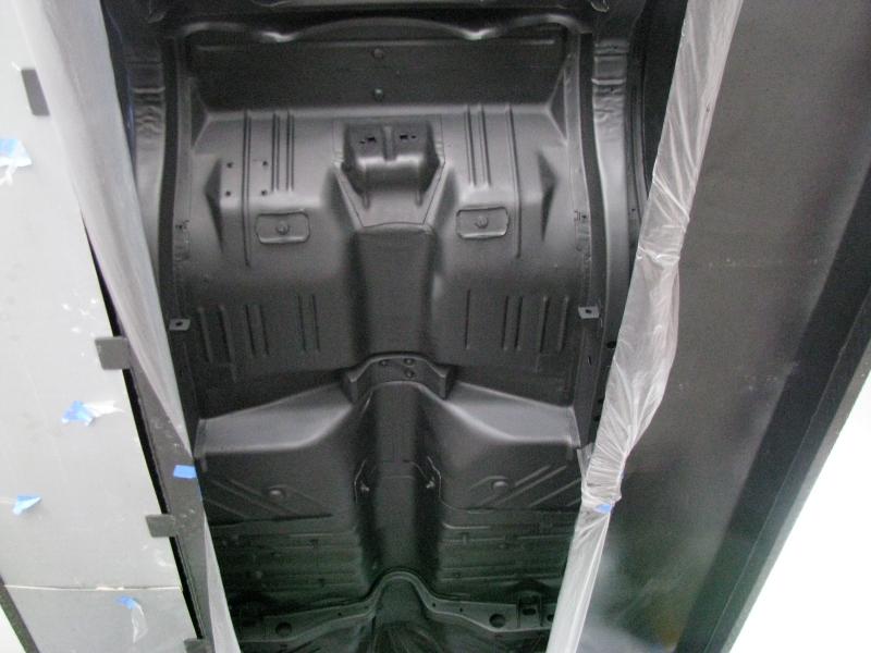

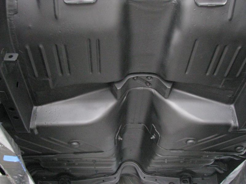

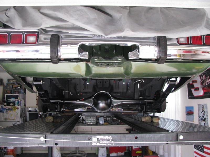

Final coat, just the right sheen, very happy with finish.
That looks super man! These old cars are so hard to make look like that and it really takes a lot of time and work, I do hope and im sure my next car im doing will look good, It is fun to do even though its a lot of work and this is what i have to look forward to afterwards, I hope the rest of this gos as well as your doing now bud, i really like the style of the 73-74 RR'S!!! She looks smooth and purdy... :)

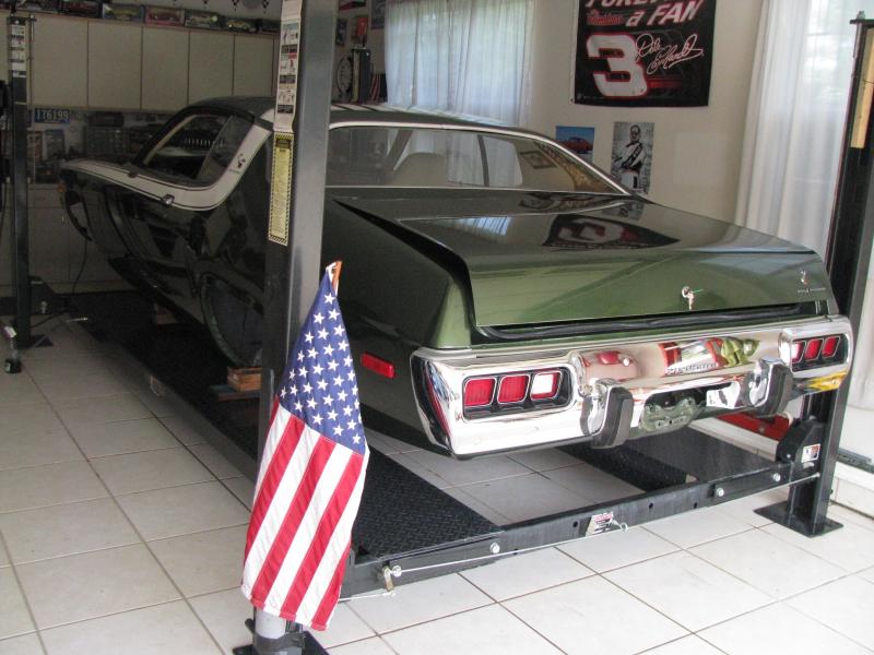

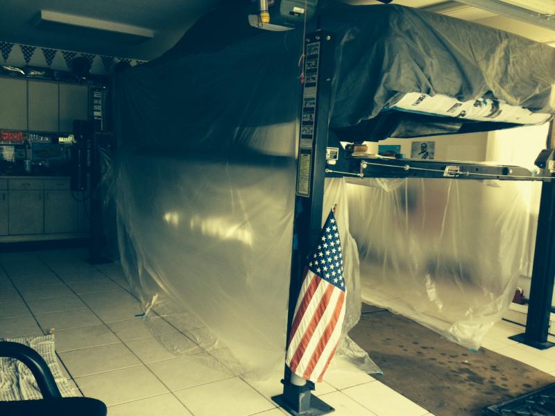

Thanks, I'm glad someone feels my pain. I was doing my impression of a Dexter kill room in my garage trying to keep dust and overspray from getting all over everything. Could only spray 2 or 3 cans at a time before fumes got bad, even with respirator. Must have gone through about 14 or more but got nice coverage. Thank god for my lift. Garage back to normal and mopped clean. Looking forward to clean work and putting it together.
You have great car. I love that body style. Your doing a great job. I wish I could find a project as nice as that. Your shop looks like a good place to work on it in. I do everything in a uninsulated barn but it does have a concrete floor. Keep up the good work.

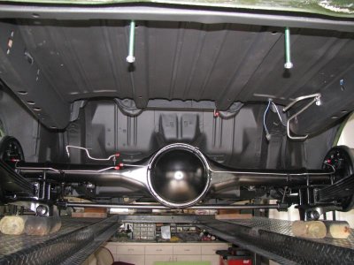

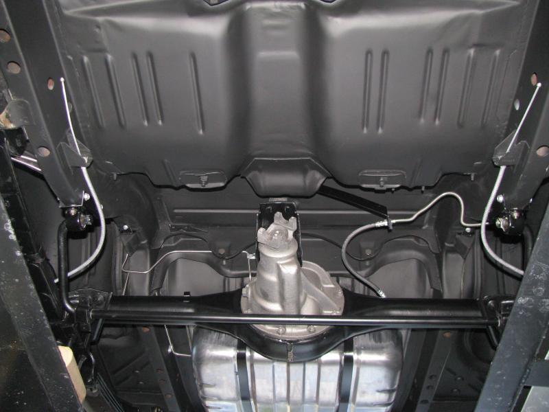

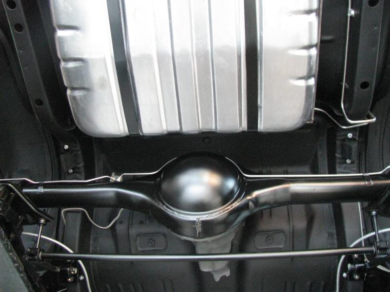

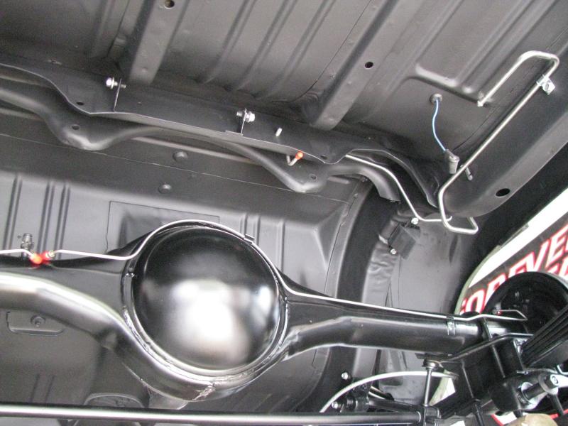

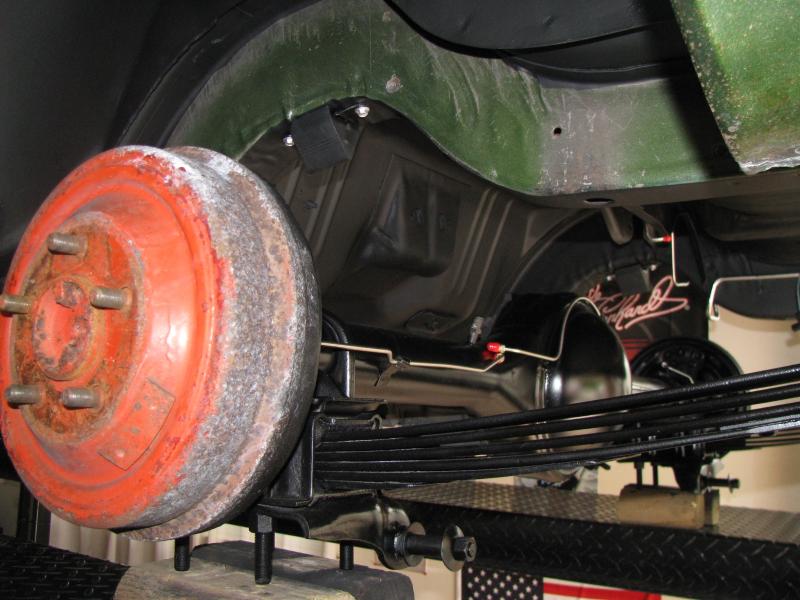

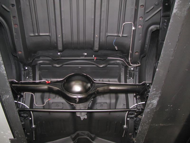

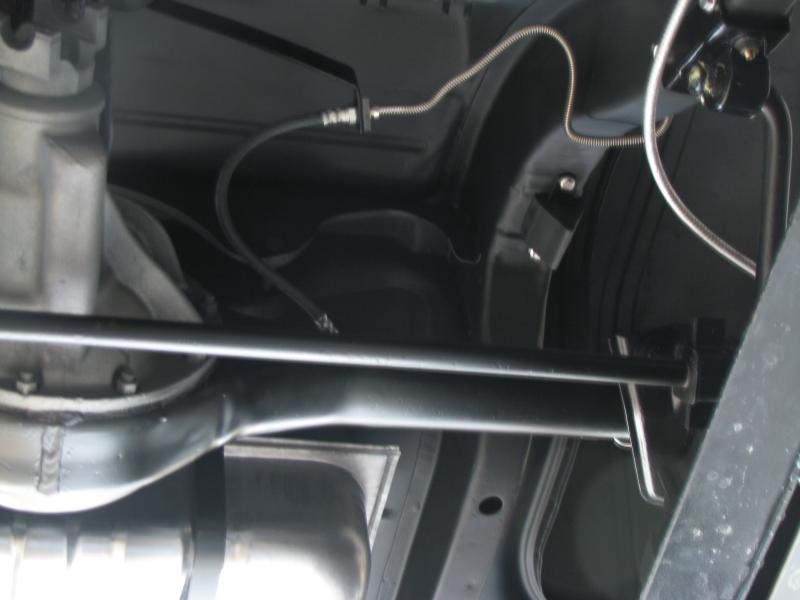

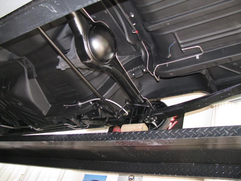

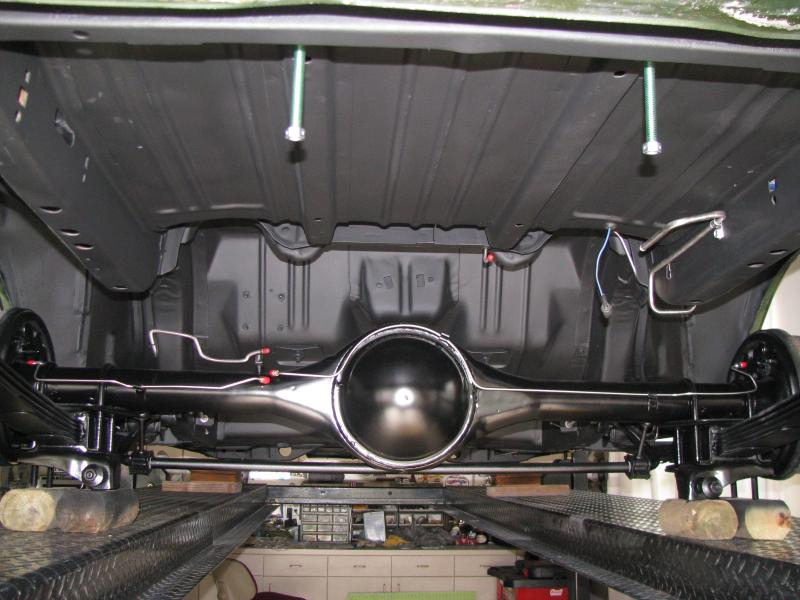

Got the rear end and springs sandblasted, primed, painted and reinstalled under the bird. New stainless lines everywhere. Starting to look like a car under there again. Anyone ever see orange paint sprayed on rear brake drums like that? Was wondering if that could be factory applied as a "high performance" feature. I would like to recreate it if it is.rear_7.jpgrear_1.jpgrear_2.jpgrear_3.jpgrear_4.jpgrear_5.jpgrear_6.jpg
These pictures will make a blind man drool man... I cant answer your question but more then likely someone wanted to dress the ole gal up, which it sure looks like your doing! I hope im wrong and your on to something though, really looks sweet !!!
hi,the canadians cars were factory undercoat but was optional,90% of the news cars was ordered with undercoat by the dealer,it was a must to resist to the winter and snow and salt on the street
