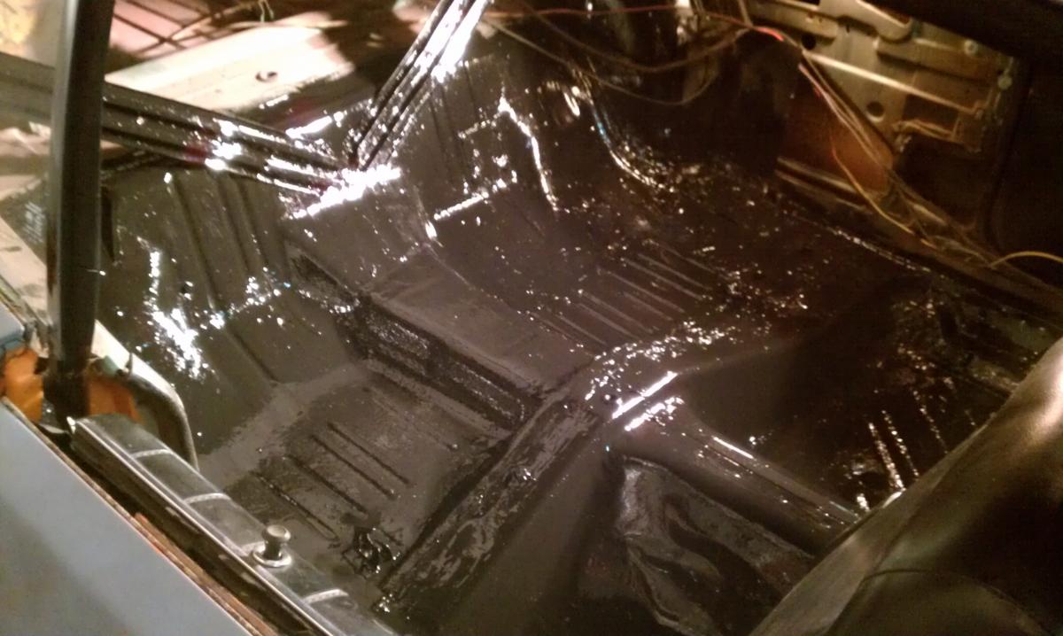

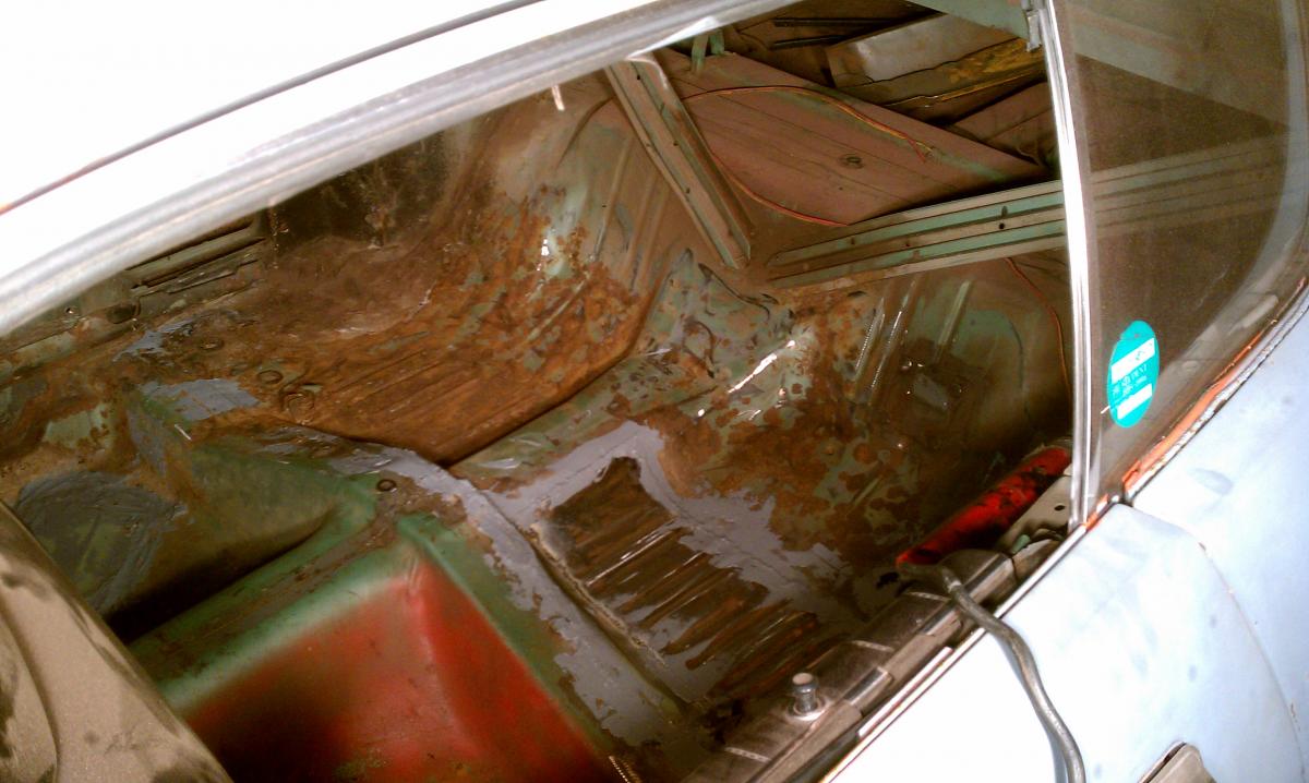

POr15 ed the rear floors before power outage last week.....

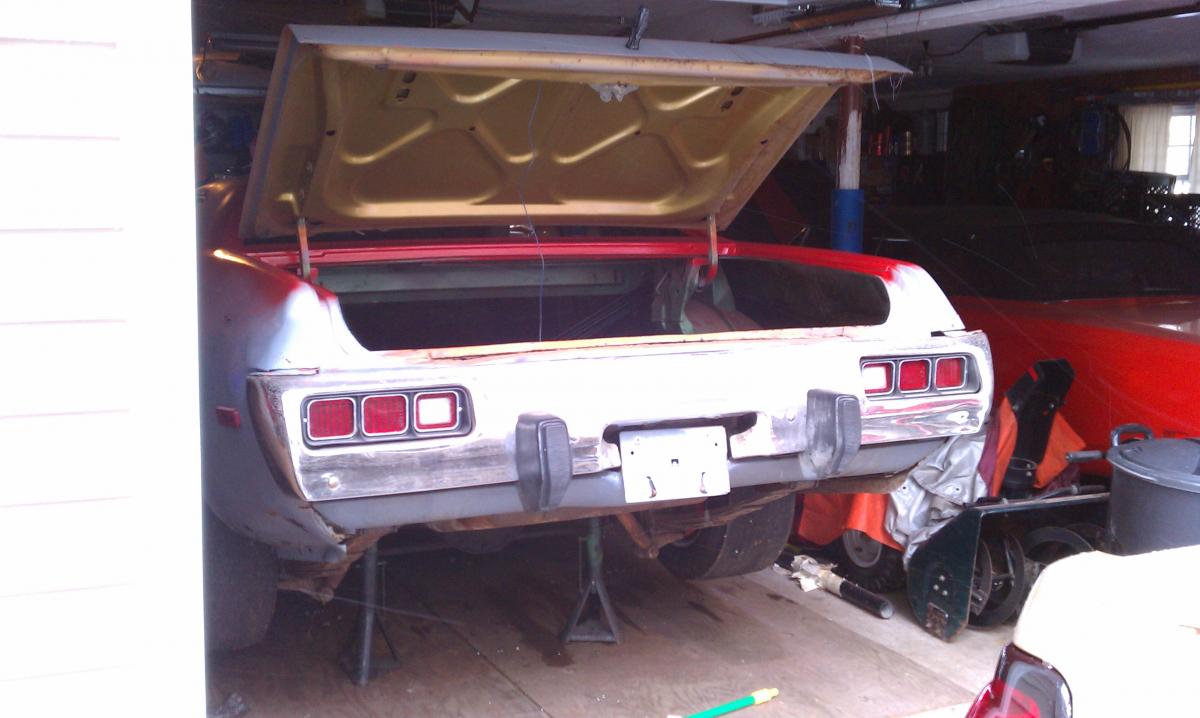

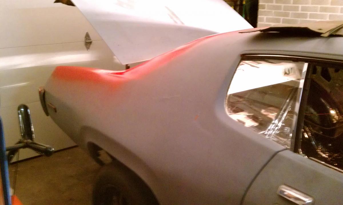

More update photos later, but i was able to get back to worj. I cut the rear qtr extensions out and stared prepping the wheel houses and trunk floors. Once i fab the extensions ill POR the whole trunk floor and was thinking about doing the whole trunk in Red Durabak Bedliner.

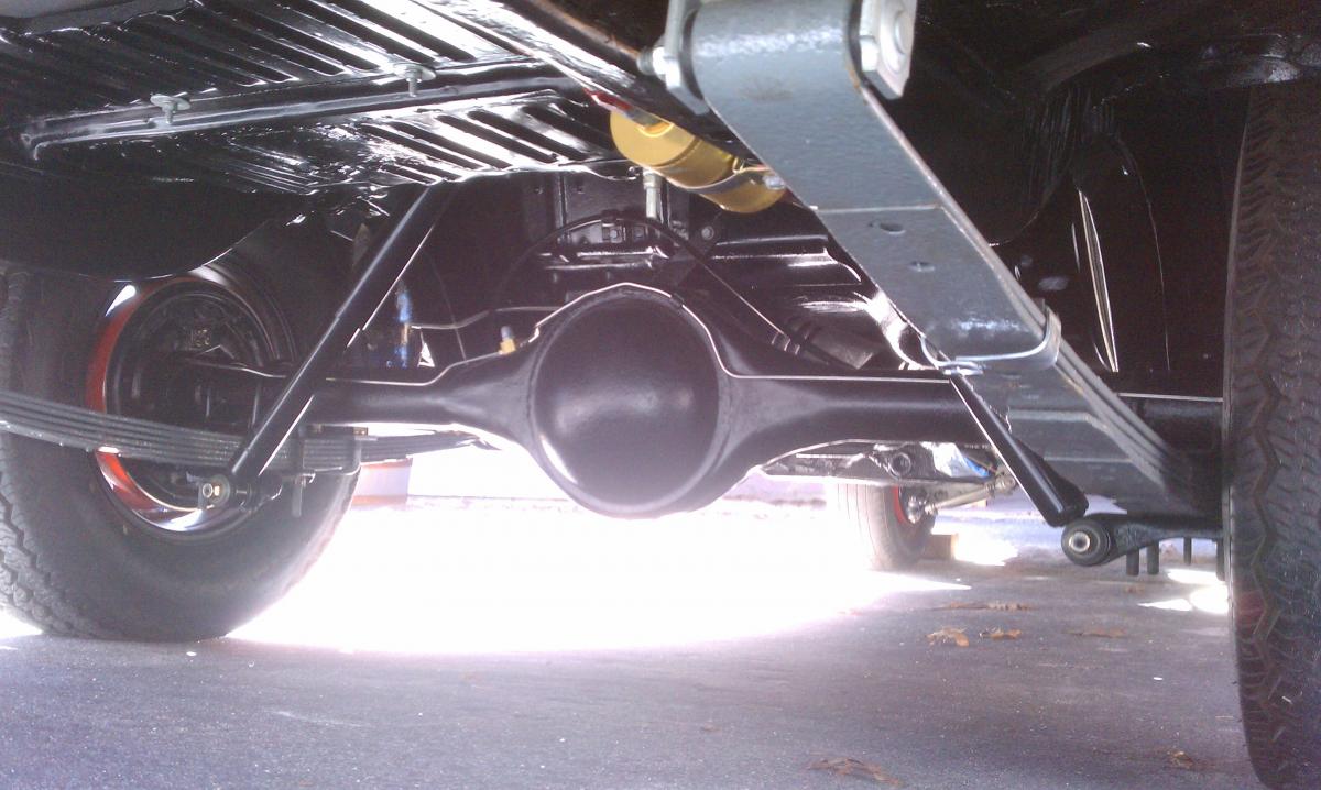

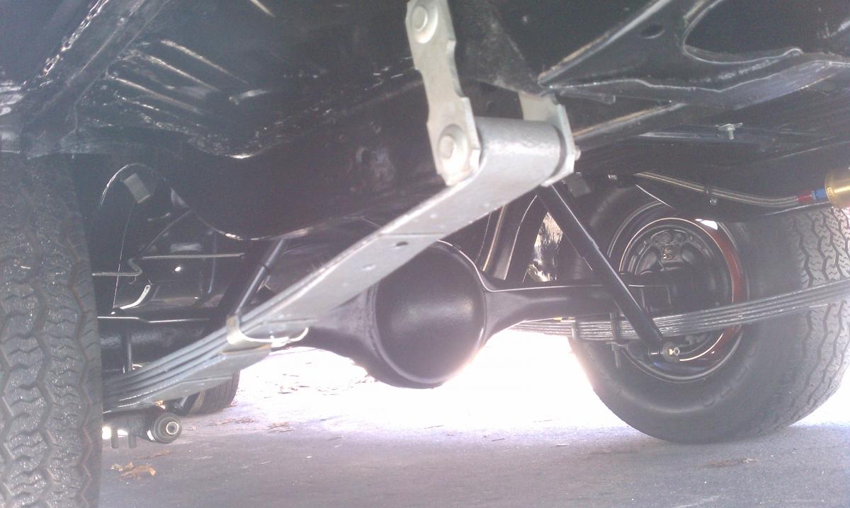

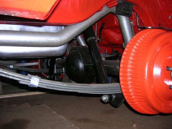

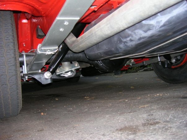

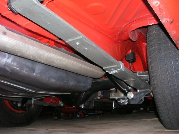

Example of what ive done on jackstands..... 68 Fury III

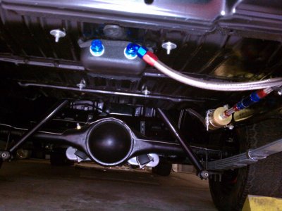

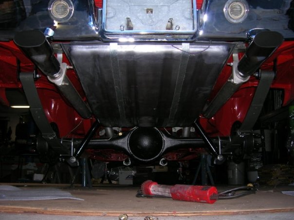

Couple of under my 69RR jackstand resto....
